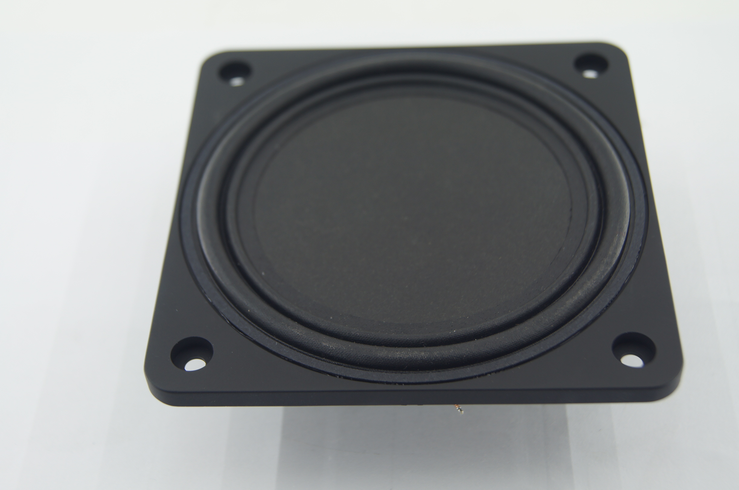

Check out the new BMR from Tectonics. It has a rather smooth response and will be included in the round 5 lineup for Subjective Blind test.
Thanks xrk, I'll look out for the thread
Size matters....!
The little Tectonic BMR is good for small speakers / TV's / portables etc but it's tiny Sd severely limits its SPL and dynamics.
It might be classed as a 3 inch driver, but its Sd is only 19 square cm.
Compare this to the CS 4.5 inch rubber surround BMR which has an Sd over 3 times this, 60cm square from memory.
My silk surround 4.5 inch driver has an Sd of 70cm square.
If you are seeking anything more than background levels you will need to cross the Tectonic BMR over around 800Hz to 1,000Hz to a good bass / mid.
It does have an excellent power response, way better than any comparable cone or dome and this "room filling" sound does help compensate for its other limitations.
Overall its a great value driver and it will be interesting to hear your panels thoughts on how it compares to the other drivers.
