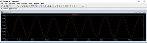

Even in its non optimal balanced form it can still reject common mode signals significantly. Another simulation.
Here we have the standard set up with balanced inputs having 180 degree phase shift as intended. I've also added a 600 ohm to the source impedance.
Now we reverse that phase shift and we get no output. Vin1 and Vin2 are superimposed on each other.
This is a close up of the output... not so much.
Now we add a 10 volts (yes 10 volts) 50Hz signal to both inputs. The output is essentially clean.

Its interesting to see it work in simulation and although the output looks clean, if you look at an FFT of the signal you can see the 50 Hz component. This is where the CMRR trim pot would be tweaked to minimise things.

Erm... well simulation can be a mixed bag. I didn't use a model of the 5534 in the simulation, I used a standard model from the built in library which is actually a FET opamp of decent performance, quite similar to the OPA2604.
To get the best rejection would need the real world values tweaking. The sim results wouldn't apply because the models tend to be 'perfect' in many ways.
Here is a quick tweak making R4 in the sim 22k and R3 22.14k (derived empirically).
