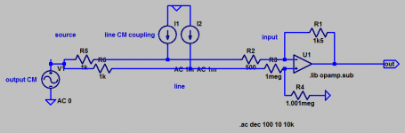

You can think of a balanced connection as a Wheatstone bridge. CMRR for a given frequency is optimum if the following ratios of impedances are equal:
(Zsource(2) + Z(C2) + R2 + VR1 - Rtap(VR1)) / (Rtap(VR1) + R3)
and
(Zsource(3) + Z(C1) + R1) / (R4 || Z(C4))
with Z(Cx) = ( 1 / (j 2 pi f Cx) + ESR(Cx) +... ), Rtap = wiper position, and yes the expression generally is complex
Assuming we're above a few dozen Hz and well below the point where C4 becomes relevant and our source impedance is primarily resistive, this approximates to
(Rsource(2) + ESR(C2) + R2 + VR1 - Rtap(VR1)) / (Rtap(VR1) + R3)
and
(Rsource(3) + ESR(C1) + R1) / R4
Funnily enough, optimum CMRR means optimum rejection for both output and line common-mode signals, which is not something you would expect right away if impedances on the two legs are different. In the attached example, electrostatic coupling (modeled by current sources) is suppressed just as well as a common-mode component on the output, despite the line being at ~333 ohms vs. ~1 kOhm.
Obviously all of this eventually blows up at higher frequencies as parasitic capacitance to ground/shield on the line (even if nominally equal) will have markedly different effects on the two legs. Actually Bill Whitlock has pointed out that capacitive coupling is not exactly equal because the colours of the wires are different, yielding subtly different dielectric constant and outer diameter, so possibly this was the reasoning behind 15k vs. 22k - though I have my doubts about this being repeatable enough to cast it into a circuit unless only one type of well-characterised cable were to be used (and always assembled the same way, which is starting to sound like quite a stretch to me).
EDIT: Yeah, look what happens if I add 2x 300 pF of shield coupling, not that unusual for a cable if some length.
It's much less severe for our case obviously, with CMRR remaining >70 dB to over 10 kHz, possibly still an issue when rejection of longwave / mediumwave signals or somesuch is asked for.

For optimum results yes, but its just not practical. You either adjust the amp to an optimal point by ensuring each input is identical or you adjust in situ for each component you use it with to take into account these things.
Is it best to keep 22K or go to what seems to be the normal 10K?
22k is fine and the value used sets the input impedance seen by both inputs. The noise from the rest of the power amp would swamp the noise from the 5534/22k combination anyway.
