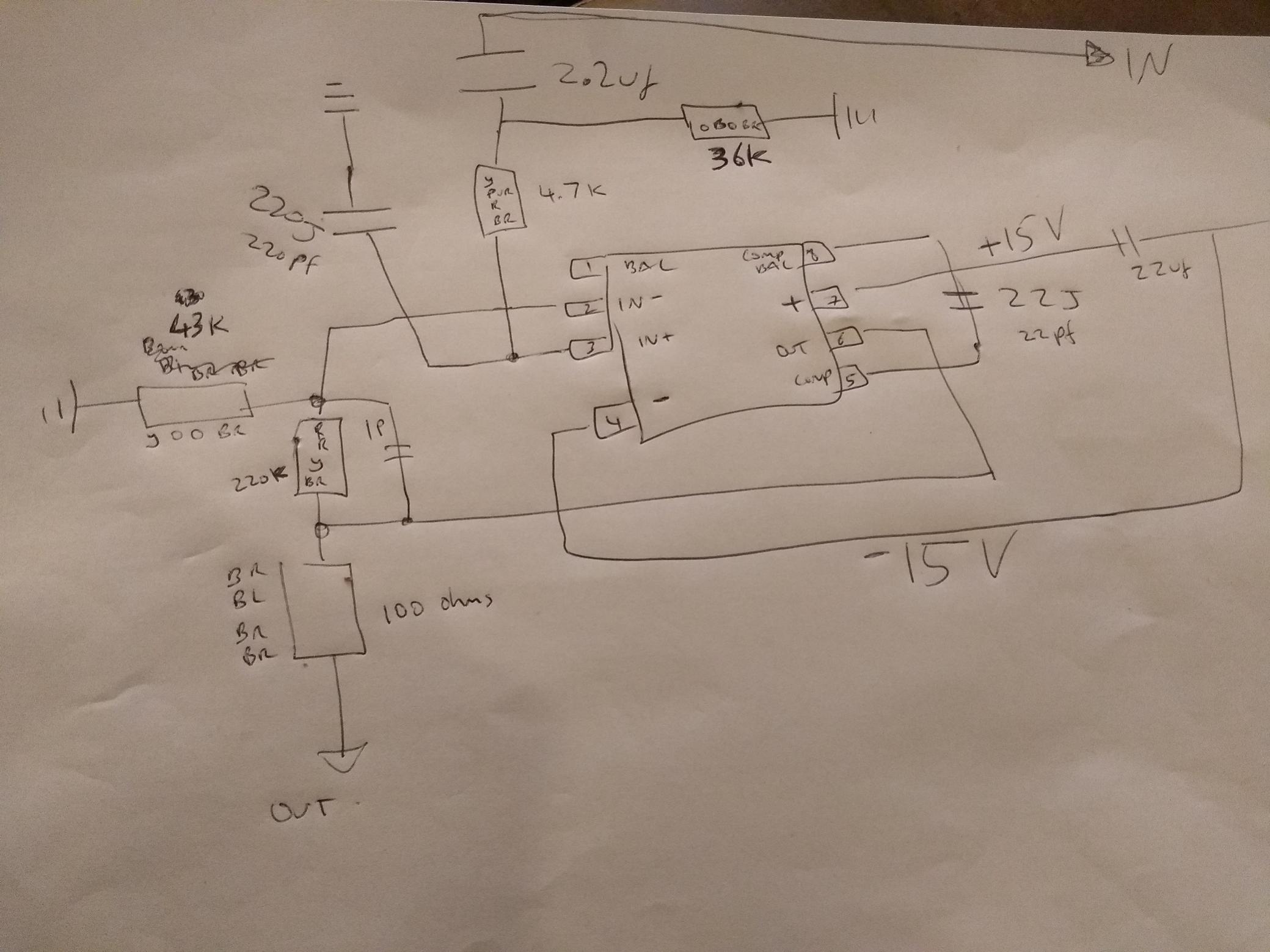

The most likely problem here is something very miswired, wrong value component and / or oscillations.
How have you built this circuit? Can you show a clear photo of the components?
Unless something is really askew, an opamp circuit with fixed gain (set by resistor values) will be flat across the audio band. So something is DRASTICALLY wrong. This is difficult for a beginner with no test equipment and limited knowledge.
The 1pF cap bothers me! That is the capcitance of two wires close to each other!
Check all your components and values, post the clearest possible photos.

I suggest to the OP that starting point to sort this would be to redraw the schematic clearly with a 'proper' op amp symbol 🙂

With the exception of another resistor at input the circuit for ne5534 is highly accurate.
Rayma kindly suggested changing the 30k to 100k and it worked except for the massive DC offset. Even I know 200mv is very bad!

It sounds like there is something wrong with the circuit you have put together.
But on the offset - first I'd say that 200mV isn't that big a deal wrt +15V supplies (max output, say circa 13V depending on load ) so just losing a bit of headroom. With a 5534 you'll need to ac couple the output in any case and the amp you're feeding almost certainly has ac coupled input in any case.
But to get reduce it to by getting rid of the gain at DC then you put a big ol' cap between the resistor from the -ve input that currently goes to 0V and 0V.
ie detatch it from ground and put a cap in the gap. If using polarised electrolytic with 5534 then put -ve cap pin to 0V.
Gain at DC is then unity.

However I do see from the sketch that only one 22uF cap is shown between +15V and -15V and the +15V isn't shown as connected to anything else - I assume it is actually connected on the hardware.

To keep the DC offset low, you need to keep the resistances the the inputs see balanced like you have now (36k + 4k7 positive in) and (43k || 220k negative in).
Another wiggle you could try is to up the 36k to 39k, reduce the 4k7 to 1k8 or 1k5; and up the 220pF cap some - I'd try 470pF and go up to 1nF...
Of course, upping the 2u2 input cap would add more bass impact than any of above.

I wonder if that op amp isn't oscillating. The 1 pF capacitor across the 220K in the feedback network isn't enough. Your gain is also really high. If anything, you should be hearing bass without much in the way of highs.
Try increasing the 1 pF capacitor to 22pF and go higher. If you have an oscilloscope, you could easily see what the circuit was doing. The NE5534 is an excellent op amp for audio.
Your DC offset isn't surprising since your gain is so high. You might want to break down the stage into two op amps with each at a reasonable level of gain. You can control things much better and your DC offset should really drop to the < 10 mV level

1, Ok I tried 4.7uf bipolar on the 2.2uf input had little effect
2, the 1pf changed to anything higher than a 5pf sounds muffled. i.e no treble and sounds hollow the higher the capacitance
3, I have to trace the circuit to find where the + supply for the opamp is coming from but currently can only find 1 22uf power cap.
4, the DC offset was only high when the 30k input resister was changed to 100k otherwise DC offset is normal
5, the opamp is dual power so I have been told 100nf from each power supply to ground is recommended.
6, tried changing the 220pf for something slightly higher and has little effect with high frequency.
I know the Ne5534 is a good opamp so changing that is really last resort.

Replacing the 5534 will only bring you another op amp with soldered leads. I hope you aren't using a socket.
1.) That was expected
2.) Lower the resistance and use a higher value feedback capacitor. Limit the gain to something more reasonable as I think you are trying to get more from one stage than you should. Stray capacitance from the board could be causing some of your problems too.
3.) Who made the board, or are you using a prototyping plug in strip?
4.) Okay, that is expected as well.
5.) Yes, but the world won't end unless there are no filters on the negative rail.
6.) Yes, that is determined by the impedance of the device sending the signal as well as your own component values.
Why not try cutting your feedback resistors by 10, so a 22K feedback resistor with the leg to signal common at 4K3? That will also allow you to use normal values of capacitance for your feedback compensation cap (now 1 pF).

FWIW I agree that the high resistor values and 1pF hf feedback cap are an issue.
If 1pF to 5pF is giving a problem then there's likely to be layout / stray capacitance problems. Plus resistor noise for no benefit.
Plus , yes, needs to check for instability / oscillation.
