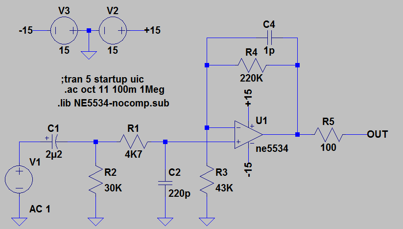

The circuit I copied is the preamp section with no mods as I have:
1, never copied a circuit before with such accuracy!
2, have no idea what does what!
All I want is to reduce high frequency and increase low frequency. And I believe the solution was presented by increasing 30k to 100k (which did add bass)
and 2, to increase 220pf to something higher to reduce high frequency (yet to be tested)

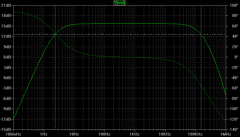

OK, well.. here's the original circuit modelled in spice, with an AC analysis graph:
The -3dB frequencies are 2.37Hz, and 152KHz. Not too bad. There's only about 3.2mV of output offset which is also low. Not bad considering there is no blocking capacitor in the feedback path.
By increasing R2 to 100K, we get a -3dB cutoff of 0.719Hz. However, this then causes the DC offset to shoot to -200mV - BAD.
Much better DC wise, is to increase the 2u2 to 4u7 or 10u. That will lower the LF -3dB cutoff point, and wont interfere with the DC conditions of the circuit
the 1pF capacitor (c4) is there for stability purposes... though to be honest, it isnt really doing anything, and you can probably just remove it. If you want to decrease the -3dB HF rolloff point, increase C2 from 220pF. Try 330pF or 470pF.
Bit confused by this. The 2.2uf is bipolar film and is audio input from volume control pot

No.. the -3dB HF is not really a treble boost or cut, it is a bandwidth limit. What you might find on older gear is that high frequency crap from things like mobile phones can get in and distort the signal. Limiting the HF bandwidth of the circuit can help with this. If that's not an issue, I would leave it alone.
OK, i showed an electrolytic capacitor as that's commonly used. It doesnt really matter.
Try a 4u7 polyester cap such as a Wima MKS2. I think that will give you a result you are happy with.

4u7 for C1 will give you a -3dB LF cutoff of 1.12Hz. Much lower than the original. I'd say you'll be happy with that.
If you REALLY want to play with C4 id suggest a 2p2 capacitor of good quality. I wouldn't use a silvered mica as they are physically large and you'll have more problems with stray pickup. Use a ceramic capacitor with NP0/C0G dielectric.
Likewise, if C2 is a ceramic capacitor, change it out for a 220pF ceramic with NP0/C0G dielectric. If it's a film capacitor, leave it alone.
