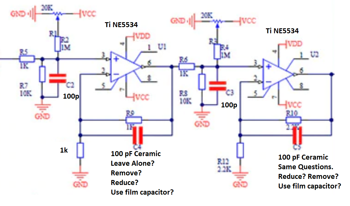

Not sure if this is the best thread for this but I have attached a schematic for an NE5534 preamplifier which contains four 100 pF ceramic disc capacitors.
I was wondering if the 100 pF ceramic discs across the feedback resistors are too big. Perhaps I should reduce them or omit them?
Asking for suggestions before going the alternative route of downloading LTSpice.
