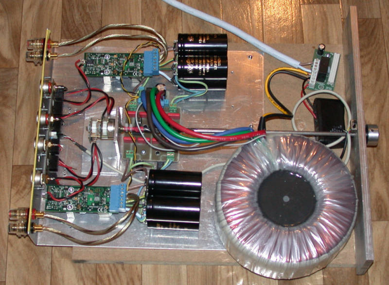

Noise from my amp
Maybe there already are answers out there, but why am I hearing noise from the speakers when the amp is powered on. (Whistling.)The noise is not permanent, but has been more rappid and increasing in volume lately. I am specially hearing the high frequent noise and it's getting to annoying.
Can it be from nearby components, wires or maybe that the ncd modules are influenced by each other.

Hi all,
Here are my findings so far for the hissing noise coming out from the modules.
When I use the RCA outputs from my Audia preamp (output imp at 50 ohms which should have no apparent problem driving low impedance power amps) the hissing sound from my 95 db sensitive loudspeakers is bearable. However if i use the XLR outputs the hissing sound is excessive and masks the sound of music...
When i use my passive preamp with a 47k pot, the hissing sound is half of what is coming out from the active one. I belive the input impedance of the NCD modules causes interphase problems with most pre-amps and care should be taken when you choose a partnering one.

I'm not sure it's the same, but I've got a whistling noise in mine, that varies both in frequency and volume. It's somewhat louder when I connect a ZAPfilter output stage through a 10k DACT attenuator, but still there on other sources or totally disconnected. I thought it might be the heterodyning mentioned in the NCD cookbook, but minor changes to the crossover frequency hasn't made any difference. I'm using the LM4562, and I'd rather not change.
I'd like to add that my amp is just temporarily thrown together, with no walls or lid, and rather messy internal wiring.

Dear Novec,
If you read my comment above you will also agree that the whistling noise comes from the interaction of the output stage/dact attenuator and the NCD modules. Since the attenuator changes the impedance on the various settings of the pot, the whistling noise also changes in density and frequency.
I believe if both the NCD and Zappulse modules had high input impedances, these noises would not be noticable.
Also in your case, since the dact pot follows the zapfilter used as a preamplifier (please correct me if i assume wrong), the NCD modules "see" an impedance at their inputs that change every time you move the pot.

Wonder what the pot value is? I think NCD likes the lower value ones which is 10K as shown in the cookbook.
I second that, since NCDs input impedance is only 5 kilohms....
