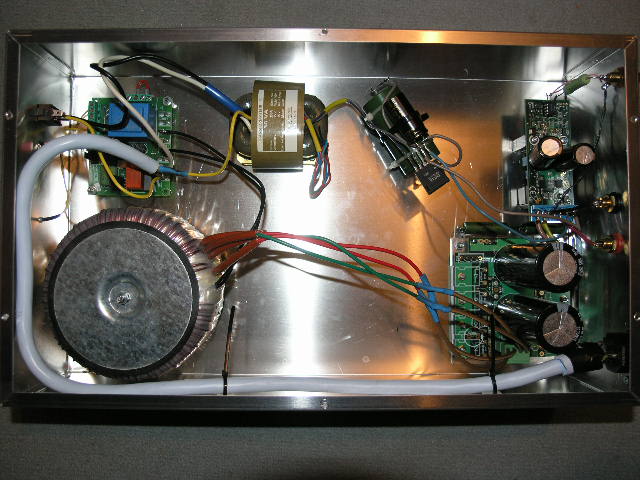

Marmatsouris,
Well, it concerned the mains caps of the PS. Perhaps the ideal value of the caps depends on the size of the transformer?
I'll try the bypass caps. The problem is to integrate these with the shorter wires as possible. If the wires are too long, the benefit could be null...
For the moment i've put a 11Kohm resistor (kiwame) on the input, because my préamp has a very high gain. I'll try to remove it because i've compared the NCD with a "reference" DIY friend's valve amp.
I've not noticed that in highs, the ncd was not so detailed that the valve amp. It is remarquable with violins strings. The texture of the strings are less rich. But this valve amp is very very good!!!
I'll try to post some photos of my amp...

Edge540:
I belive I see that you have changed the caps on the NCD module. With what value and brand and have you experience any difference in the sound?
Roger
Roger

Hi edge540
The by-pass caps "in theory" will have to be 10% of the value you want to bypass i.e for a 15,000mF cap the by-pass needs to be a 150mF which is impossible to find a good quality MKP of this value. Thus for a real world situation you will have to place a 1% value of the original cap i.e. 15mF which you can again by-pass with a polysterine one at 1.5mF.
With regards to the resistor you have put in series with the input of the NCD1 to lower the gain, i am afraid you have not done it right. You will need an L-Pad arrangement, i.e. one resistor in series and one to ground in order not to upset the circuit.
I believe Lars can help you with the correct values of the resistors.
Kind regards,
Nikos

You 're right Nikos 😉
I've removed these resistors and what an enhancement!!!
They were a filter and now the bandwitch is larger, especialy with bass. It's more live and more subtile.
It's always a good lesson to compare amps, and now with the resistors removed, i'm curious to compare it again...
Roger,
Yes i've changed the chemical caps with black gate's FK. It's difficult to tell you if there was an enhancement because i've mount it with another mods and there is a long period for breaking these. But I think it is benefic.
But the lead-free solve is an horror to desolve
Roger,

marmatsouris said:[
What are the "other" mods you have carried out?
Also, the black gate caps you have installed are they the same value/voltage?
Nikos [/B]
The black gate are 100µ 100V. It's the the same value.
My other mods:
- LM4562
- Wires between supply and amp directly solded to the connectors.
- external power supply for the Vgate, with R-core transfo.
Thats all 🙂
Lars,
Could you explain me in what to put a resistor at the input, could have a negative effect. I don't understand but it's evident when you hear!
It was a 11Kohm 5W kiwame.
Yet, i have follow the cookbook in case of a high gain préamp. Only, I din't put the cap because the outputs of my préamp have some.

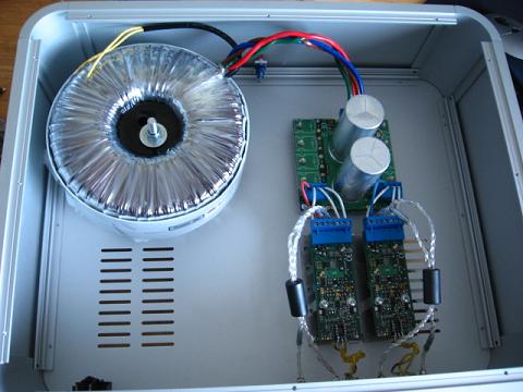

Error fixing
There is one (small?) error in one of my NCD1 modules. Should I do the re- soldering myself ? or let Dexa do the job... Has anyone any exerience with the tin used here ?
Eric.
Eric.
Re: Error fixing
I've got a soldering station with a temp of 350°C Max. It was difficult to desolve the chemical caps. The soldering is lead free and requiere more temp to solve.

Re: Error fixing
So far, so good... Issue has been addressed and solved by Lars. Just waiting for the last parts (Softstart/Filter Combo).
I've just finished installing AutoCad to do some case modeling after drawing some rough sketches with pen and paper.
This is fun as well. Takes a big chunk out of my sleeping hours and whisky supply (everybody here joins in the discussion what art is and should be(…) and minds are more up to this challenge after one or more drinks ;-) ) Still, it's like planning a holiday... pre-fun !!!!
I might also be lucky to have found someone to do the actual CNC work for me. Just have to wait if he is still willing to do so after he has seen my design... ;-)
So, things are going slowly but steady… cheers, Eric.
