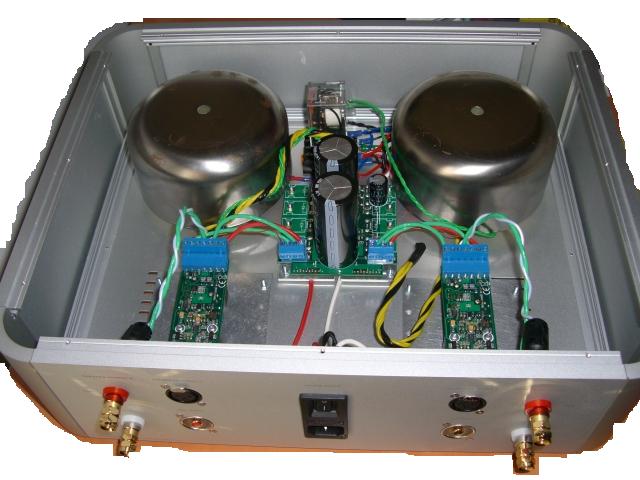

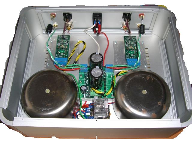

Hi Lars,
I am also waiting the combo to include in my amp project which is about ready. I am also waiting the second p/s for a true dual mono design.
I have posted the long-awaited photos.
Thanks also to Richard (from Hexatech) for the nice cabinet.
I will post my sonic experience soon. Needless to say that i have tried it against the Lc Audio's 700XE but you just have to wait a bit longer for my final verdict. I HAD to mention this in order to get your attention......

It took me a while to (almost) finish the amp but believe me it is worth the effort as i wanted the amp to look as good as it sounds. ( i still need to upgrade it with a second power supply and the LM 4562 ic).
I believe this is the best design ever offered by Lars (up till now as we never know what future holds us from this clever designer...).
Compared to the LC Audio 700XE module in a "better" implemented amplifer (two 650VA transformers by the same maker as mine, 2x18,000mF Gold Tune Nichicon caps per channel bypassed by Jensen foil caps, VDH wiring, power maxed at 350watts per channel etc), the NCD1 was much better in the soundstaging, better resolution, faster (i believe the "slowness" of the 700Xe based amp was caused by too much capacitance at the p/s section), and more controlled bass but not as extended as the higher powered amp.
The above observations are not final because the NCD1 modules have only been broken-in for 30 hours...
Next is the fitting of the second p/s and the change of the LT chip.
The ultimate test will be the comparison of my Audia Flight 100 amp with the NCD1.
Stay tuned, as "i will be back" with more listening impressions...

Your amp look great. I have order the same chassis from Hexatech, and as soon as it arrives, my NCD modules will be installed.
I am looking for some transformers. Yours look nice, so where did you get them?
Roger
Roger

Pboden said:Your amp look great. I have order the same chassis from Hexatech, and as soon as it arrives, my NCD modules will be installed.
Roger

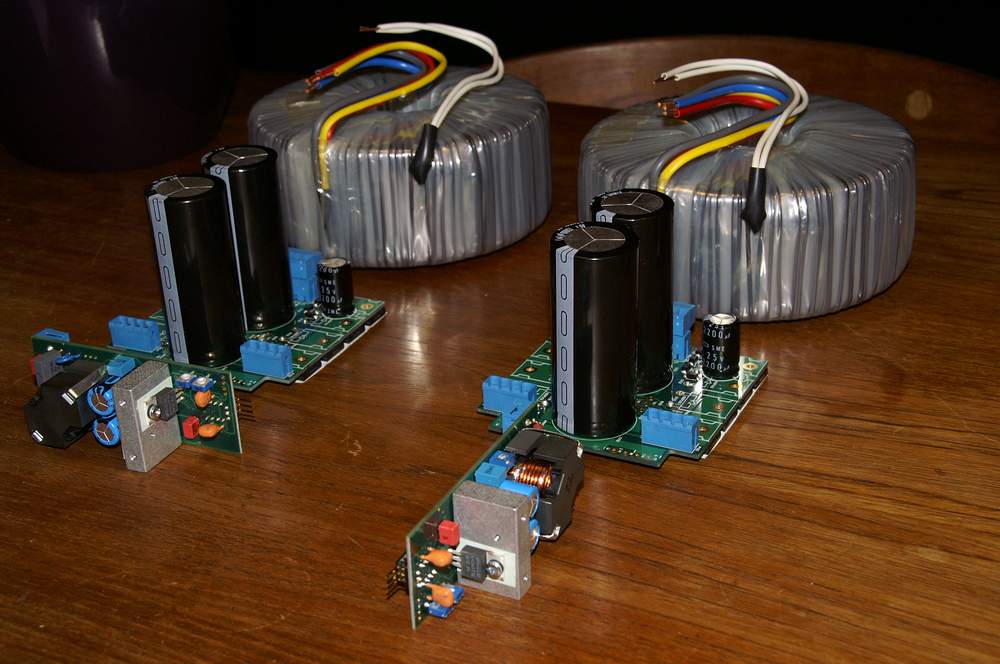

Hi Roger,
There is a local guy that all his life has been producing transformers to the local industry....He runs a little shop that does wholesale buy you can also buy retail from him. Thre is no web page of some sort to see his products as this is aone-man-show kind of business.
I have asked him (politely) to put the transformers in the metalic caps and pour as much resin as possible. there is no ringing, humming, singing bla bla bla of the transformers. I never expected the core material to be from a meteor landed form outspace or the wiring to be 10Ns of extra pure copper mined from Down Under.
Simple 500Va transformer with extra 15Volts for the 6-wire Power supply module, and that's it.
Nikos
