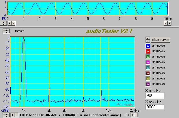

What's the setup 16bit/44K sampling card? What's the software?
I have a Soundblaster Live but I built a bandpass filter to clean it up. See attached. I can reliably measure about 0.0005% with enough samples.

amplifierguru said:
Hi Anli,
I have Terratec Aureon 7.1 Space. I use Linux. FFT is shown by jaaa (http://users.skynet.be/solaris/linuxaudio/).
(Your plot is strange: I was sure Soundblaster's DAC-ADC loopback test must show much more harmonics rather -105db 🙂 Much better DACs have distortions about -90-95db)

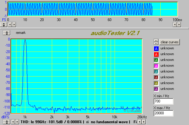

amplifierguru said:
I built an external two stage MFP Q=4 filter to remove the -86dB
2nd harmonic, the 4th and other spurious output from the soundcard output side. See attachment for before.
OK, I see. Now I'm surprised with your ADC quality 🙂 (typical ADC of $100-200 sound card is aproximately the same as for DAC or less better): if I understand well, with your external filter only ADC quality does matter.
