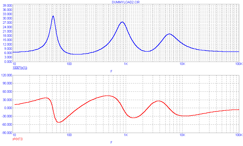

I have finished my dummy load circuit recently.
Surely it's not good to "feedback" voltage which is random (compared to source signal)
It should make no difference - indeed one might argue that if anything is going back the less correlation the better - since correlated noise will produce correlated products that are audible. Indeed the whole pint of feedback is that the error component is pretty much anything.
But the real point is that feedback, in principle, does not care. One could think of the output impedance (i.e. the reciprocal of the damping factor) as the metric of how good a voltage source the amplifier is. If the amplifier really does have that output impedance across all useful frequencies, you have a limit on the error that the speaker can create.
But the question is not about that. But rather if a real implementation of a feedback amplifier is subject to some additional error (distortion) mechanisms due the the complex load.
On the whole I would be surprised if it were, but I am quite prepared to be surprised.
