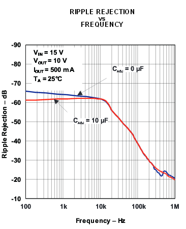

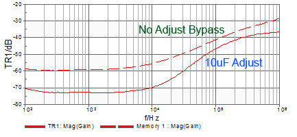

For the record -- here's the LM317 PSRR measured with and without 10uF on the adjust pin and the data sheet -- note that the y axes are in different directions:

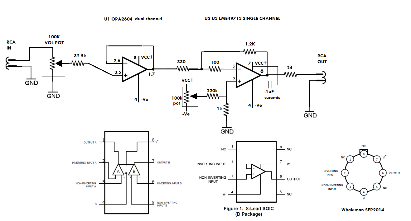

So attached is a working basic circuit for the LME49713, perhaps some of you with experience can dress it up and improve it. It is basically a copy of Mooly's work referenced to another thread earlier, with Ri and Rf changed for about 4X gain. The sound being produced is definitely worth the effort and the cost of the LME49713HA (metal can) op amps at Mouser, at this writing is $12.37 each.
Thanks for all the help.

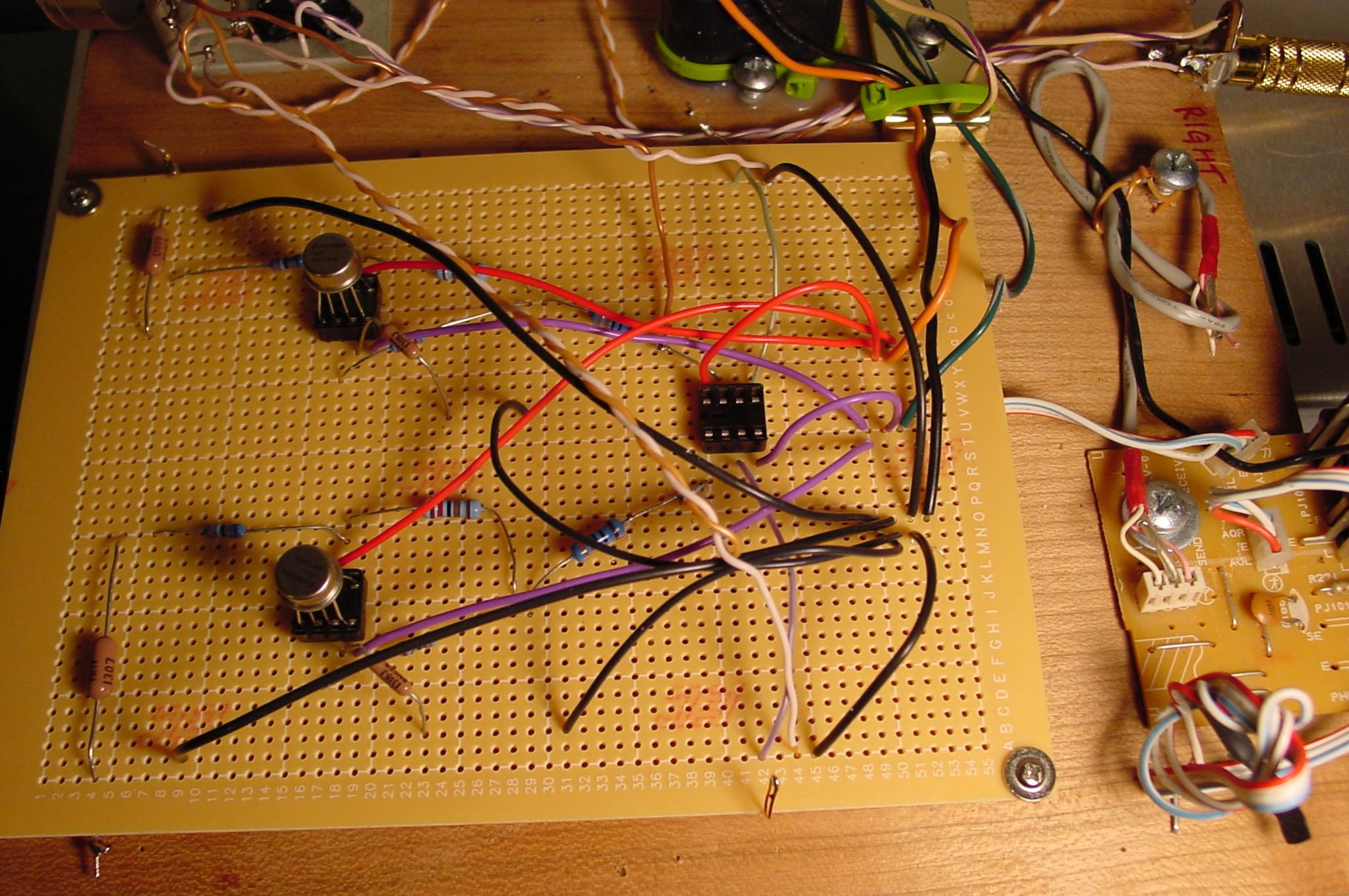

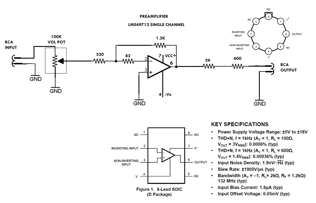

The gain/noise problem comes from the volume control configuration. perversly that configuration increases the gain of the opamp as the control goes to ground. The input signal is reduced by the pot but the gain increases and the noise increases as the gain is increased. The pot output drives the 330 Ohm resistor which is connected to a virtual ground.
In short, it won't work. You could use a 30 Ohm pot, not practical or follow Marks advice and put the pot on the output. Again use a low value pot. The input impedance of the gain stage is 330 Ohms, very low, so not much beyond a headphone output can drive it.
I don't think the 82 Ohm resistor on the - input does anything useful either. That node is low impedance and the resistor will degrade the operation in several ways.

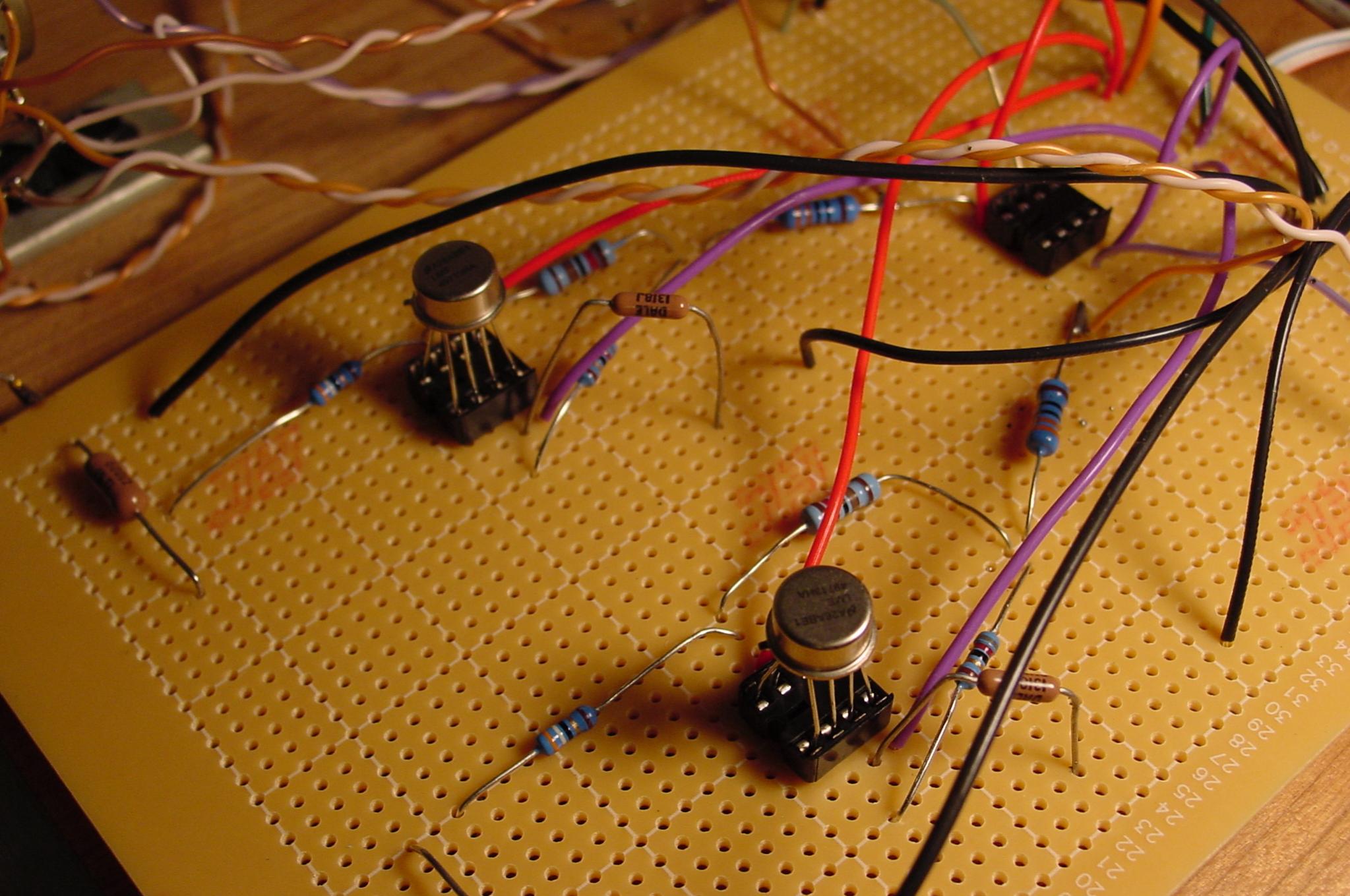

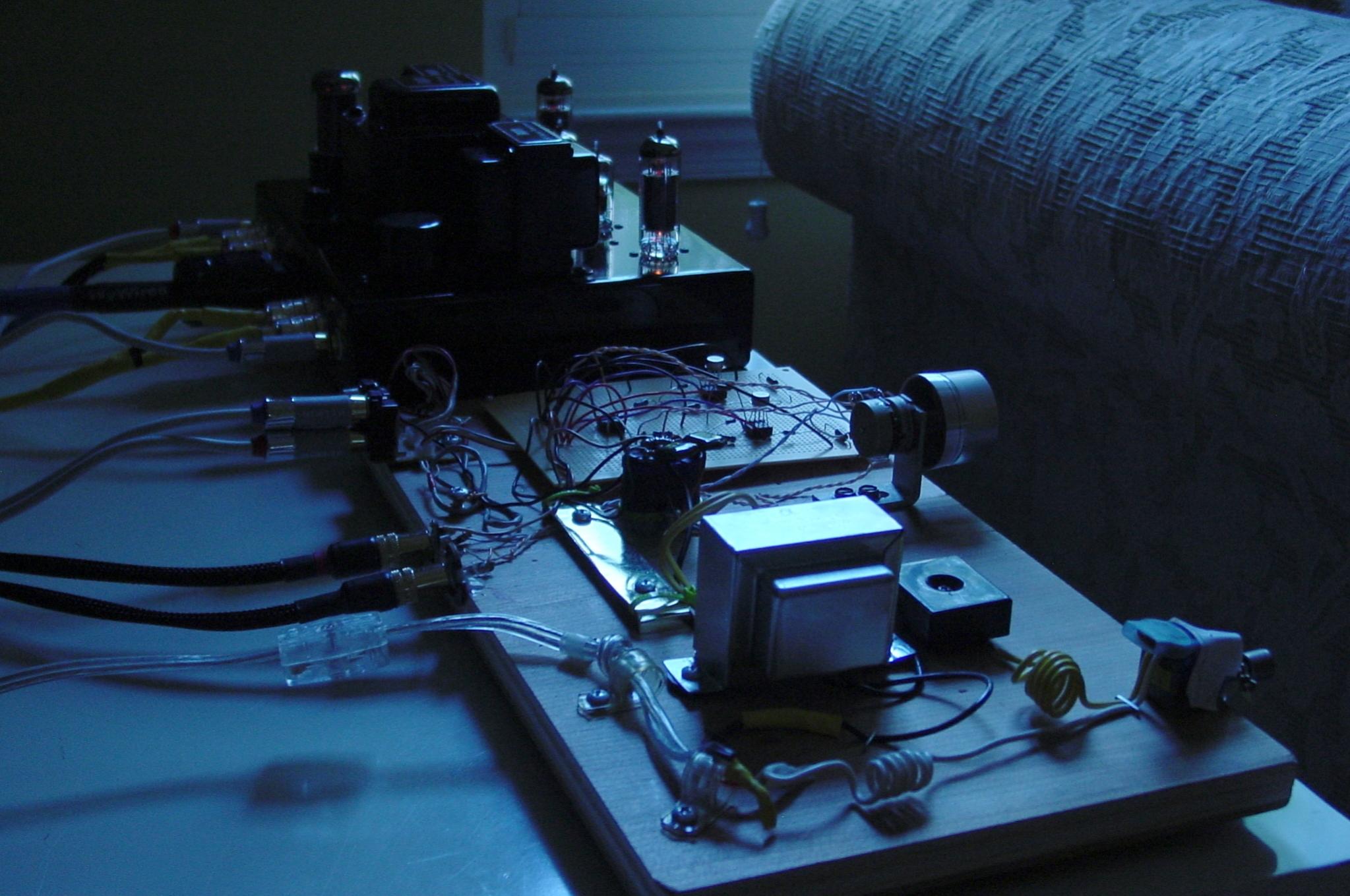

The LME49713 op amps arrived from Mouser yesterday. I quickly replaced the damaged ones and tried the circuit attached. If the volume control was say over 8 o'clock, things seem to work just fine. Turn the vol pot all the way down and pink noise appeared that seem to be getting louder and louder. Also the vol pot was very scratchy and popped with movement with no signal. The op amps were getting warm to the touch as well. I did add the buffer as suggested by Mirlo. I then replaced the 13's with some LME49710 instead and the circuit works wonderfully, no noise of any kind, op amps not even warm to the touch, and may just leave it there--unless someone has the clue. I thought about placing the vol pot at the end of the circuit and maybe try that, but blowing these op amps again is another $30 proposition. Anyhow, that is the update...
Is the 713 bipolar and the 710 jfet input? 😉
jan
Whaleman,
did you try adding 100nF ceramics between pins 4 and 7 of each opamp? I don't see any caps on your photos and all the wires are looooong....
I ran into something similar just yesterday. I built a little circuit utilizing a TL074 on a small piece of veroboard, powered by a lab supply (leads about 60cm). I measured THD at 1kHz and about 6Vrms output into 1kOhm and it was several percents, which is way too much even for an 'old' opamp. Fitted the cap and everything was fine!

The gain/noise problem comes from the volume control configuration. perversly that configuration increases the gain of the opamp as the control goes to ground. The input signal is reduced by the pot but the gain increases and the noise increases as the gain is increased. The pot output drives the 330 Ohm resistor which is connected to a virtual ground....

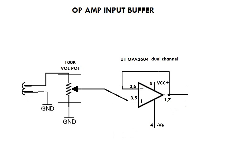

So, the offset output of this buffer is -7 VDC (rails about 9 VDC), obviously something is wrong in the schema attached. Does ground go anywhere on the buffer?

What's the DC at the INPUT? Try a coupling cap to be sure. Did you put both opamps in parallel, like the pin numbers on the schematic imply? If so, don't do it!
I did not measure at the input, but there was nothing connected to the circuit at the input. You mean a coupling cap between the buffer and the 713s?
The pin numbers are just for reference, the 713s are wired individually.
The input impedance at the 713 is exceedingly low.
If you used a coupling capacitor here to block DC it would have to be enormous.
Forget that as a solution.
Instead block DC at the input and arrange your component values to end up with near zero output offset after the 604.

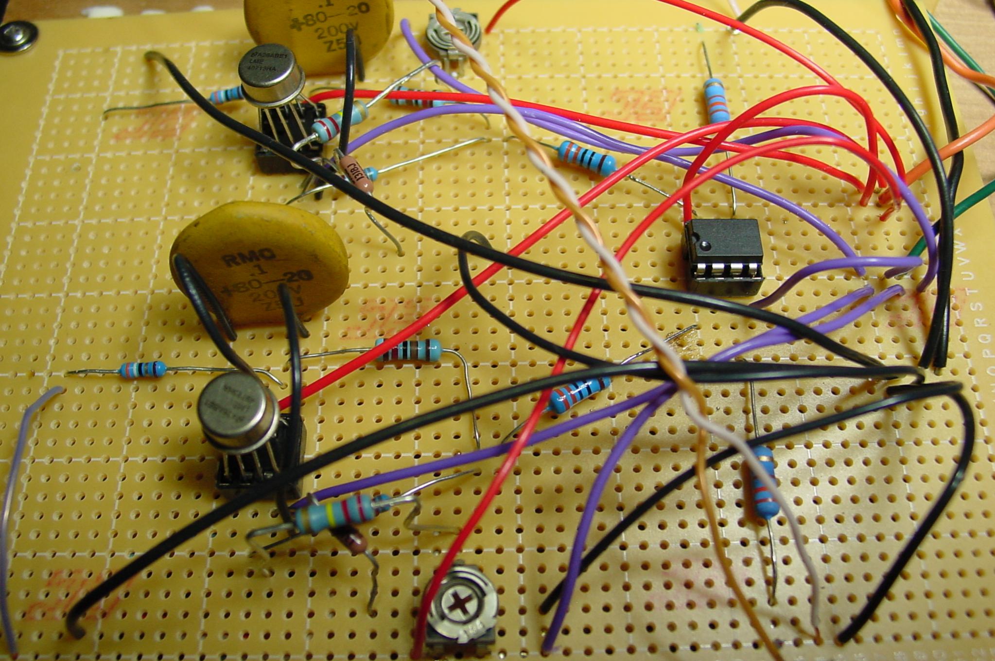

I think this is the last step that remains, there is some DC bleed through on the sound.
I was able to get the 604 offset to virtually zero, I had forgotten to tie pins 1 and 2 on it.
Offset then at the 713 output was about 800 mV with the volume all the way down and less as you turned the volume up. I added a 32.5K resistor to get this steady then a trim circuit on the 713 to get the output offset down to zero. Now it is starting to get much better.

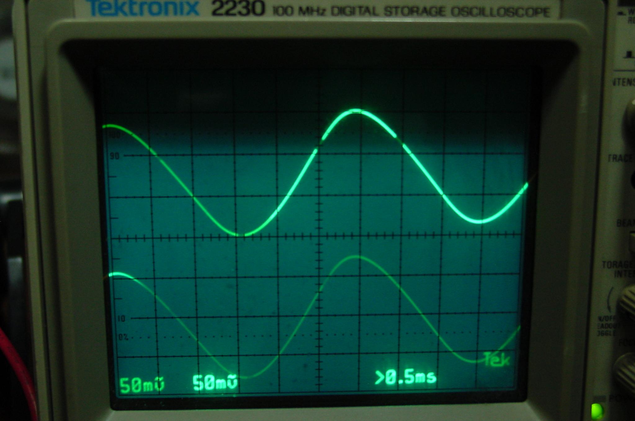

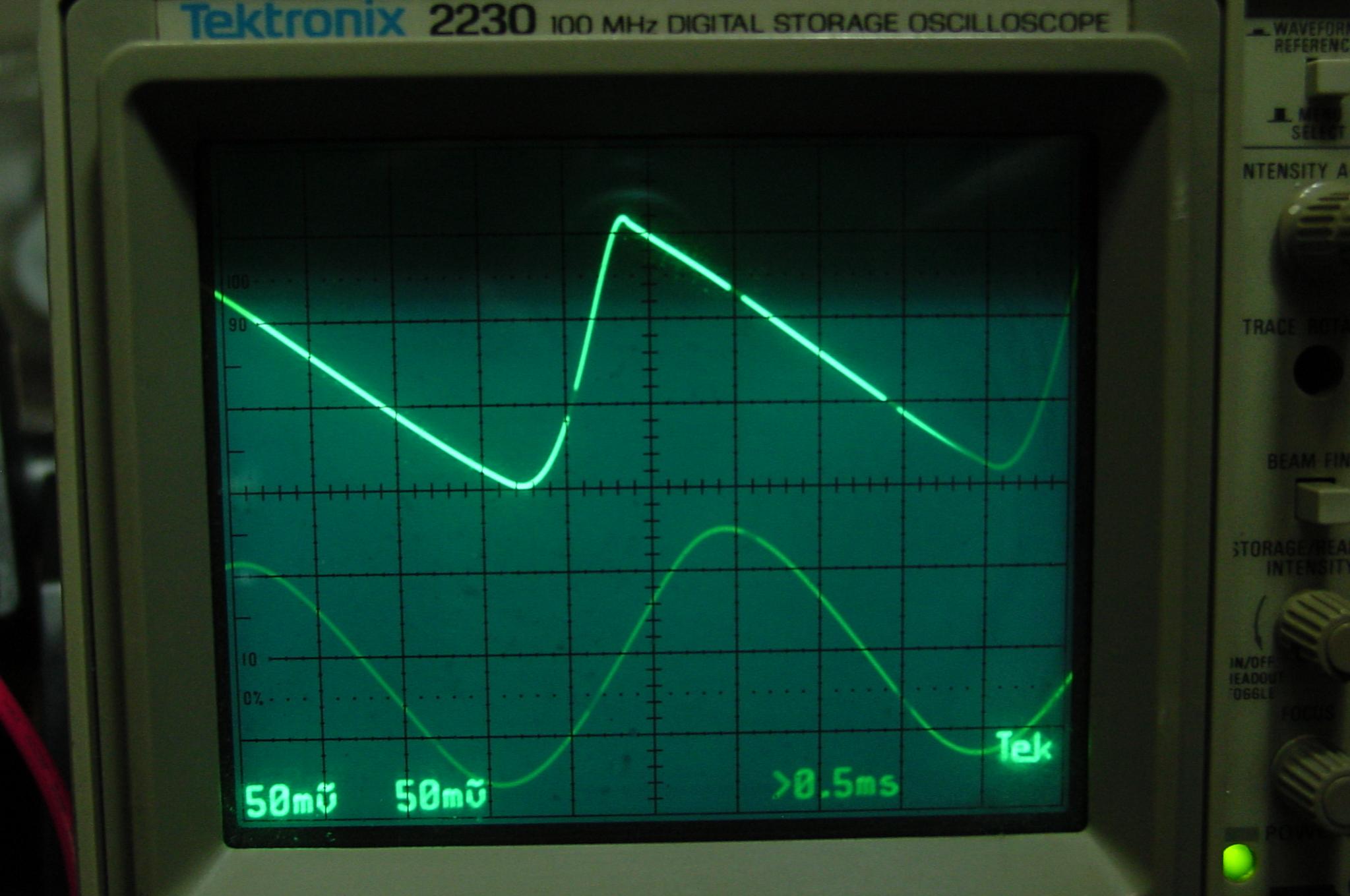

Very faint DC hum in sound and the 1K scope follows, input wave at bottom, output wave above it. Then wave at buffer output, top second scope photo. This remains to be fixed. Not sure how to interpret the "sea" wave.

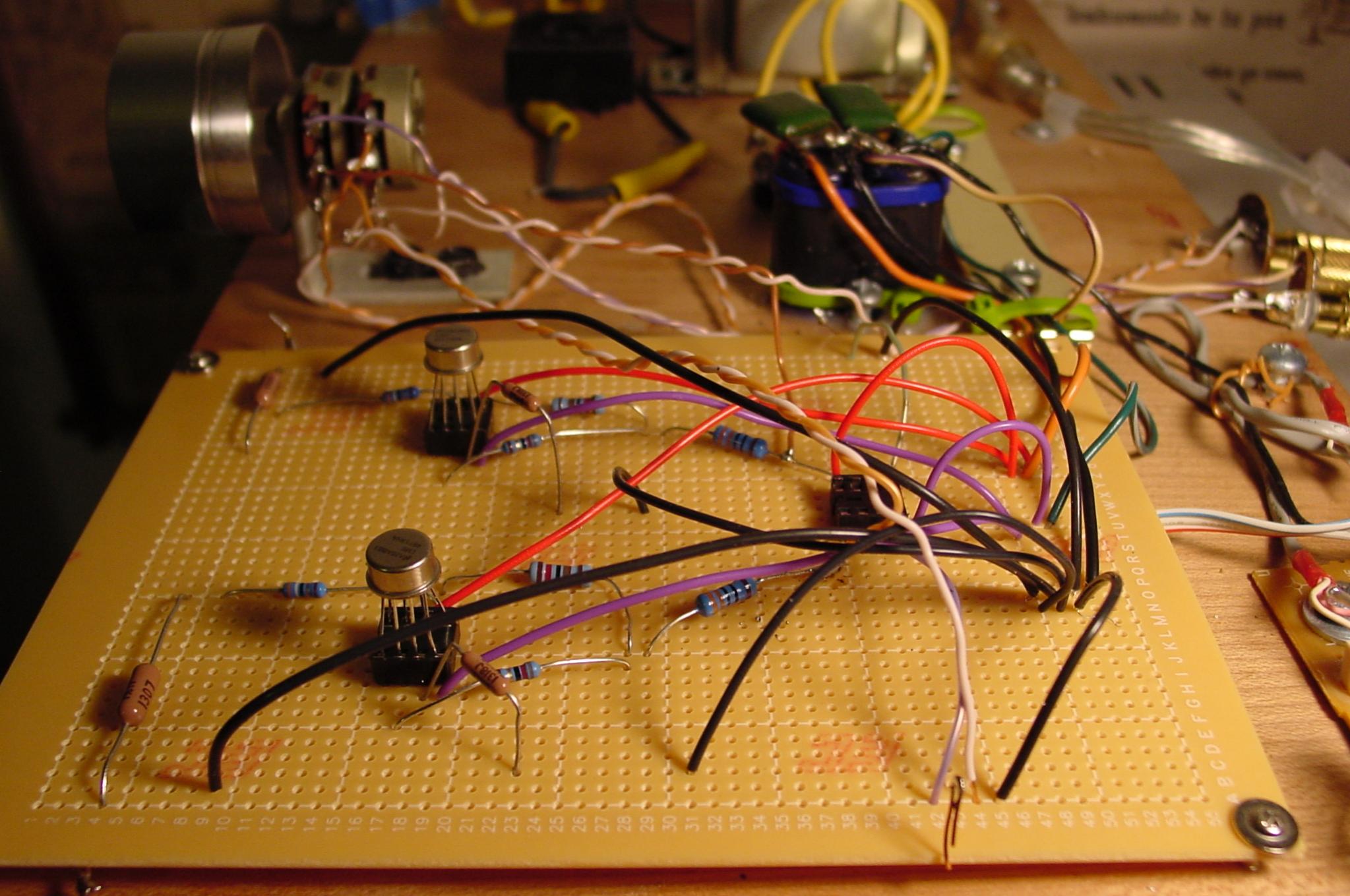

Sound is quite worth the effort and I need to perfect it. I know, wires going in every direction :spin: See pics.
That sawtooth is the output from the buffer, while the sinewave below is its input? What am I missing?
You don't have to use such huge caps, btw. Use X7R for best results. Small foil caps like WIMA MKS2 will do just fine, too. Best is to make the leads as short as possible, ie. place the cap on the bottom of the board and solder it right between the pins of the socket. Please try this with the buffer, too. A buffer should not produce a sawtooth, output should look like input...
EDIT: Guess I got the scope shots confused. But still, that "sea" wave looks strange and seems to be present at the input already.
