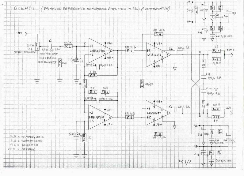

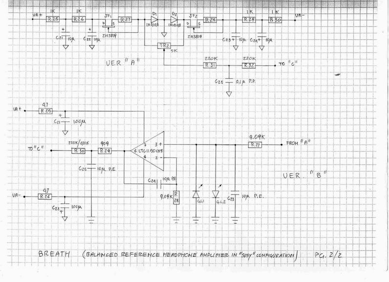

Hallo Mark / Audioman54
Since You are deep expert in operational amplifiers and Hi-end audio electronic design ,I wish submit to You ,and everyone interested ,my project for a reference (hope), balanced output headphone amplifier in “SuSy” configuration for a very low loads (25-60 Ohm).
Since I’m not a skilled designer (this is my first project….) I don’t understand if the dc offset of the output stage is nulled or not by the crossed feedback of the "SuSy" configuration. In any case, I’ve added a hypothesis for two kind of nulling circuit ,one “manual” and another “automatic” but I’m not sure if this is the cure to control both legs of balanced output signal….
My questions are :
In your experience ,this project can work, perform and sound good as expected or need to be refined or redesigned maybe with others chips? ( I like very detailed, analytic, transparent, fast and dynamic sound and I have read that these current feedback Chips have the sound characteristics that I prefer.)
The circuit can work properly without nullig circuit and if the ancillary offset control circuit is requested, what is the best solution?
My friend tell to me is better to put face to face in physical contact the two LT1210 for a optimal thermal tracking. For a similar reason is better to use a LME49720 instead of two LME49710?( but the single opamp solution is better for more freedom in alternative parts choice and future tweaking)
Can You suggest me a right way to do a good PCB ?
(For what I read in the forum, in this fast and large b.w. circuits is important to place the decoupling capacitors near as possible to the chips. Also important is to do a separate star signal ground and star power ground routed to common ground of the power supply.)
Thank You very much in advance and Merry Christmas !
semola

Thank You lumanauw for the suggestion,
but I think is not ideal for a direct coupling with a low impedance headphone.
The performances are very good but specified for a 600 Ohm load.
moreover is a smd component and it need a soldered area under the chip for thermal dissipation.
Not very easy for a DIY realization...
My circuit is conceived for a DIL and TO220 chips. More easy to handle.
Regards
semola
