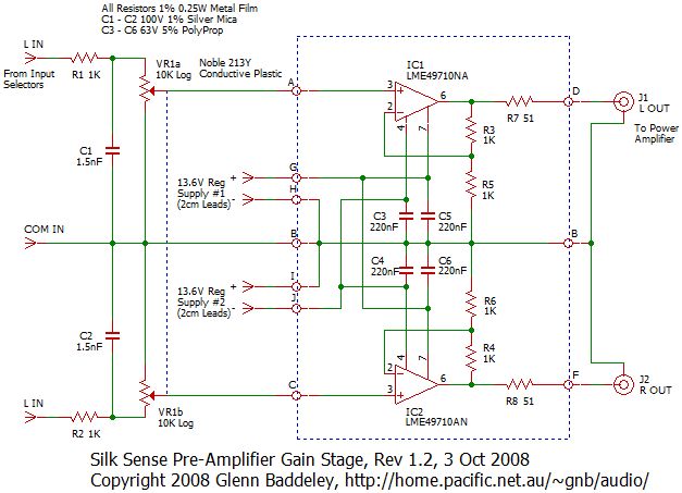

Silk Sense gain stage using 2 X LME49710
Here's the gain stage schematic. I have been using it for nearly a year. The main source is an E-MU TrackerPre USB DAC (up to 192 KHz / 24 bit). The power amp is LM4702 with TIP142/7 output stage.
With the volume pot at minimum the output noise is about 2 uV RMS, which is -114 dB referred to 1 V. Frequency response is 0 Hz (ie. DC) to -3 dB at about 100 KHz.
Without the RC filter, slew rate limiting kicks in at about 1 MHz with 2 V RMS output,
at 0.16 V RMS output the amp is 3dB down at 7.5 MHz, but that's all pretty meaningless for audio.

do you have a schematic esp. from RC-filter?
Hi Glenn
thanks for the schematic!
What is the audible effect of the RC filter. Sorry, but I can't imagine that you will hear a difference (negative) if you omit the RC filter because I can hear just about 17kHz or less. It's a LPF with 100kHz.

Hi Glenn
I don't hear anything. I have tried silver mica and polystyrene. Both are inaudible. I wouldn't use polyester or ceramic in this position.
True, but its always a good idea to low-pass limit amplifiers to make them less susceptible to Electro Magnetic, Radio Frequency or Magnetic Field interference, and instability caused by out-of-band signals entering the amplifier.
I chose 100 KHz so the full high-frequency resolution of my 192 KHz sampling USB and SACD player would pass through the preamp. (Pity the power amp and the speakers don't go quite that high, but that's a completely different issue). Its been demonstrated again and again that hires audio formats operating at much higher sample rates and bit depths than CD actually sound much better than CD.
