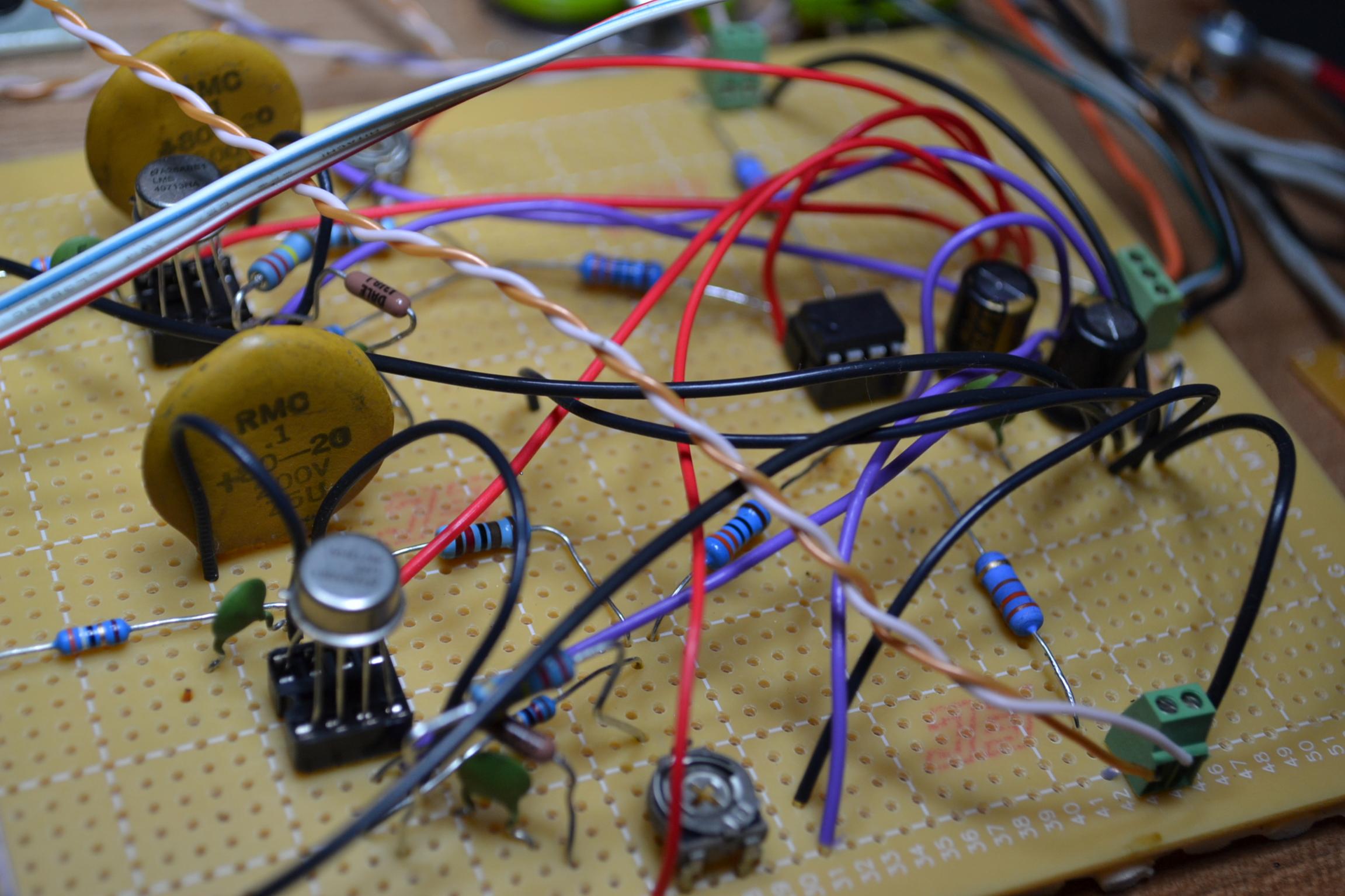

Took care of the .1 uF cap across the 49713 power pins as recommended earlier. Yes, I know the caps are big, but they are recycled from an old scope.
... Small foil caps like WIMA MKS2 will do just fine, too. Best is to make the leads as short as possible, ie. place the cap on the bottom of the board and solder it right between the pins of the socket. Please try this with the buffer, too...
Will try shorter leads...
...You will need a good ground plane implementation to keep it stable. Possibly surface mount .01 uF MLCC at each power supply pin.

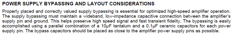

Next "to do" is to bypass the power supply pins, see attached from the LME49713 Datasheet Application Notes.
a 0.1uF ceramic...as close to the amplifier power supply pins as possible
These are not all the same.
The Wima MKS2 will not do the job !
The extract also says
a wideband, low-impedance capacitive connection between the amplifier's supply pin and ground.
The "ground" referred to is Power Ground. The ground side connection from the capacitors MUST also be "wideband, low impedance capacitive connection".

As far as I have seen, every opamp datasheet specifies decoupling capacitors.
Each manufacturer specifies a mix of MF and HF decoupling, some on both power pins to power ground, some between the power pins, some from one power pin to power ground.
Initially you MUST follow the manufacturers advice. With experience (sometimes from others) you may decide to vary the decoupling to slightly different from the manufacturer specified values and types. Many manufacturers specify Tantalum caps for the MF decoupling. This Forum tend to shy away from Tantalum.
I used to use Tantalum, then I stopped, recently I have started again but at <50% of voltage rating and where impulsive interference cannot damage the cap.
Decoupling per the manufacturer recommendation was the last and missing key in this whole thing. The op amps were oscillating until the decoupling was done.
I used a .01 uF ceramic capacitor to ground off each power pin on each op amp and a 33 uF electrolytic on each rail to ground (did not have .1 uF ceramic, but a bunch of other film types and I wanted the low ESR of the ceramics).
Was not ready for how much difference this would make, no more hum, no hiss and static when the op amps started to oscillate, and the op amps cases are no longer hot to the touch as before.
The sound of the LME49713 is beyond any of the popular and friendly op amps as the OPA2134--which I use often, perhaps twice as good (IMLO) and worth the effort. Glad for it and you all's help.
I am listening to the pre now, I will be moving it to a case.

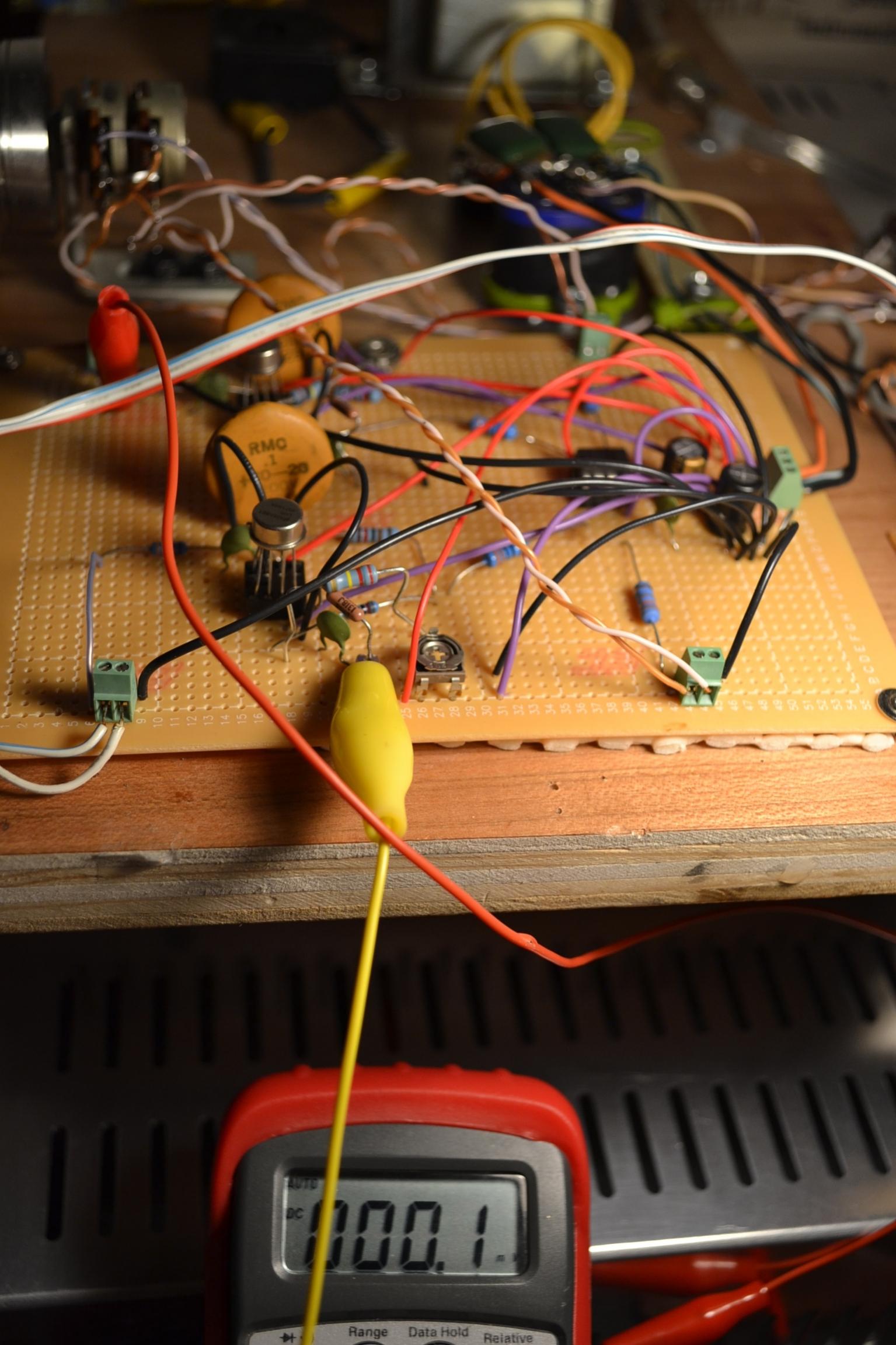

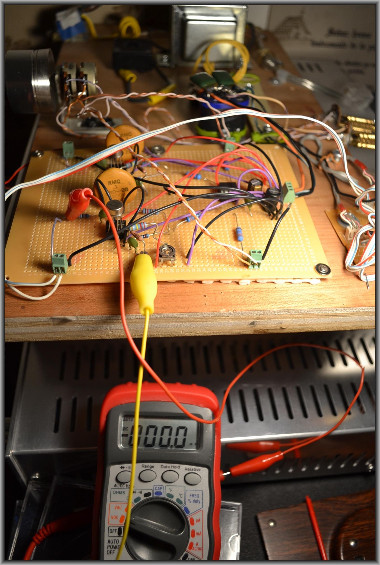

Attached you can see the offset output (0.1 and 0.0 mV) of the preamp, right channel, then left quite good!
Now, how do I get a PCB made for this, I don't want to end with another wiry mess :smash:

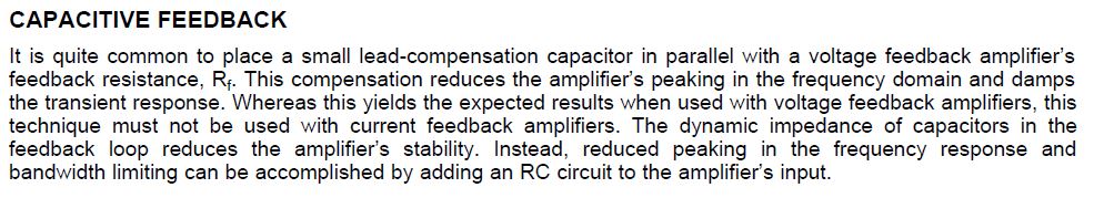

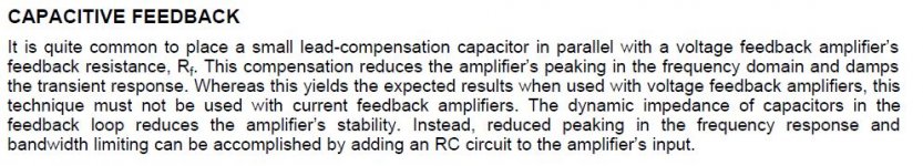

A cap is also usually placed across the feedback resistor to further optimize the phase margin; the lower the "dominant pole", the better the phase margin, in a typical circuit. I'll usually set that to about 200kHZ unless I have a reason to do otherwise. I use ceramic caps for PS bypass and polypropylene or polystyrene for all other caps if possible. Then you have a great circuit.
Thanks Bob for the good comments. Can you expand on the first paragraph above, do you mean an RC network at each signal input into the board to filter signals above 160kHZ?
Also, specifically for this op amp and maybe other CFB op amps, the cap across the feedback resistor is discouraged. See footnote attached taken from the LME49713 app. notes.
Thanks again.
Yea, I was only talking about voltage feedback opamps. Current FB opamps appear to be optimized for much faster speeds, for digital data processing or something. I haven't spent much time looking at those and haven't used any.
Not sure what part of the first paragraph you were asking about.
At high frequencies, the wire going to and from a cap becomes a significant inductor, which causes phase shift, and can cause circuits to oscillate or ring at very high frequencies, which often includes slewing and all the distortion byproducts of that.

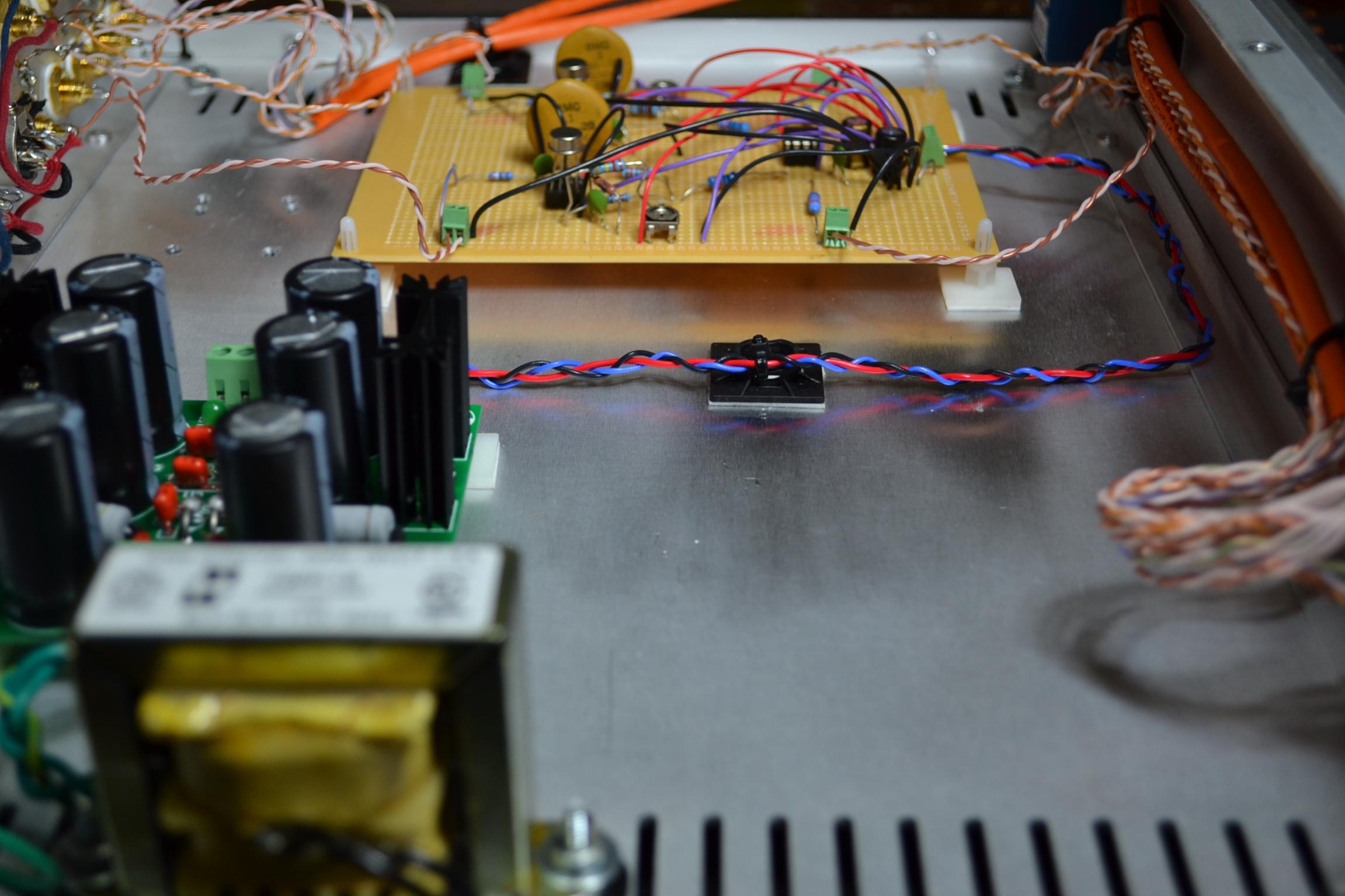

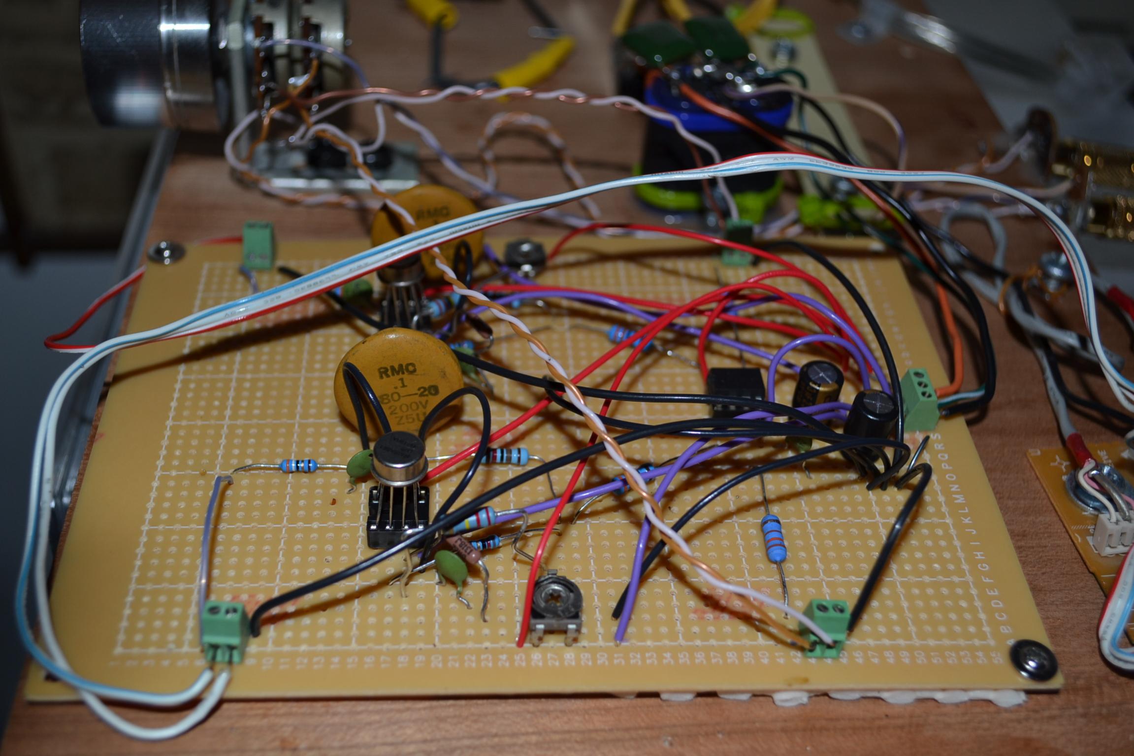

For tonight's progress, off the wood board unto the chassis. Sound is quite clean...tomorrow tie down the wires.

This is of interest, can you explain a bit?
Rolling off the frequency response using a cap across the feedback resistor depends on the opamps ability to cleanly operate well above the frequency you want the rolloff at. But the feedback itself is rolling off as you go up in frequency, so by the time you get up to several hundred kHZ, because the feedback has become small, the opamp may not be very distortion free, so it acts like an AM radio detector and generates sum and difference frequencies based on whatever Rf energy is coming in. The feedback necessarily rolls off (even without the cap added) because you need a "dominant pole" well ahead of any other rollofff poles in order to have good phase margin. A dominant pole appears to be designed into all opamps. Look at the open loop F response graph.
So a much better way to dump Rf energy coming in is with a passive Rf filter ahead of the opamp circuit, which is just an R in series and a cap to ground. A true nerd might also put ferrite beads on the incoming wire so then it's an inductor in series and a cap to ground. A 2 pole filter instead of one pole. I don't bother with the beads (maybe I should).
To design this filter you need to have some idea what the source impedance will be. If your source takes a signal from the plate of a tube, you can be way off on this, but virtually all other sources I know of will have an output impedance of less than 1kohm, so I design for that. Since series resistors can add hiss noise I prefer to keep the series resistor small. I usually go with 1k, which adds to the 1K source impedance from the point of view of the cap to ground after the R. So then you just calculate a cap based on 2kohms. Whatever input impedance to ground resistance the opamp circuit will have will create a "zero", which cancels the rolloff, so you want that to be as high as is practical. For a one pole RC passive filter the math is:
C = 1/ (2 times pie times F times R as seen by the cap)
Example: C = 1/ (6.283 x 100kHZ x 2kohms) = 796pF
So then you choose the nearest standard value which in this case is either 820pF (rare but I think they exist) or 1nF (very common).
If you choose 1nF, the actual -3dB point will be :
F = 1/ (2 pie x 1nF x 2Kohm) = 80kHZ
If the R to ground off the + input of the opamp (which this feeds) is 50Kohm or higher, this filter will be pretty effective. It would be more effective if this 50K was 1Mohm, but then you've got a 1mohm R making hiss noise. I usually use 50K there and believe it to be a good tradeoff.
This Rf filter is for signals coming into the chassis. I don't put one of these on each stage within a given chassis.
A series R at the final output of a preamp circuit, for example (usually 100 - 200 ohms) will make the opamp more stable (very important), and also form an RLC filter with the interconnect cable that goes to the poweramps, so it's good to be aware of how much capacitance that interconnect cable will have if it's very long. It will form another passive Rf filter itself.
