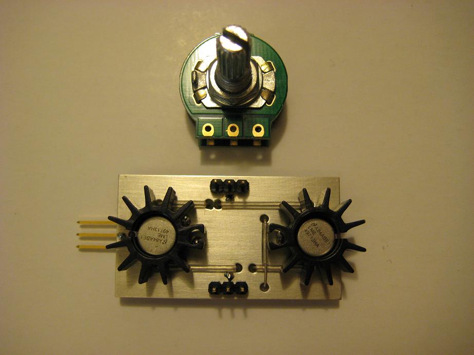

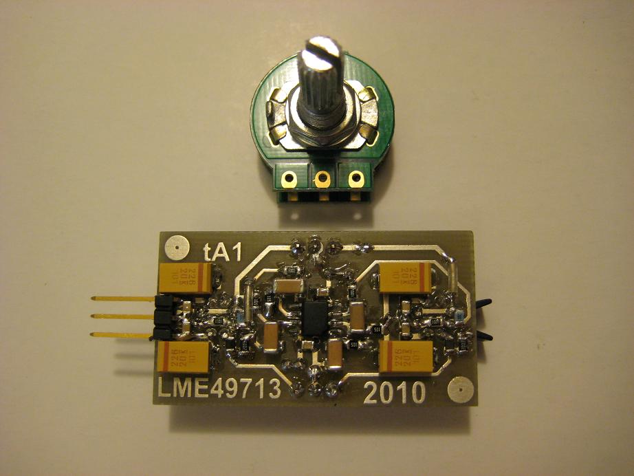

Whats about to use TO99 LME49713HA (two or more in parallel)?
One could drive about +- 100mA
http://www.national.com/ds/LM/LME49713.pdf
Done it. 😉
