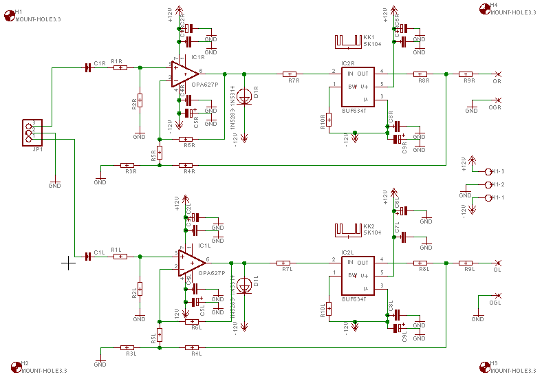

zdr Member Joined 2005 sites.google.com/view/dacgear/ 2012-05-06 2:18 pm #201 2012-05-06 2:18 pm #201 Gain is just right for me whatever it is - with FA-003 I am right on the middle with 10K alps. ••• More options Share J Jenyok Member Joined 2012 2013-02-22 7:12 am #202 2013-02-22 7:12 am #202 Could I use opamp preamplifier in "class A" for LME 49600 ? As is example, "class A" opamp preamplifier for BUF634. . Attachments buf634_class a.gif 12.2 KB · Views: 873 ••• More options Share Prev 1 … Go to page Go 9 10 11 First Prev 11 of 11 Go to page Go Show hidden low quality content Status This old topic is closed. If you want to reopen this topic, contact a moderator using the "Report Post" button.
