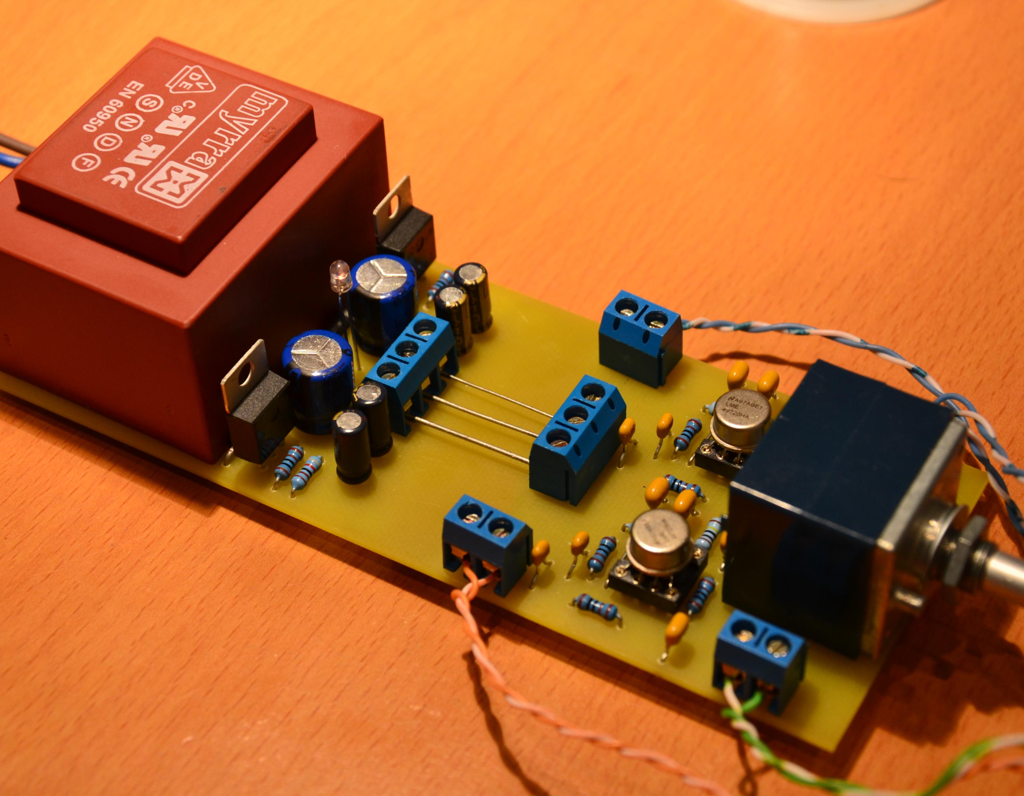

Did anyone try to build this eBay - New & used electronics, cars, apparel, collectibles, sporting goods & more at low prices ? their design used lme49710 + lme49600, or any comment?
Yes, I built that amp and wrote about it here:
http://www.diyaudio.com/forums/headphone-systems/206431-my-head-phone-amp-project.html
Jim's Audio boards are good quality in my opinion, with complete gold plating and plated through holes. The schematic as provided has way too much gain, but that's an easy fix.

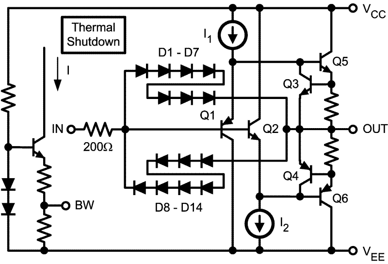

It would be fun to make discrete version of the this chip. It looks to me like a variation on the diamond buffer from Walt Jung.
