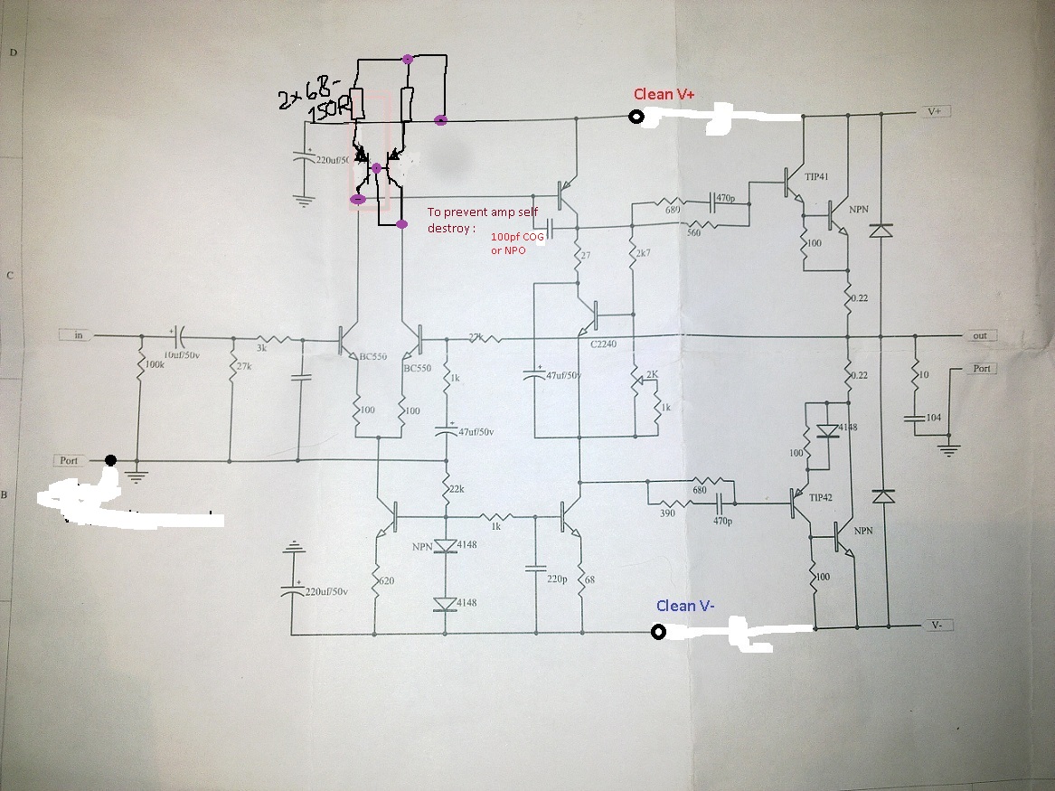

stabilization of the input stage
The mod shown below, what benefits in sound will be earned ?
Someone could try this with MPSA series BJT-s or BC556B.

I think D Self uses 22R for current mirror balancing. BCV 62 would be OK with that. Self isn't quite right about mirrors. The Vce is important and his intended results do not seem real world. To get rid of second harmonic distortion is not a typical Naim sound. If BCV 62 you could try a double mirror and no resistors. Fig 3, 4 transistors.

If one uses a single transistor without any degeneration resistor for the second stage, or VAS/TIS, then one only has ~600mVbe available across the load from the first stage.
If that load is a resistor, then it's easy to determine the load current and thus the first stage current.
When you replace that collector load resistor with a CCS, or mirror, the CCS also sees the same ~600mVbe.
If one adds a degeneration resistor to the CCS/mirror, then one runs into saturation of the CCS, i.e. it does not works as a good CCS/mirror. The bigger the volts drop across the degeneration resistor the worse this saturation problem becomes.
Now change to the added EF in front of the VAS/TIS. This is the arrangement in the Blameless and adopted by many since.
One has ~1200mVbe as the voltage across the input collector load.
Now you can add in the degeneration resistors to the mirror.
Some, including D.Self, use very low volts drops across the degeneration resistor attached to the CCS/mirror.
Other recommend upto 600mVdrop across the degeneration. But remember this ONLY works when there is adequate voltage to avoid saturation in the CCS/mirror.
rensli, I can't see why you would try to use a balanced LTP when the original is clearly intended to be unbalanced to ensure the 2nd harmonic distortion is prominent.
You'll wind up with a low-grade generic design by using a current mirror in the input stage of a Naim and whilst it will probably sound more clear and sharp, it won't be as pleasant to listen to. Both approaches to good sound quality have their merits but I think it would be better to simply build a chipamp amplifier if you want good results with that mirror arrangement in a Quasi-complementary design.
With tweaking experience, you can do better with discrete designs but it takes good skills with basic electronic design and hundreds of hours testing and listening to learn what it takes to get decent, "musical" sound quality from a particular design. You can't learn that from forum posts, so be prepared to study formally and do a lot of empirical experimentation for yourself.
I see your note about the dominant pole capacitor (100pF in your schematic) being there to prevent destruction. I guess that could be the case if it was too small but 100 pF is a heavy amount, depending on the capacitance (Cob) of the actual VAS transistor used. If you overcompensate, the sound quality becomes awful, rather quickly. So it pays to get this value matched to the VAS and its current source transistor. That's why you only need 39pF if the original ZTX653/753 pair are used. See the values on the NCC200 schematic posted recently.
Both Andrew and Ian make strong points. I was fogetting that the input current is a bit less than modern designs.
One thing you could try is a very small resistor in the VAS emitter. When I did this for a friend we used 47R and 0R ( 0R as now , TR4). That was to clearly show how it changes the sound. What you might notice is the sound becomes softer with perhaps more detail when 47R. The latter is hard to understand as from any point of view it should be a bad idea. What could be happening is the TR4 is when 0R a true TIS and when 47R a VAS. Many will prefer 0R as it gives more punch. My friend prefered 0R. Another friend much prefered the 47R. After that other values might be tried. 16R was one I used. My definition of VAS is Zin >3 times greater than the feeding resistor. If the transistor has gain of 100 and 25/icmA we have circa 300 R. If we have 50 R that is 5000R. 30R might be the transition point. It's not in any books and is just something to think about. I often wonder if so called slewing distortion is only the VAS or TIS compromise. No amplifier needs to be as fast as is suggested if sensible input bandwidth is used. 8 V /uS should be OK at 100 watts 6R. Some really dreadful 1960's amps can be transformed by simply adding an emitter resistor to the VAS. The worse example was Goodmans Module 80. The VAS had a diode in the emitter. Simply replacing it with a 56R resistor cured it's problems. Although the DC points were the same the IM distortion wasn't. The designer obviously thought a diode was better as a resistor would be cheaper. It was suggested Module 80 was a germanium design changed to silicon. It used an all PNP output of 2N2955. That is bonkers. The modified Module 80 with new caps where possible sounded rather good.
Curiosity in its human nature and You are all very right, that NAIM has its own approach to the sound. And i also was against that mod shown above, thinking that it will take the sound to a different level. Thanks for clearing that up.
The idea came from a buddy, who follow's D.Self Blameless Amplifier editions.
