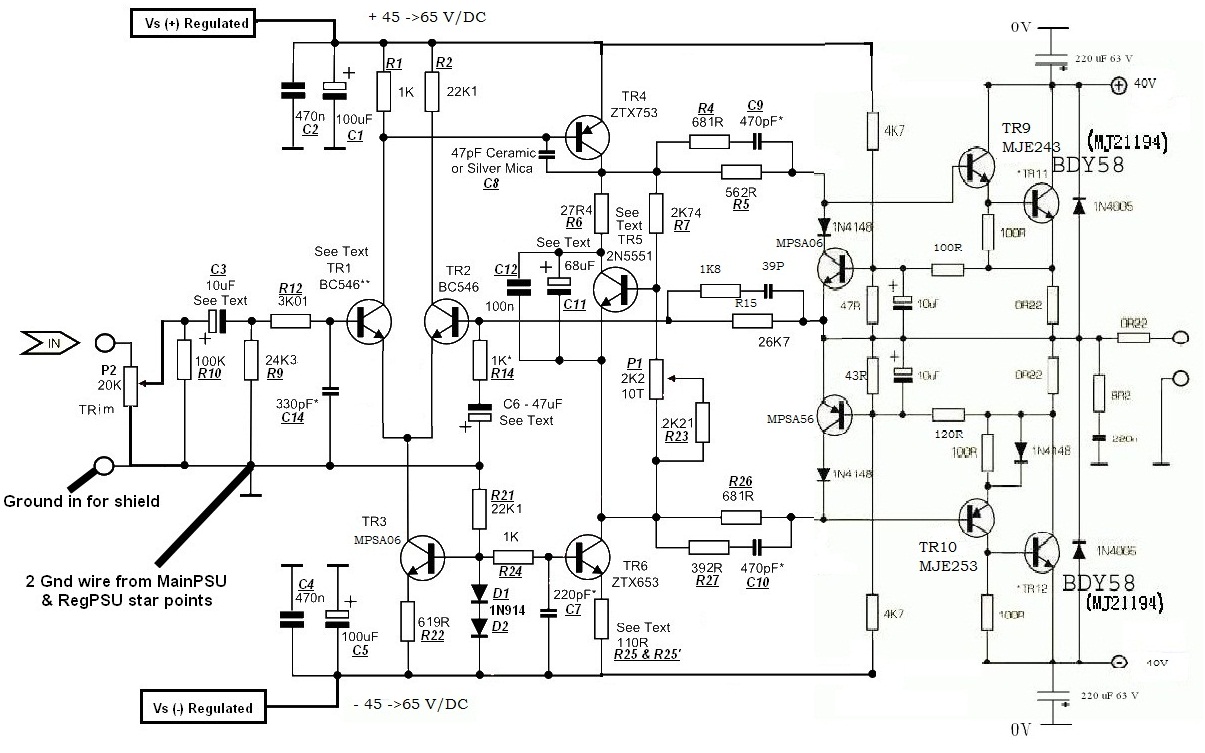

When I shorted the 22K TR2 collector resistor I observed marginally improved transient response behaviour - not enough difference to indicate that compensation is the reason for the resistor being there.
I suppose I ought to measure the distortion profile with and without the 22K, it would be interesting to quantify its effect.
My curiosity is over Ian Finch's supposition in post #1426 about selective cancellation of harmonics and others' comments about second harmonics.
Naim used some pretty savage test loads for their amplifiers so it would be interesting to see some results with your NCC200 with and without the 22k resistor on a 10 kHz square wave into 8R+2uF.
Returning to TR2 in harness with the 22k collector load resistor - The base of a transistor occupies a distance between two depletion layers separating it from the collector on one side and the emitter on another. The emitters of TR1 and TR2 are both connected to the same fixed voltage source and ignored there being no point of difference between TR1 and TR2.
According to E.M. Wolfendale in "The Transistor" the width of the collector depletion layer is directly proportional to the applied voltage.
We have around 30 volts at TR1 collector and 10.78 volts at TR2 due to the 22k collector load - it can be said that the collector depletion layer for TR1 is wider than in TR2 due to the difference in applied voltages.
When the collector depletion layer in a transistor is made as wide as practical the base is made increasingly narrower. TR1 fits this model.
If the collector depletion layer is decreased by lowering the collector voltage the base width is increased and more current can flow through the base junction.
As I.e, a fixed quantity =I.c+I.b, an increase in I.b. will cause a reduction in I.c. and the ratio of I.c./I.b. (current gain) will decrease regardless of the capability that spec sheets may indicate - say 300 for a BC546
We have this with TR2.

I felt compelled to answer Dave S ' question whether I was observing or speculating over his d.c. measurements. To answer this I looked into the unexplained but small discrepancy between the collector currents for TR1 and TR2.
Although some more measurements could be taken to confirm this, those recorded suggest a tenfold increase in TR2 dc base current in relation to TR1.
To continue this line, the 27k nfb resistor allows TR2 base dc current to flow to a zero point at the output , in addition to passing voltage signals from the amplifier output in the opposite direction. While this is a normal state of affairs there is a point of difference in terms of a tenfold larger dc base current.
There is an electrolytic capacitor in the decoupling arm of the nfb network. In a single supply rail amplifier this capacitor would have a decent voltage on the positive connection.
There is a parasitic non linear resistance in series with the capacitance and amongst other things the value varies with the voltage applied, temperature is another - a possible reason for Naim recommending their amplifiers be left on at all times.
A constant dc voltage across the decoupling capacitor seems more likely with an increase in TR2 base current.

I'm posting the schematic again as a reference to what this is about which is the trick of imbalance of the input stage. I've done some quick and dirty Spice modelling in TINA and come up with a few relevant DC currents there that may interest mjona. Not that they can't be calculated but this is perhaps easier if more is required.
Note that I cheated and only the input stage and VAS were modeled, the output stage being disconnected and feedback taken directly from TR6 collector via the same 27k feedback resistor. As modeled there is just 0.5 uA there and I used BC550C and MPSW92/42 models as appropriate. The currents listed are those in the associated resistors which unfortunately aren't numbered on the schematic. It should still be easy enough to see what the DC conditions are and what degree of imbalance is likely.
- Rail supply voltages +/- 40V
- TR1 collector 0.743mA, TR2 collector 0.181mA
- TR3 emitter 0.982mA, TR6 emitter 7.6mA

I think it shows that simulation has its limitations and that measurements of a real circuit and prodding around with a meter and a scope are much more useful.
