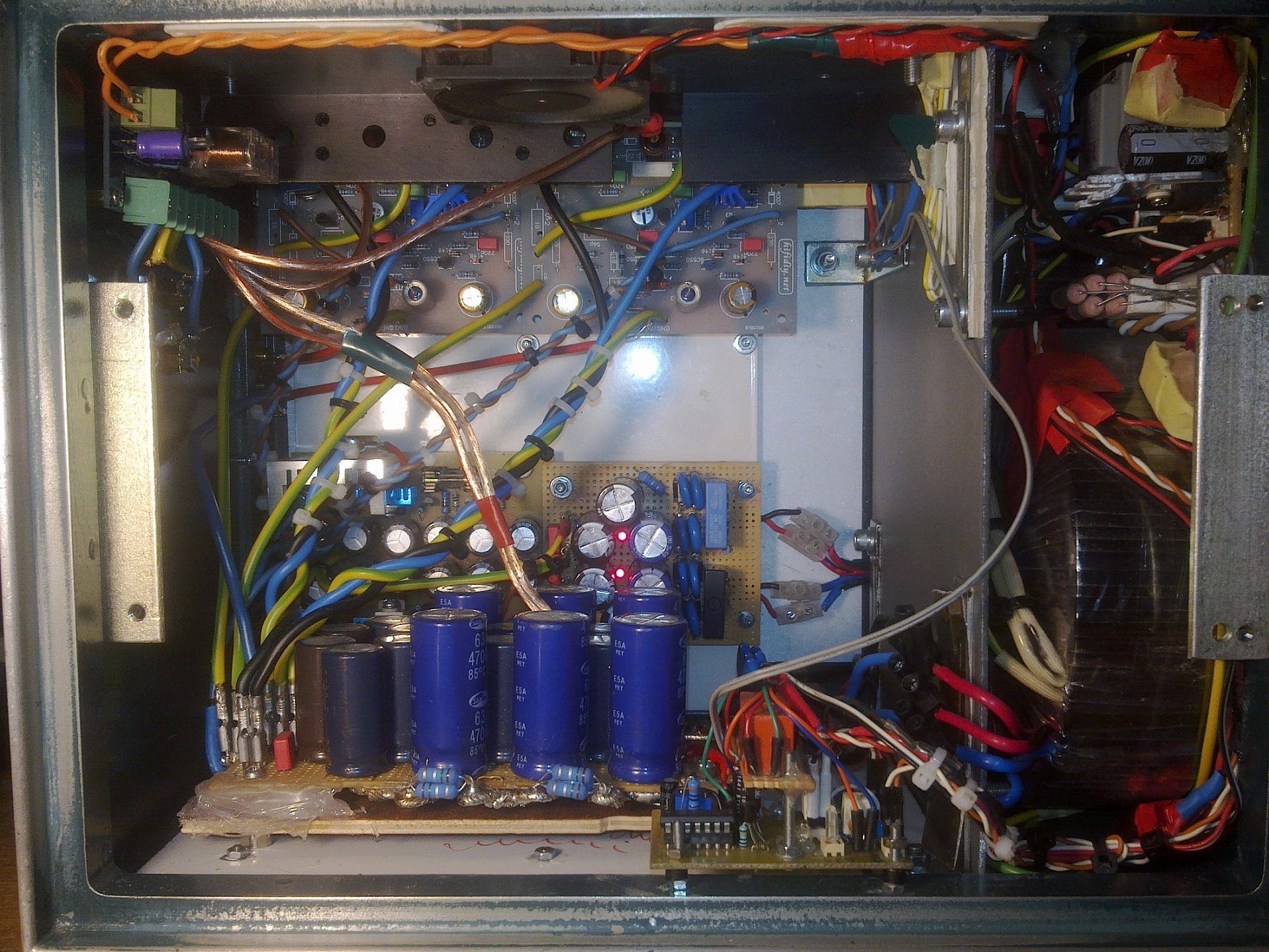

Well, i must admit... the amp i have build is not a "H.140 clone" anymore, i belive its original now and what the NAIM really sounds like 😀.
Have been listening to it every night from my previous post.. torching them @ high volumes @ all sorts of music.
Last mods what i did somewhere in the middle of JULY.

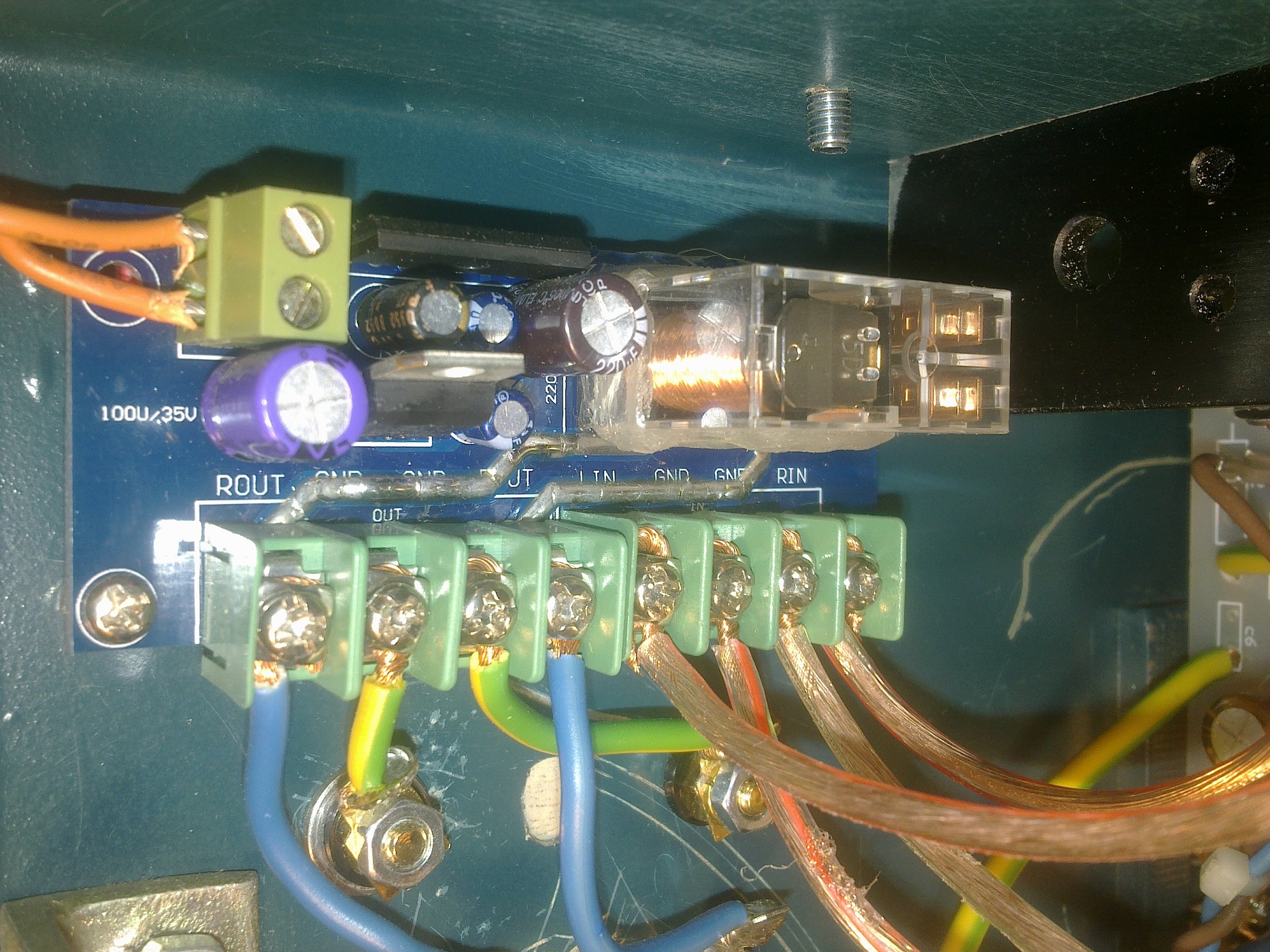

Also Removed the 1nF capacitor that was between input RCA shield and AMP metal case(EARTH/GROUND). From that time i have never heard any mobile dialing sound from the speakers. Before that it was still getting throught.
The RCA input shield are connected together right @ the input and then 1 wire from that point to 0V PSU GND.
AMP 0V PSU GND IS NOT CONNECTED TO EARTH!

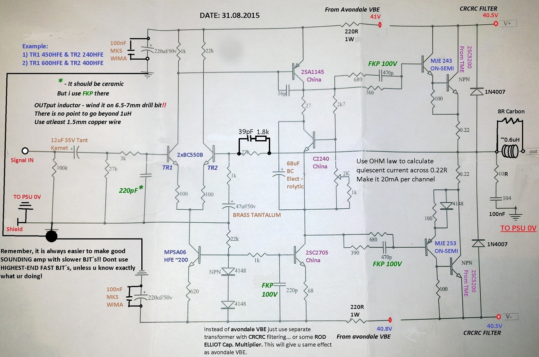

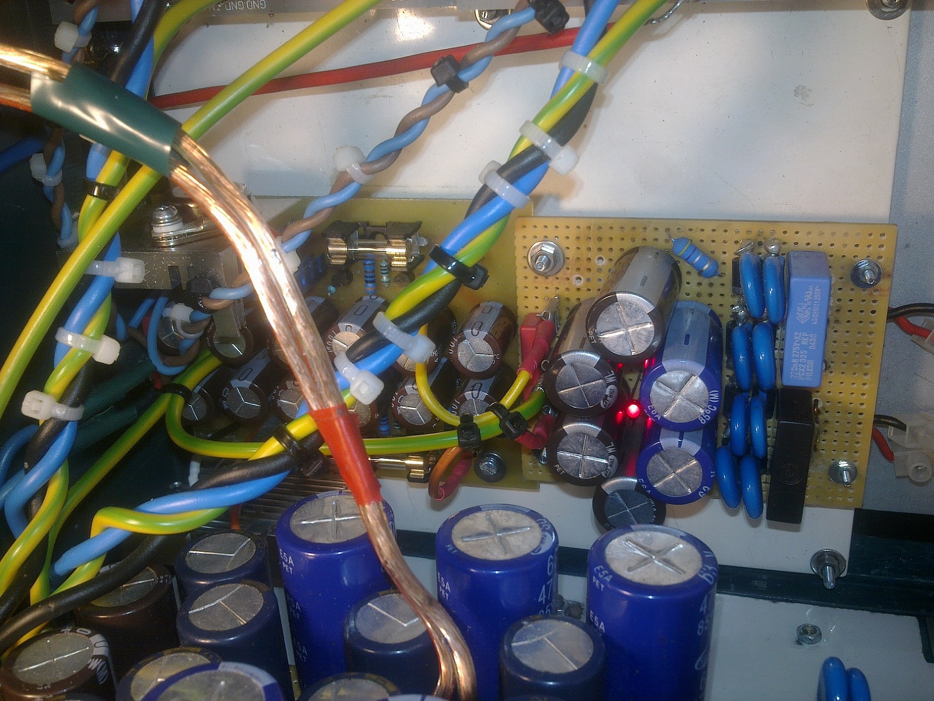

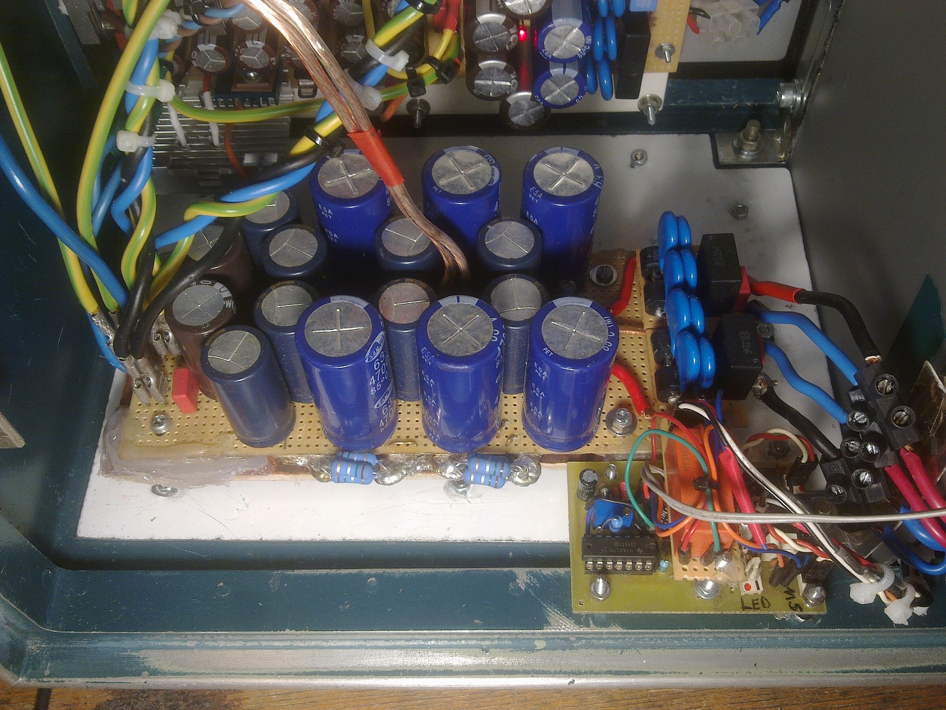

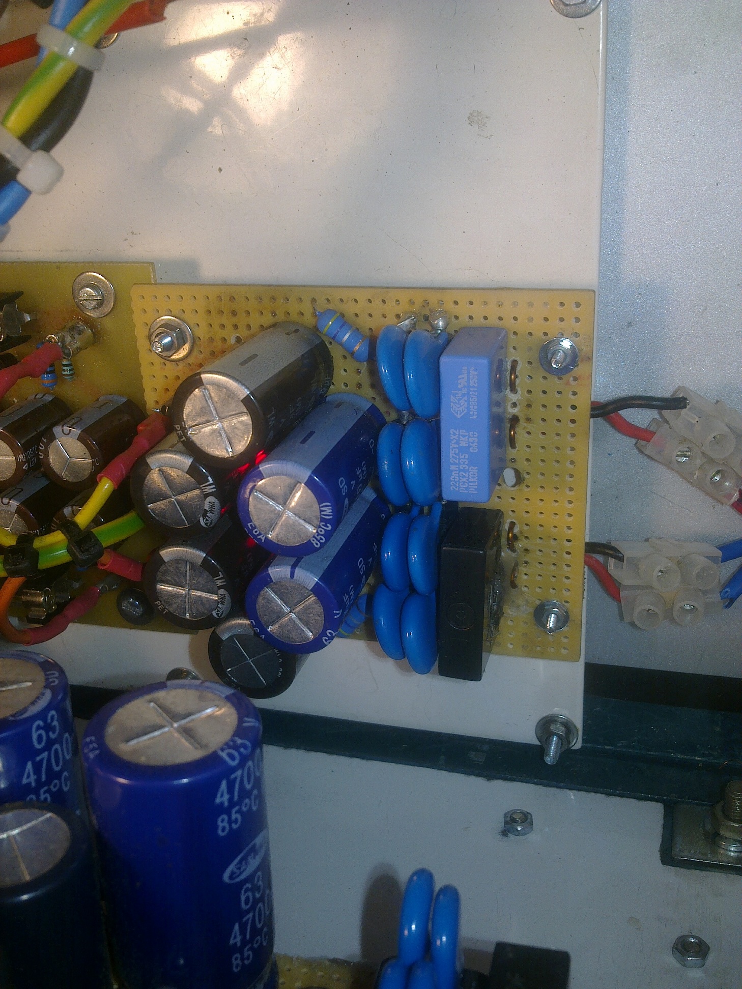

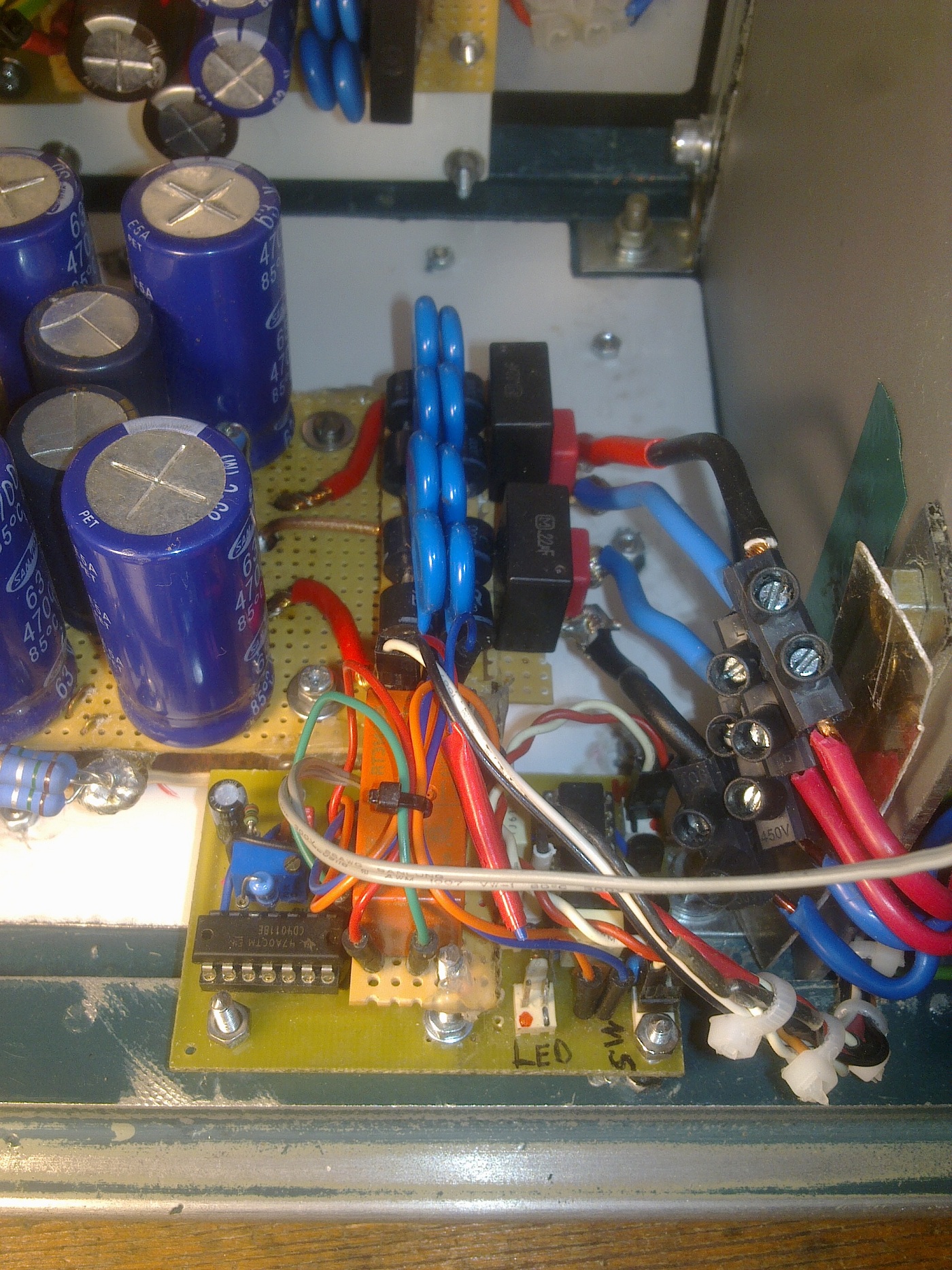

I finally removed all FILTER-CAPACITOR BANK series Inductors(CLCLC)...and replaced them with low value resistors:
- MAIN FILTER CRCRC (R= 50mOHM) Total: 100mR per rail i
- VBE FILTER CRCRC (R= 470mOHM) Total: 940mR per rail
- OUTPUT Inductor 1.5MM copper, 0.65uH paralleled with 8OHM resistor.
- MILLER CAP = 56pF 100V NPO directly on BJT legs.
- Still using MPSA BJT @ CSS instead of BC550
- Still using MJE24x @ Drivers instead of TIP4x
- Still using European TME warehouse 2SC5200 output transistors
- All Ultra Fast recovery diodes are replaced with standard low cost 10A Diodes and each one of them are bypassed with 10nF
- I made sure all the transformer secondary polaritys are in good order
- Finally, Twisted all the wires together - GROUND/+/- to each board
- Twisted front end wires together + and - to each board.
- Input cap now 10uF Tant, Feedback to ground cap BRASS TANT and CE bypass cap is now BC 68uF electrolytic <-- this way amp sounds bright. Adjust caps to your Taste please.

- I highly recommend using MJE24x series drivers only with SLOWER CSS BJT, for example: MPSA or low HFE BC transistors. <- Forbidding that rule will lead you in a disaster !
- Also, i would not use 500VA (rectified 41V DC) transformer in my next 2x80W amp build, too much power is lost into heat @ extreme volumes 😀
- And about the inductors in CLCLC config. I recommend to not use inductors in PSU unless you know what you are doing(impedance calculations, damping, frequency behaviour and so on).

I forgot to say that i mounted the OUTPUT INDUCTOR right at the PCB output, again 😀.
Its not easy to do it, pcb layout and feedback traces must be modified.
That way i am sure, nothing passes throught the speaker cables into the outputs.

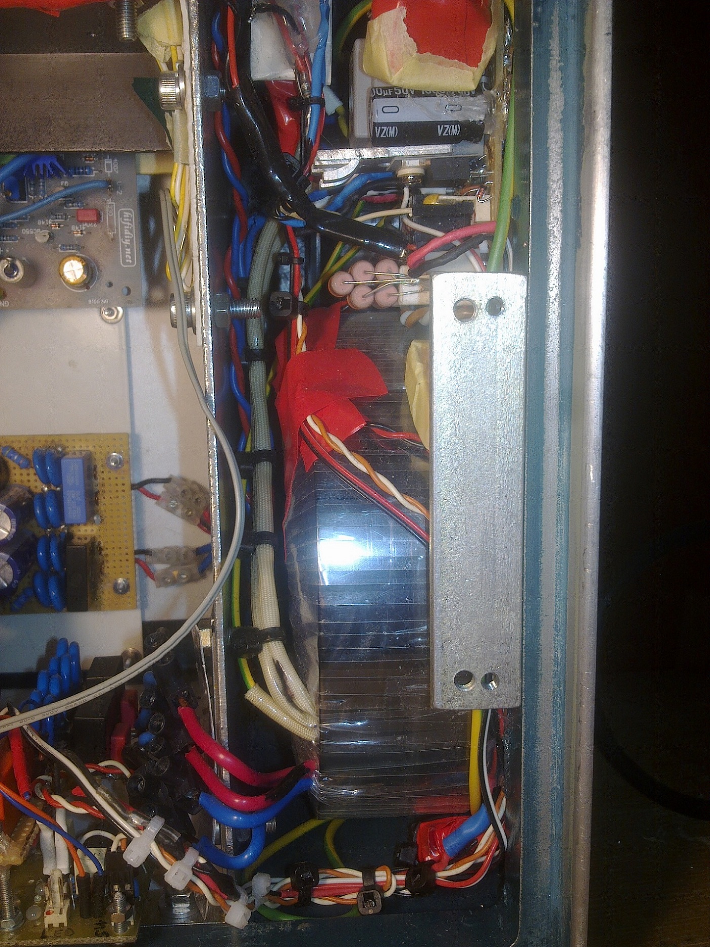

On 8 and 9 picture u can see the output inductor... its not touching the heat sink or any other metal parts anymore.
NTC that is closer to BJT is soldered directly to a copper plate 😀 And then mounted with 2 screws like all the BJT-s for better surface contact. It is mounted without any insulation and seems to sense temperature extremely well(resistance variation starts after ~ 4 second when i put a warm hand on the radiator fins).
As u can see no ventilation holes in AMP section except the FAN that is sucking air throught the back of the Xformer section to cool down a 4x Xformers and LM317 regulator 😀
Schematic comes tommorow.

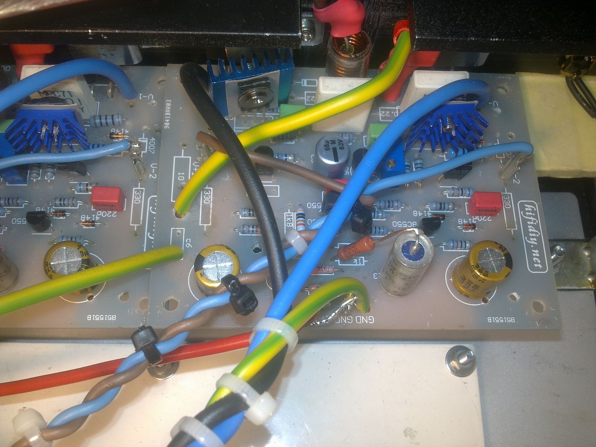

- Zobel network is taken directly from emitter resistors junction point to minimize copper trace lenghts.
- Input Tant capacitor and some of the other circuit parts are under the PCB´s.

Thanks for sharing! You are one of the few who build this kit and care to share their experience. Most people disappear once their problem has been solved 🙂
I think you found experimentaly, like many, including me, that this amp doesn't need fancy tweaks. Your only deviation from the original seems to be the output inductor. Maybe later you'll remove even that 🙂 ... I did.
About the bias current, you are right there. 38ma is for the whole amp and 20mA is enough for the output transistors. This link tells all that needs to be told about relationship bias/distortion:
Naim, NAPs, Naits, distortion and bias-current settings
One little detail about the feedback that may be important... I am sorry if I repeat well known stuff...
You should take the feedback from a point that carries only the current going out to the speakers. That's the only current that must be corrected by the feedback. This means that your feedback connection must be at the very input of the inductor (in your case). This inductor must have some short single path that is not shared with any other component. Many of the kit boards are not correctly designed for that and take feedback from different common places, e.g. between the emitter resistors. Thus, the feedback introduces errors, because it takes care of stuff that never leaves towards the speakers. I hope my explanation is clear enough. This is valid for all amplifiers with feedback, and is not unique for these clones...
Regards
Regards
Hi Ruwe,
My pleasure, just want to make next builders/DIY-ers life easier!
Yes, if you take feedback from the right place, than you got urself better distortion numbers. Its a small fraction but still..D.Self wroted it somewhere.
This is my current setup: DC offset around ~5mV on each channel,
Enlarge for better view

The capacitors blue of the axial type that can be seen in the photos are valid PHILIPS BC 021 1000uF 63V, in parallel to the last capacitive branch of the power supply for both the branch of positive voltage which for the branch of negative voltage.
And their presence right next to the power transistors, although it might seem trivial, ensuring immediate availability of energy unmediated parasitic inductance of the cables connected to the stage of power, brings sembre of beneficial effects on the overall musicality.
I will treasure of your information !!
Indeed it would. And you would have to reset the Cdom (Miller compensation) to ensure stability.
Note the imbalance of the LTP.
R1 passes ~0.6mA and drops ~0.6V
R2 passes ~(2mA-0.6mA) and drops ~31V
T1 operates with Vce~40V & Ic=0.6mA, Pq ~2.4mW
T2 operates with Vce~10V & Ic=1.4mA, Pq ~14mW
Hardly qualifies as a long tail PAIR !
I corrected it for you:
Note the decent balance of the LTP.
R2 passes ~(1mA-0.6mA) and drops ~9V
T1 operates with Vce~40V & Ic=0.6mA, Pq ~24mW
T2 operates with Vce~30V & Ic=0.4mA, Pq ~12mW
Qualifies as a long tail PAIR
Here are the measurements from one channel of my NCC200:
Note the excellent balance of the LTP.
R1 drops 0.499V therefore passes 0.499mA
R2 drops 10.78V and therefore passes 0.49mA
T1 operates with Vce~40V & Ic=0.5mA, Pq ~20mW
T2 operates with Vce~30V & Ic=0.5mA, Pq ~15mW
Definitely qualifies as a long tail PAIR even if we include the negligable effect of the VAS transistor base current.
