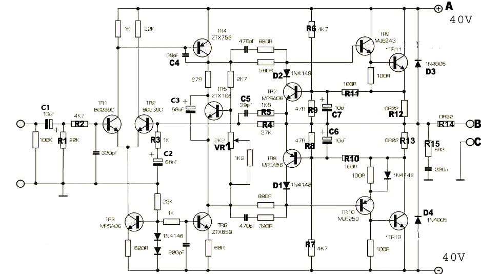

This isn't a good move IMHO. TR4/6 make up the voltage amplifier and its ~ 6 mA current source which requires high and linear gain across the full bandwidth whilst swinging virtually +rail to -rail voltage. That requires low Cob (base-collector capacitance) and there are not many transistors that can handle this duty with low capacitance or rather, that particular design capacitance ...... I notice that TR4 and TR6 seem to run hot, not sure if that is ideal or beneficial for long life, they say 2SB647 and 2SD667 on them if that is to be believed. I have 2SC5171/2SA1930 I could sub for them, they are TO220 so I could also fit small sinks. Good move? I think I have some ZTX/653/753 at home but I'm about 5 weeks away from another visit and there's nothing at all available here in the desert....
My experience with these various clones and the original product are that the sound quality is largely dictated by the purposely off-balanced input pair TR1,2 and the VAS, TR4/6. Pay attention to these arrangements as designed and you get the best compromise of sound. You could also build this as a straightforward amplifier but those I've heard modified this way tend to be lacklustre and there are much better designs for messing about with.
Other transistors like the drivers you suggested may 'work', but not ideally. Since the Cob capacitance is a part of the frequency compensation capacitance, high frequency gain and stability are dependent upon the choice of TR4 so one needs to be particular about it. With C4=39 pF, ZTX653/753 with Cob 30pF, are still best match. 47pF usually sounds better with 2SD667/B647, depending on the source, which with Ebay kit sellers and their dodgy parts, is never certain. Otherwise, leave the supplied parts as is until you get you have the original types, if you want to try them out.
Yes, even the larger case 2SD667/B647 will run hot - ZTX types will be hotter still but they can handle it as long as the heat is not due to instability or assembly errors. Mine don't reach 60C, which is still OK but obviously depends on ambient temperature.

Is the schematic you posted the schematic of a Naim amplifier, or just another clone?
I'm interested that you comment the sound quality is largely dictated by the unbalanced input pair and the VAS.
The input pair unbalance is seen in my boards as with the schematic you posted. so hopefully even with different devices BC546B as opposed to BC239C much of this remains. So far as the VAS is concerned I've tabulated the fT and Cob of the 6 devices in the picture. Maybe these are not the only parameters that affect this position but so far as these parameters go the 5171/1930 do not seem so far from the 667A/647A.
I don't see an order of magnitude difference here. Maybe it's more subtle.

and yet a highly recommended VAS transistor is the 2sa1360.
Cob typically 2.5pF @ 10Vce, the NPN is even lower @ 1.8pF.
But this is a 5W, 50mA device.
So way lower than the ZTX devices! Wouldn't that "change" the character again?
Indeed it would. And you would have to reset the Cdom (Miller compensation) to ensure stability.
Note the imbalance of the LTP.
R1 passes ~0.6mA and drops ~0.6V
R2 passes ~(2mA-0.6mA) and drops ~31V
T1 operates with Vce~40V & Ic=0.6mA, Pq ~2.4mW
T2 operates with Vce~10V & Ic=1.4mA, Pq ~14mW
Hardly qualifies as a long tail PAIR !

If you read through the thread, you'll see much the same schematic, and similar comments about the older and unusual components, circuit tweaks etc. recurring as new builders post here. The design harks from the 1970's and used components that were considered top-notch then. The above circuit diagram is the Generic Naim Schematic which once applied to all models, with minor variations, bridging etc. It's been retouched here and there, since the original scanned poorly. (See Acoustica.org website)
Despite the fact that the design is tweaked and far from technically correct, as AndrewT's numbers show, it does benefit from better input stage transistors than BC546/56. BC550C/60C are close to original types and will prove lower noise and probably easier to reduce offset if necessary. All the wonder parts in creation won't save a noisy input stage, which seems to escape the attention of many who instead, waste heaps on very low noise resistors. Note that the Japanese part number transistors have different pinouts to Euro (pro-electron) types - a deterrent to swapping the small parts willy-nilly.
Apart from not needing oversize parts to make them to run cooler, trying to squeeze TO220 parts with different pinouts into the TO92 size footprint is surely a bad idea. If you are using high rail voltages because of opting for 30VAC transformer windings, you will probably have troubles with other parts of the circuit too. 43-45VDC rails are too high if you use the original design. You can certainly substitute higher voltage parts and add heatsinks but the final result may not be what you were hoping to hear, as said earlier. The ZTX series parts offer the better sound (even the commercial clone NCC200 by Avondale Audio retains them) but you can get the supplied parts to work almost as well by judicious (you may need a 'scope to see any oscillation problems) adjustment of the compensation cap.
Otherwise, Ft and Cob are 2 sides of the same coin. There are other issues like gain linearity, early voltage and so on to consider for VAS performance too. I don't mean technically best performance - just appropriate to the task of sounding something like the original. You may not be looking for original sound but I suggest the options aren't actually very good. I've tried a lot of variations on the Naim and have never been satisfied, always concluding that it would have been better to start with a simpler, clean sounding conventional design.
BTW, TR4/6 parts supplied with the kit are not genuine. Hitachi pulled out of making semis when they joined with NEC to form Renesas many years ago, so the "Hitachi" logo mark on larger 2SD669/B649, is a look-alike fake and there are buckets of both pair types available cheap on Ebay. I've measured Ccb (Cob is calculated) varying between 12pF and 32pF over a few years, so don't put any faith in datasheets without real measurements there. It will get quite confusing if you start out by redesigning with bad info.

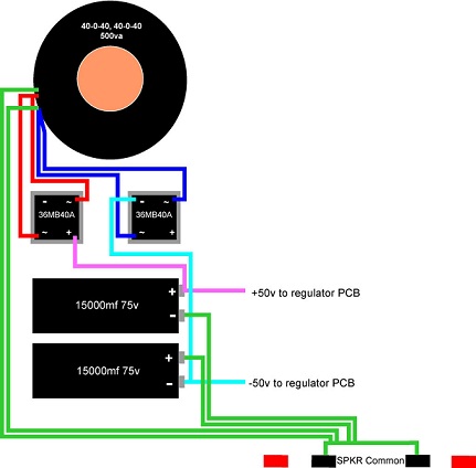

Note that separate transformer windings must be connected "in phase" (shown by the solid dots) to get any usable AC output for use with a single bridge rectifier. Everything else about dual secondary windings connected in series, will effectively be the same as one tapped secondary winding.
