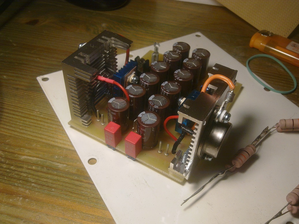

Finished front-end regulator PCB, the schematic of AVONDALE's the one you can find few pages back.

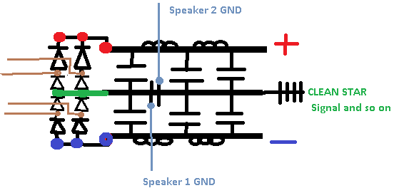

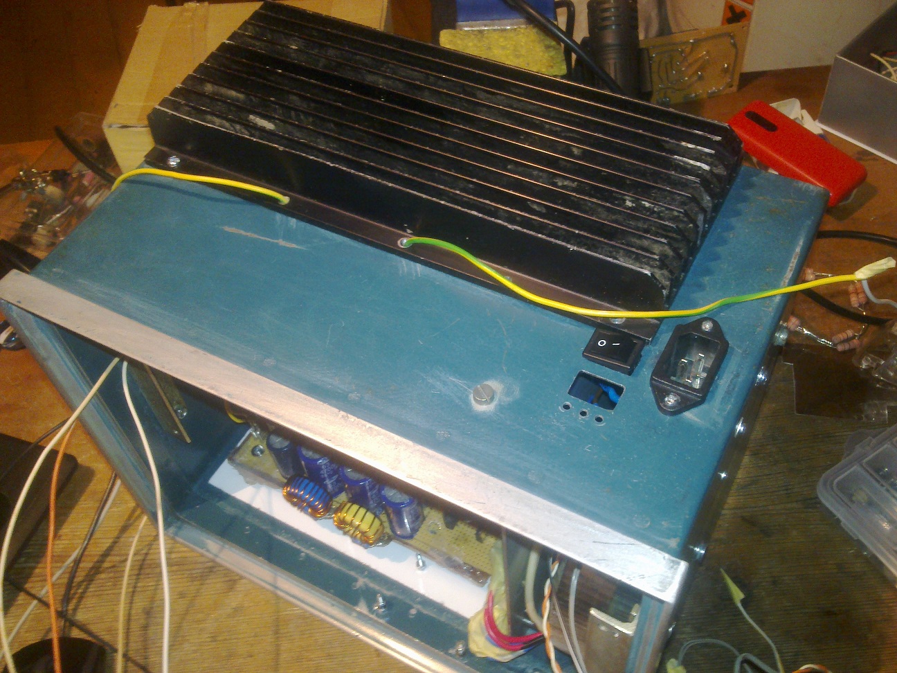

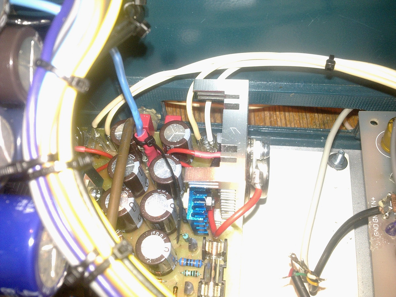

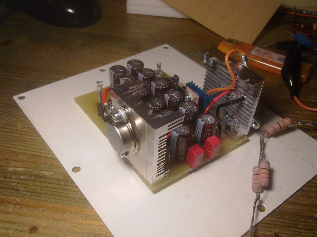

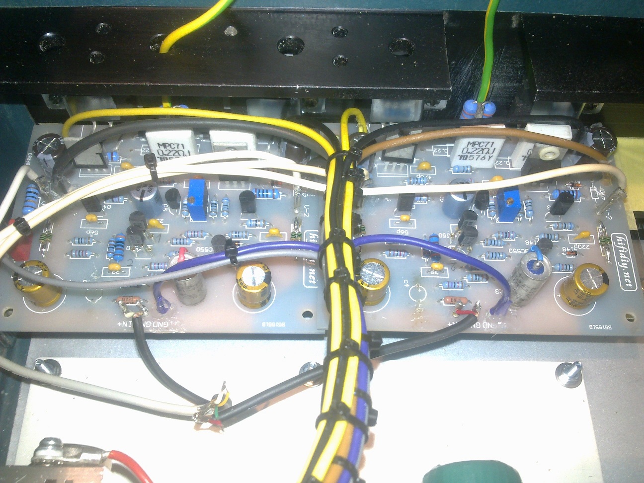

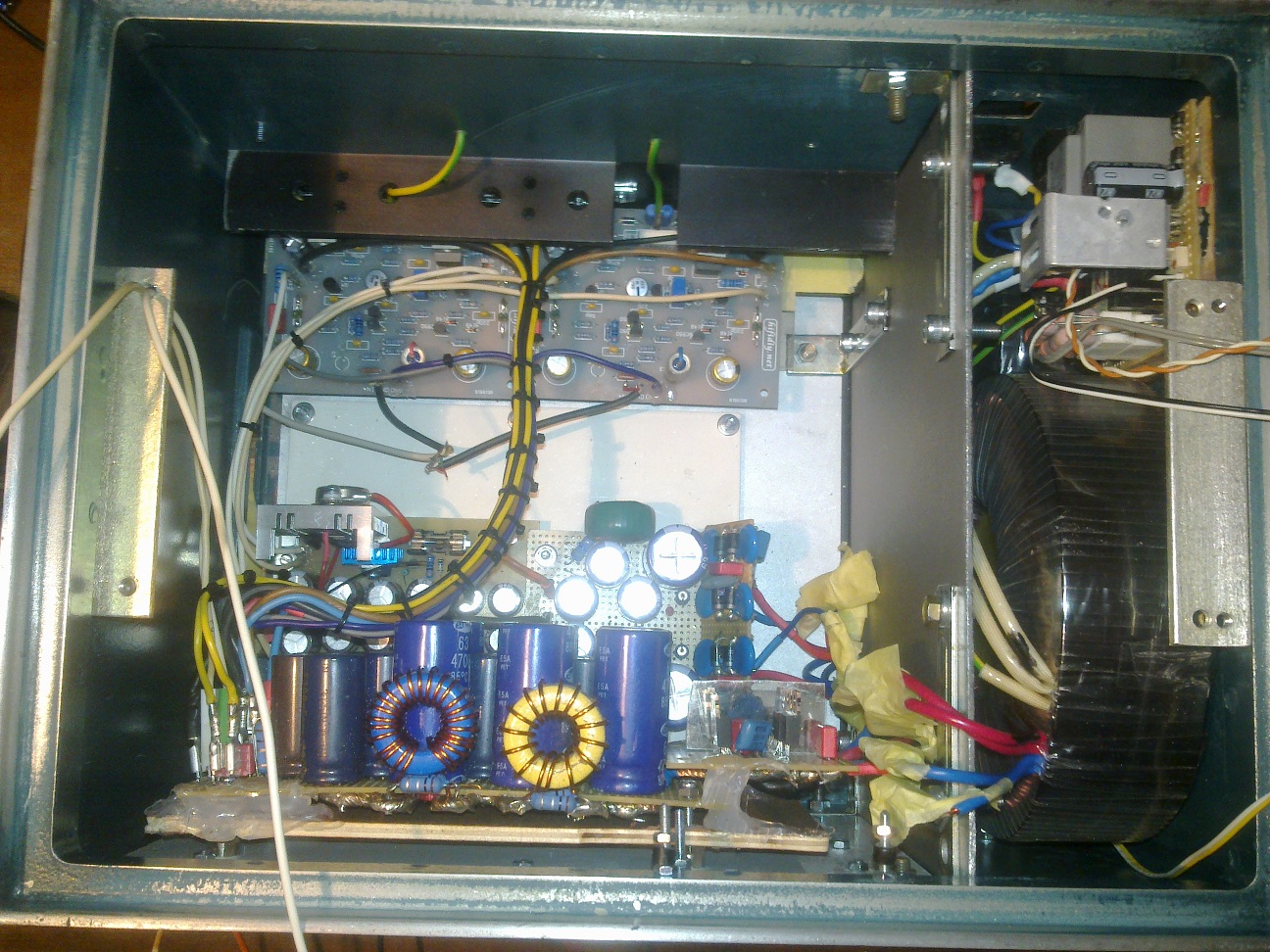

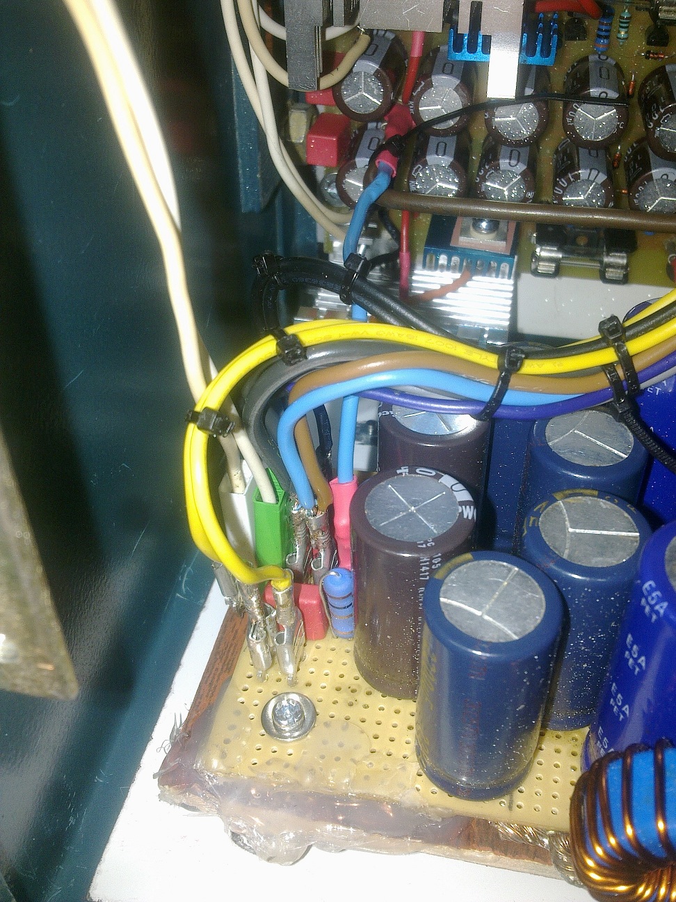

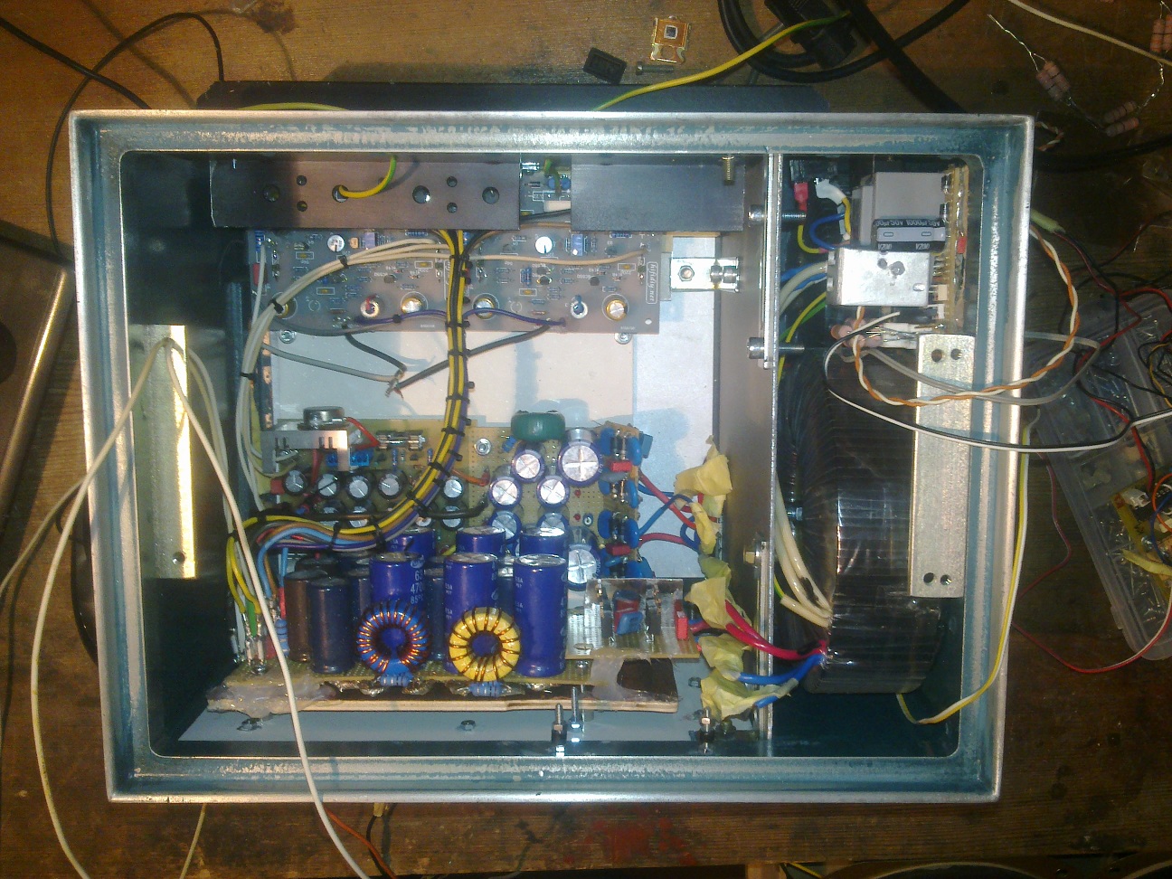

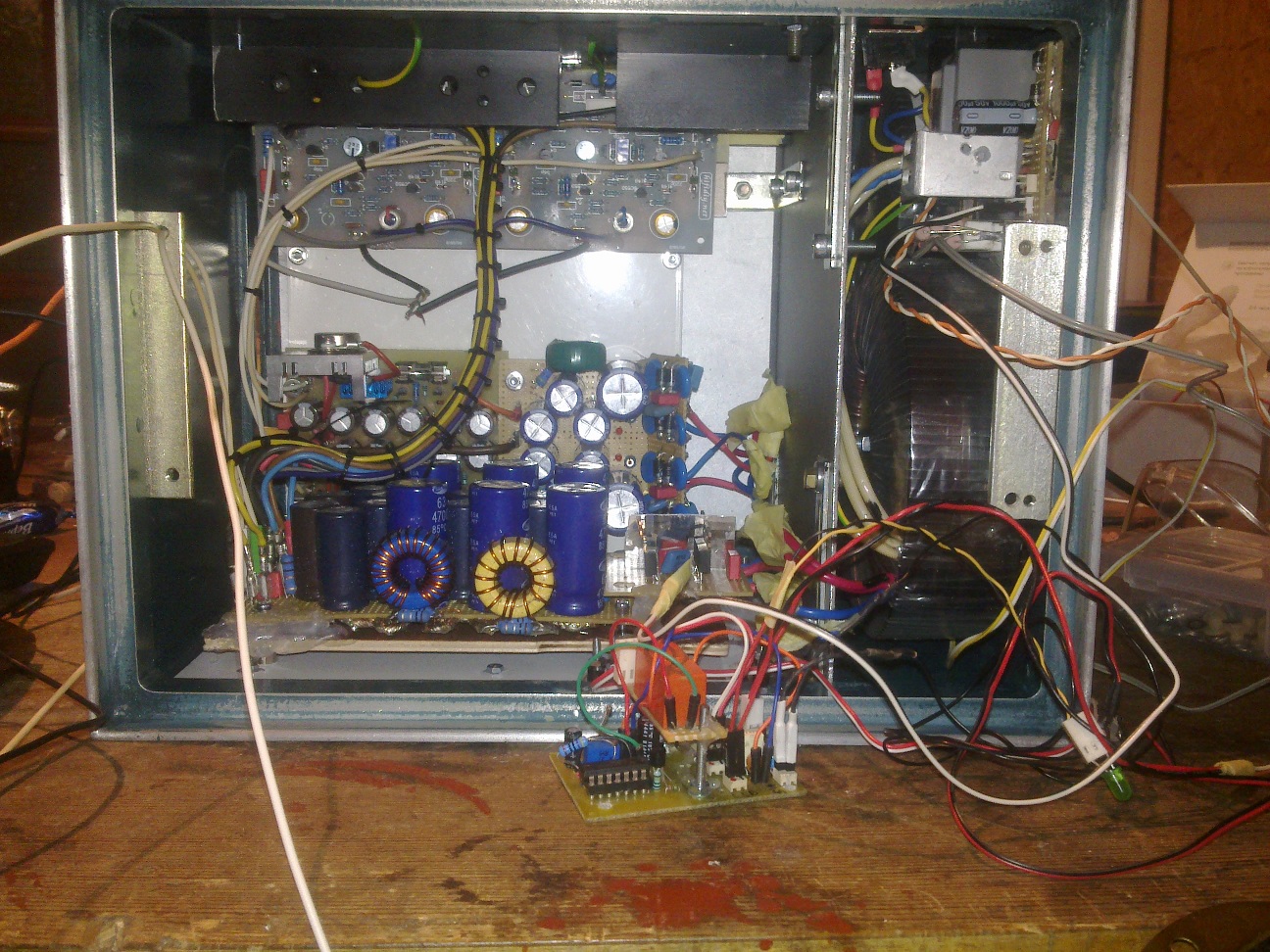

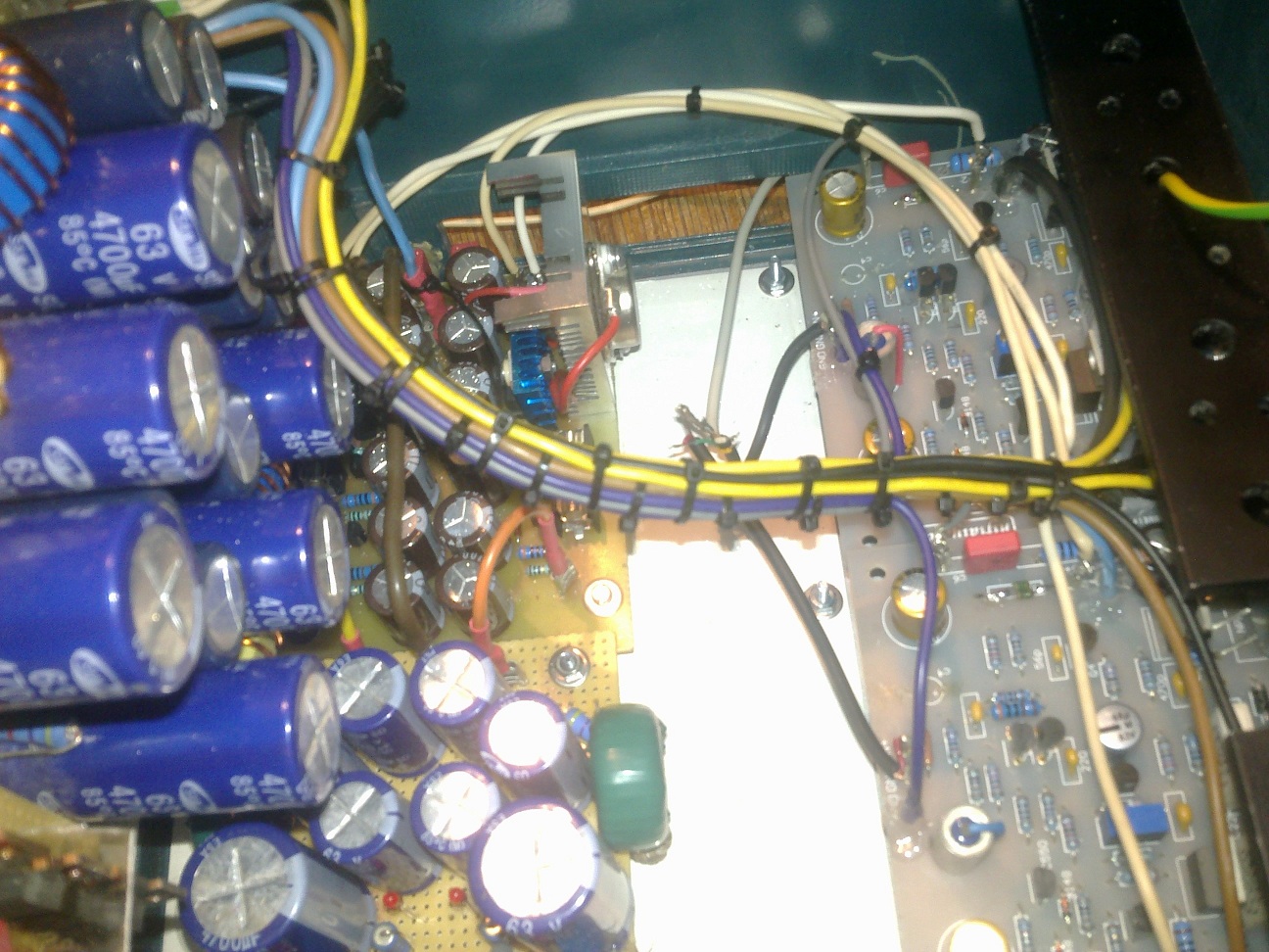

Half finished H-140 with the Avondale VBE from 51V DC regulated down to +/-41V DC, feeding Front End.
Outputs have they own PSU from OVER-SIZED capacitor bank +/-40V DC.
All GND-s are star-grounded to heavy ~10AWG copper wire beneath the PCB, hookup is seen on pictures.
All the wires are 18AWG taken from computer PSU...are these sufficient enaugh to deal with variable currents and not introduce side-effects to the sound ?
Decoupled the naim 2SC5200 outputs with 220uf 0.12OHM ESR capacitors, each cap has its own wire back to the STAR-GND.
Added output resistor instead of a COIL+Resistor Combination, used there 2x330mOHM 3W each in parallel to get desired ~170mOhm resistance on each speaker output. Will this ruin something in the sound ? Looked up the original naim schematics and they are using 0.22ohm there...will that resistor save the output transistors if shorted for a short period of time ? The temperature controlled on/off switch will be introduced as a last peace of work into this project.
About HUM, in fact, there is no such thing on the left channel, all i hear is nothing when i short input signal to ground. Right channel has something there (HUM), barely hearable, its probably caused by a speaker groundwire that was crossing the 500VA transformer.
Is there something wrong with the way the wire's are wired ? Don't have any good quality speakers yet... cant tell nothing in terms of sound.
This thing will be completely dismounted to ensure that EARTH to CHASSIS connection will last, i am still kinda skeptical about 18AWG wires, would it be pointless to use 16AWG instead ? .

Regarding of using computer 18 gauge wire, it is O.K. to reuse. But watch out for cheaper computer power supply using aluminum wire. They do not sound same as copper wire.
Yes they are copper (nickel or brass plated..😀) but the copper is seen in each core if wire is cut in half(copper is visible from center of a core).. they are a little harder to solder too but that's not much of a problem.
BTW, is it worth grounding amp's STAR-Ground to the EARTH Chassis at the "Chassis STAR" where the mains and x-formers earth connection presents ? Last time when i have done that made things worse, from an oscilloscope there was some high AC spikes at amp's outputs 😀 This could be heard even when attaching the Ear closely to a Speaker, barely but there was some high frequency signals in a completely random pattern....

Upon close inspection of your picture, you are using the kits from Aeon.
Same as me.
For that kits, I remove the front-end decoupling capacitor.
Make sure it does not oscillate again.

Changes i made:
Basically H-140 audio ebay kits are NCC200 clones, changed the front end input resistors from 330ohm(china schematic) to 220ohm(NCC200), they form a filter with 220uF electrolytes, kept the electrolytic's in place !
Re-wired amp with a ~14AWG copper wire i had laying around without isolation, had to dress them separately 😀 14AWG for everything except signal and output decoupling caps.
Removed the output 170mOHM resistor, instead of this soldered a 16 turn 1.3mm wire coil with 15OHM resistor inside it !
Finally, connected SPEAKER GND-s to the dirty STAR GND.
Turned The Thing on, WOW, sound is so much different, everything feels more separated, fine pleasure to the ears with crappy speakers 😀
To me, good impact on the sound is behind the Inductor(Y)
Speaker dirty GND connection schematics:
