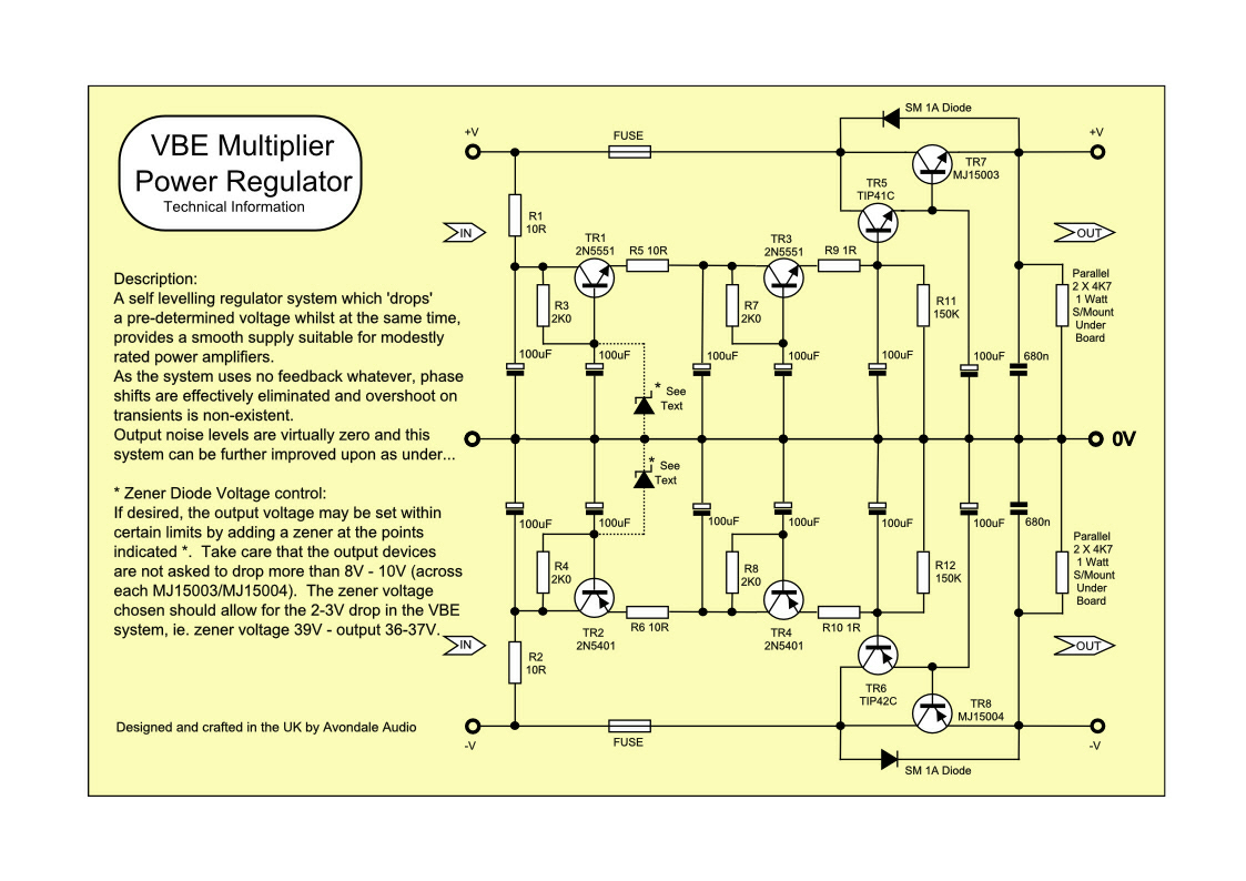

Try multiplier No1. It is all you need. Make a PNP version for the other rail.
Capacitance Multiplier Power Supply Filter

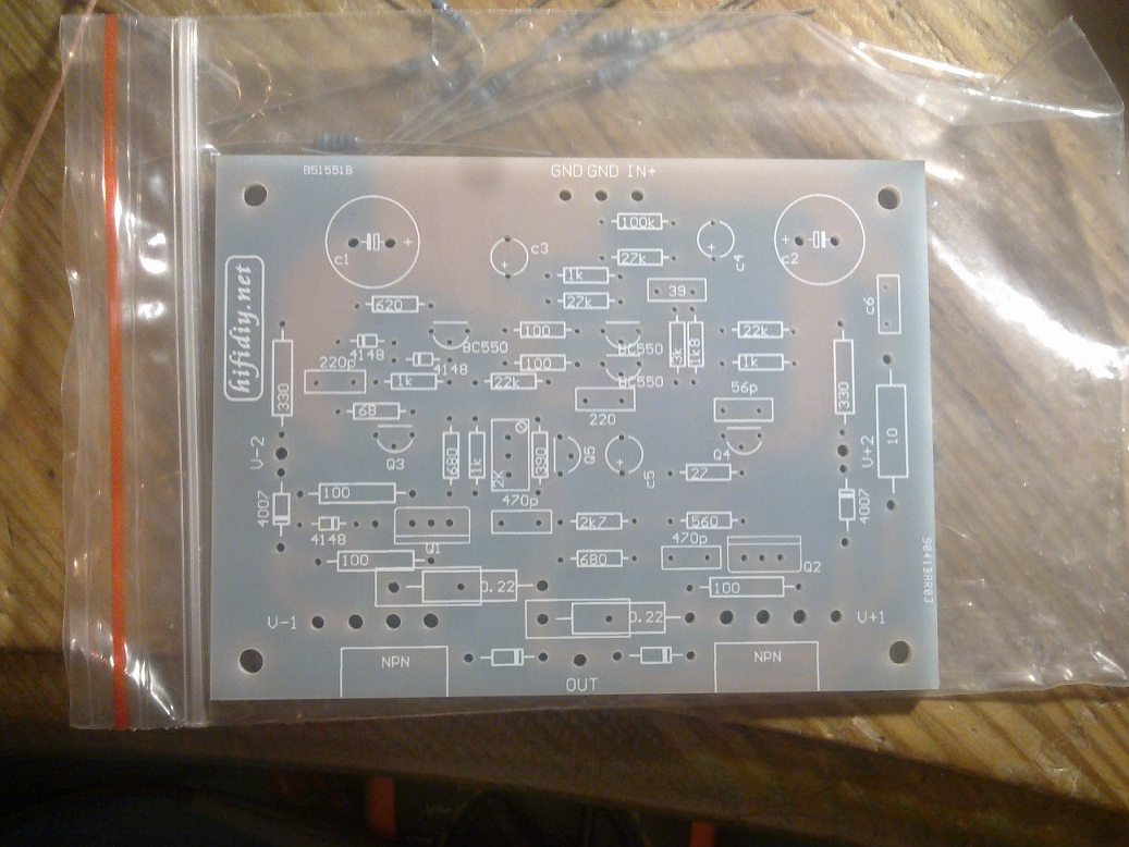

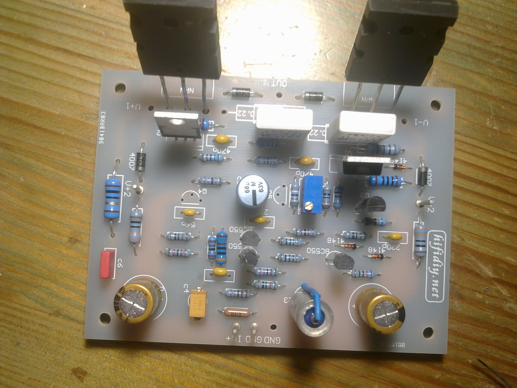

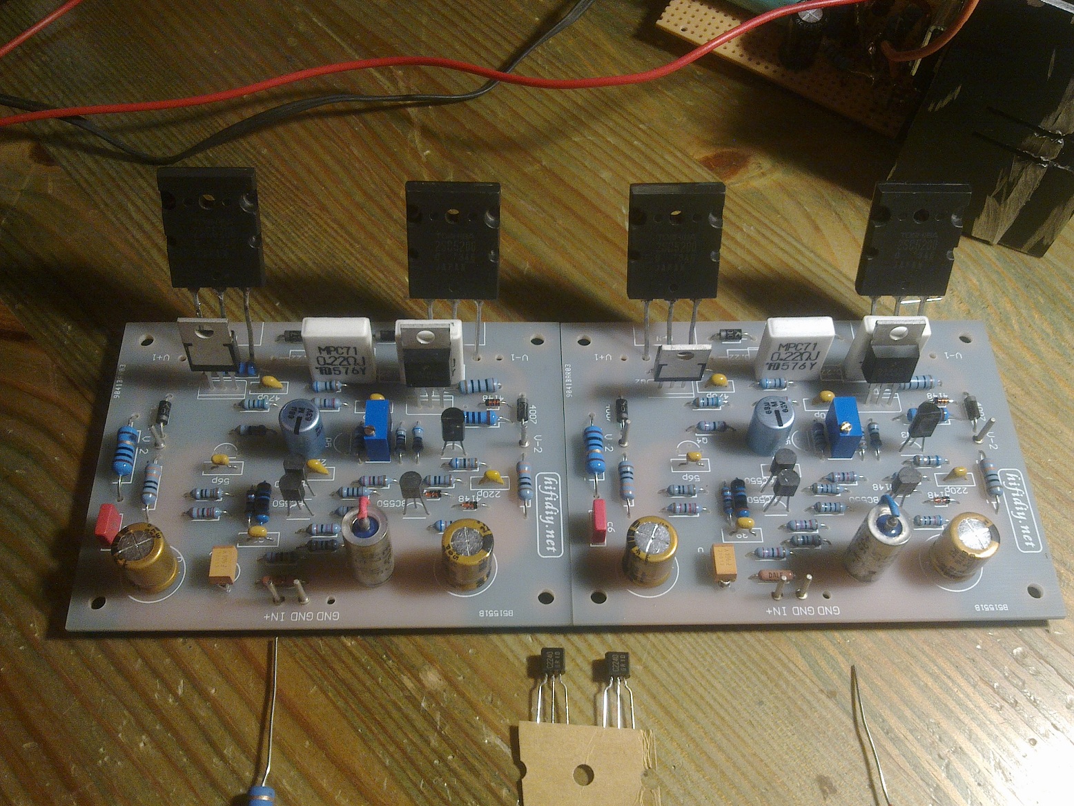

Hello,
Finished the new boards today as all the components arrived.
500VA = 41VDC to the outputs
120VA = 53VDC + Cap multiplier board = 45VDC for the Front-end
Both boards share the same capacitor banks, transformers.
Can someone enlighten me what needs to be done to connect Cap. Multiplier board to the front end ? As i understand its parallel connection to the already existing 41VDC. Diodes on both sides prevent current going from FRONT END TO THE OUTPUT Transistors, resistors(330ohm) are there to clean the main 41VDC and probably stop high current flowing to front-end.
Do i need to remove anything or cut tracks ?
Some pics: Excuse me if some pics are too large.

Your kits clearly have holes for 2 pairs of supply connector pins, V1+/- and V2+/-. I assume this allows both supplies to be connected independently, as you wish. I think the 4007 diodes normally connect these points for a single power supply, so you could remove those as they will be redundant.
There is surely a schematic for this, either at the hifidiy site, the seller's site or on other seller's sites. You might post that here, so others can be sure of what you have. You will need that to be certain or you could simply trace a circuit out from the PCB pattern.

the resistor + diode could be replaced with a cap multiplier,
or removed and use a separate very clean supply,
or removed and use a separate regulated supply.
That gives you 4 options to compare.

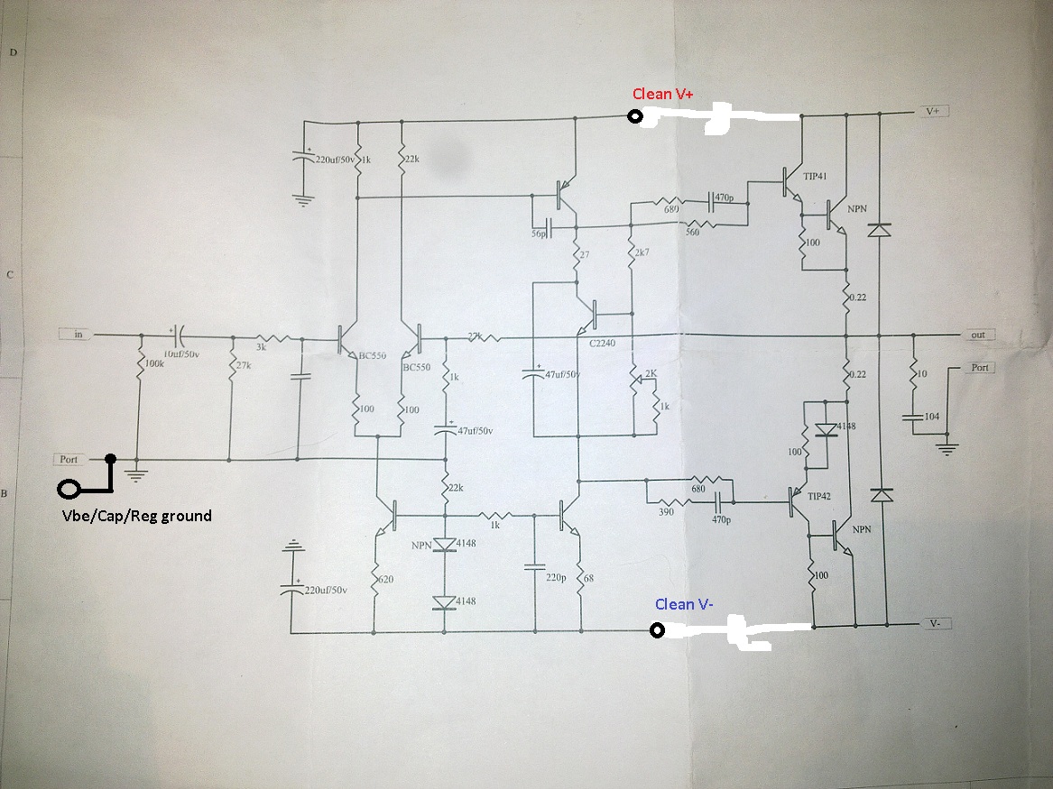

This one will be used.

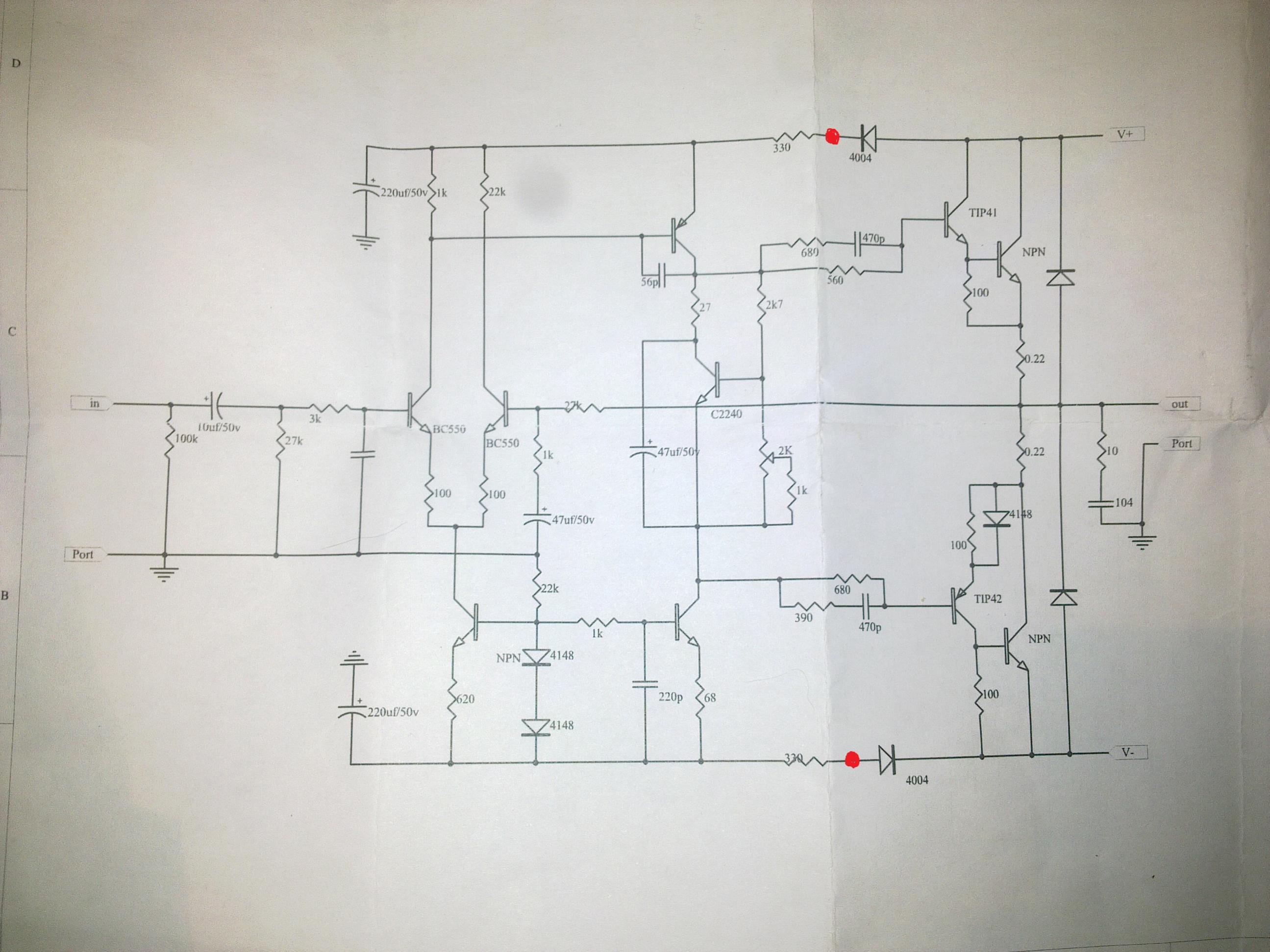

There is a lot of wiring schematics between 0V separate PSU grounds
Is the new wiring schematic correct ?
You are showing signal ground as the same point as your front end power supply ground. Only the input signal ground terminal should be connected there and then separately grounded to star ground. The power supply grounds (both main and front end) should also be returned separately to the power supply star ground - a slight but important distinction and the schematic does not show this.
Whilst it may be electrically similar, make certain the ground leads return independently to their ground points or your effort of adding cap. multiplier supplies will be wasted.
See Fig. 2 here, for the general connections for one or any number of separate power supplies for a typical amplifier: Power Supply Wiring Guidelines.

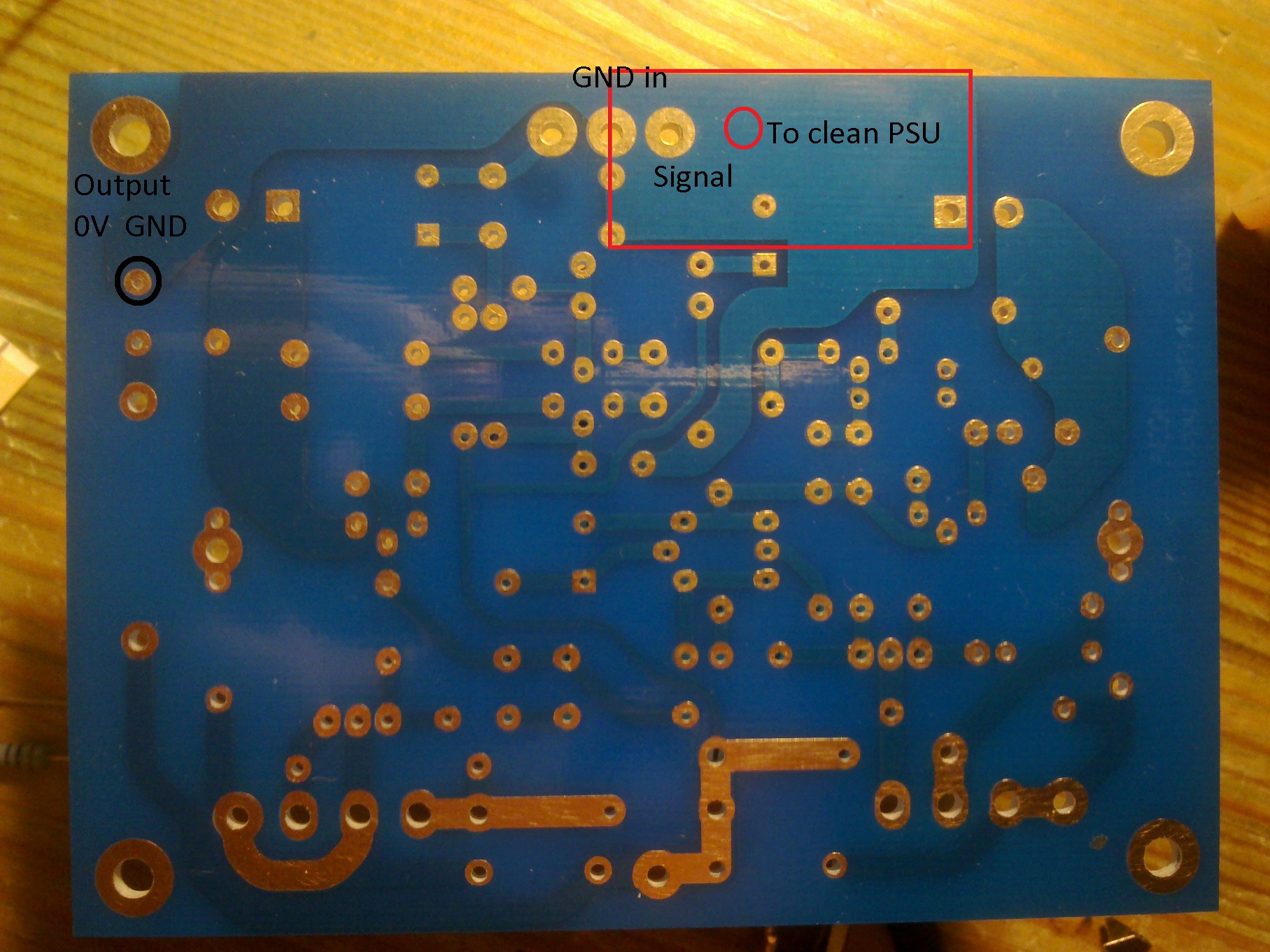

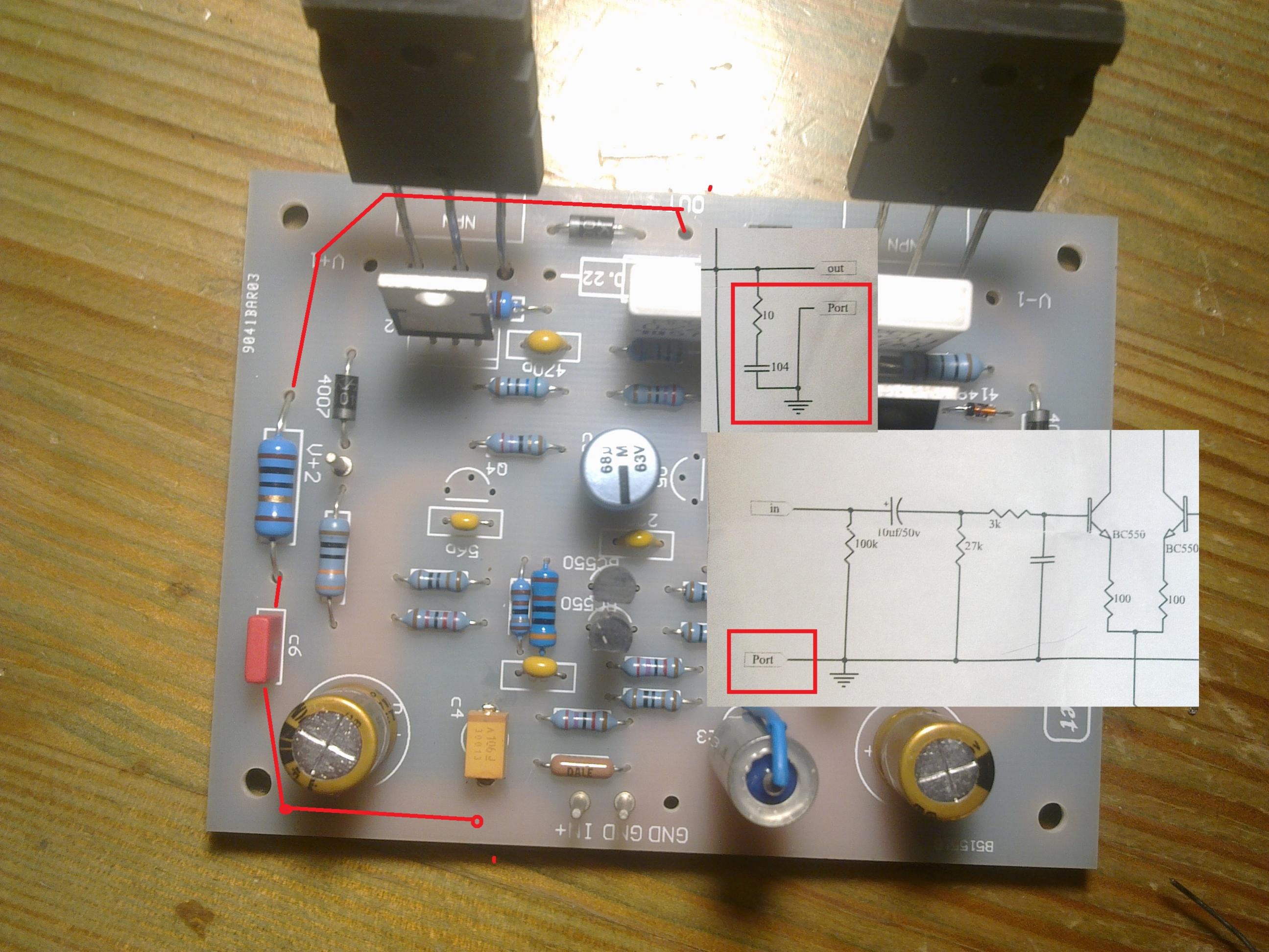

This schematic and board layout are different from naim / ncc 200 ground scheme.
For example, these clones have their output 0V ground connected to the on-board ground plane 😀 First Pic from the left.
Second pic. shows real layout and the possible grounding of front-end to the clean (separate) PSU.
The schematic is the same as that shown with some NAP140 clone kits too. It's just a circuit diagram and really doesn't show as much as it should for a kit. The PCB layout is certainly different but that does not necessarily mean better. There are now 2 star grounds and you must be careful which is used for the various power supply decoupling and smoothing caps, Zobel network, speaker ground return etc. I don't believe the Zobel network should be returned to ground at the input connection before being connected to power supply star ground in any case.This schematic and board layout are different from naim / ncc 200 ground scheme....
I suggest assembling and testing these as they are first, then adding the multipliers to be sure you have an improvement after fitting.
Having assembled a pair of these for a friend some years ago, I found there was a grounding problem which was a low level hum that was not present on other NAP140 clones but for the low price and intended use, it did not matter.
