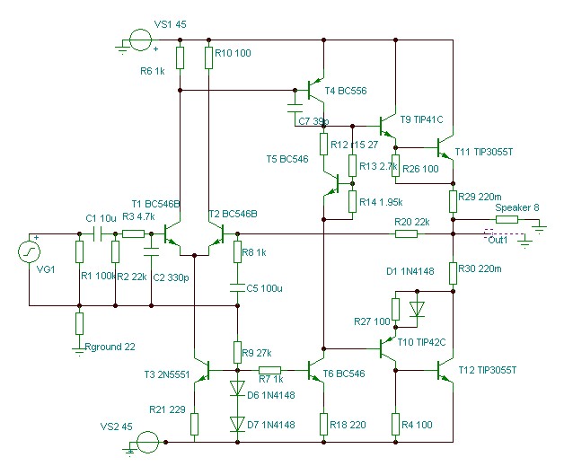

this circuit diagram is where I ended up with mine after doing simulations. After much procrastination kits have been built and are in use, although cases aren't 100% complete.
maybe this circuit diagram could be of help to others thinking of going in a similar direction.
Three "tunings" stand out and probably account for much of the "sound" signature.
R3+C2 set the RF filter quite low @ ~ 100kHz. 10kHz and upwards will be rolled off.
R8+C5 set the Bass filter and as a result generate LF distortion. D.Self explains.
T2 runs @ ~ four times the current of T1. This will result in distortion. D.Self explains.

The topology is the same as the RCA design that the Naim and Clones are based on but the parts values chosen mean it will be a long way from the type of sound quality (distortion profile) you may be expecting, as AndrewT refers. It is also highly risky to use those rail voltages and only fleapower BC546/56 for VAS transistors and TIP3055/2955 outputs. You will need at least Vceo= 100V and >1W dissipation ratings at the VAS.
You may have just been lucky with individual parts exceeding their specs or by using an E-I or undersized transformer type. Maybe it does work fine at low levels anyway but a bit of accidental full power + clipping can soon lead to smoke escaping when you have exceeded datasheet ratings. Don't assume simulators give a toss what maximum ratings parts have - everything works!
As it stands with that output stage, lower the rails to 40V or less and use something more capable at the VAS - even a parallel pair, each with their own emitter resistor for current sharing would be better, if the rails are <=40V.

Ian. Sorry to say this , I posted the RCA, it as much resembles a Naim as it does a Sinclair. I contacted Alan Morinington West. He was very annoyed that I did. He is in the Southampton area. From what I could understand the design is completely original and predates almost anything that resembles it. The RCA is far more intriguing and arguably better than anything modern in some areas. The main resemblance of these amps is to LM741 which was a design of 1963 that was suppressed until about 1967 and its designer is credited with the current mirror designs. Gogny's 1967 is similar in some ways and equally intriguing with it's compound 2N3055 Darlingtons to drive 1 ohm.
That RCA slur was I think put around by another famous designer who I would not name ( mostly as I might be wrong ).

Thanks brianuk, that's the image of the thumbnail previously shown on Les's site, though it's not the same as the NCC200 schematic shown alongside. Other RCA designs or variations from the period had features like the adjustable Vbe multiplier, current sources for the input pair and VAS, Miller compensation.
I haven't sought to compare parts selections or build quality which are different matters but the electronic design of the NCC200 DIY module design shown then, apart from reverting to using an output coil, is the same as the generic 20th century NAP design.
I imagine that handbook was a widely read primer for solid state audio design back around 1970 and many aspiring designers would have referred to it or to Philips, National semi etc. application notes. The original Naim model, NAP200, was a BTL (bridged) design and precursor of the NAP250 so the basic design would have needed to be robust but compact and simple. I think it would have been more obvious which semiconductor manufacturer's school of design you followed as an amateur back then and maybe that's the basis for claiming RCA was the source.
I would say the differences are as large as a US V8 engine and a BMW V8. The similarity will be in the V8 bit.
The Naim long tail pair arrangement is very different which will produce very different harmonic distortion traits. Compensation is different. There is no Baxendale diode to match the two halves when RCA ( quasi PNP ). RCA has an output choke and Naim reject that as a design belief. Biasing also.
I will stick my neck out and say the RCA resembles nothing I can remember and like most designs of the transistor producer might have insights as to best practice.
I hope he doesn't chase me over this. To quote the NAP 250's designer.
" There was no reference to Quad 303, nor an RCA design, nor to the later Sinclair or much else. Amongst the design elements I used NAP used Solitron RF transistors - seecso it's nigh forty years old. Pre-amp (years before CD or usable op-amps) used CCS in emitter followers for low noise, low distortion &c. I left in the early days so know nothing of what followed."
...It is also highly risky to use those rail voltages and only fleapower BC546/56 for VAS transistors and TIP3055/2955 outputs. You will need at least Vceo= 100V and >1W dissipation ratings at the VAS.
I probably should have mentioned all the transistors in my build are as per the kit, the bigger transistors in simulations are substitutes as I don't have the correct models.
I just remembered something John Curl said. He though Harmon Kardon used the RCA circuit before anyone else. Loosely speaking they did. Citation 12 perhaps. Even so the Harmon Looks different.
