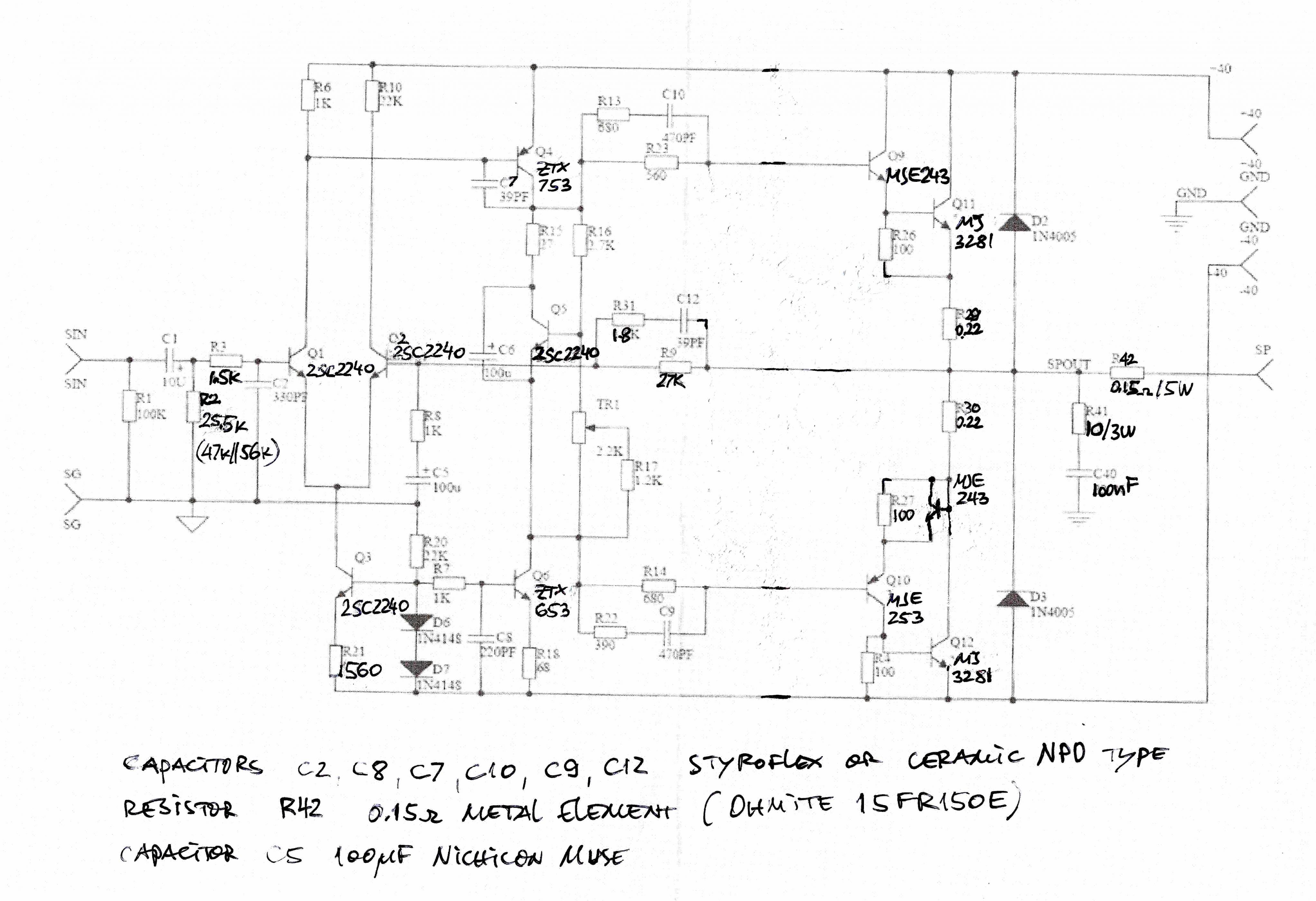

In my version of the amp with MJL3281 output transistors nothing sounds better than the 0.15 ohm metal element Ohmite resistor that I ended with. I strated at first with inductor/resistor combinations... My findings are somewhere in this, now quite big, thread.

Hi Andreas,
Sorry for the late reply - really busy week.
I attach my latest revision of the amp. I think it's self-explanatory and not original in any way.
After many months of tweaking I finally came back very close to the original version. Most modifications either don't sound that good to my ears or don't make any noticeable change, so I removed them. Some of them have strong technical reason, though. It's up to you to try, but this is my take on the amp. I have decent test equipment at home and excellent at work, but after all for music I use my ears.
Based on PRAT, most people presume clinical sounding amplifier. I think this Naim circuit is rather warm and on the dark side of the audio spectrum. It's not super detailed or deep, but somehow right - present, wide and satisfying. Great for DIY, easy to build and cheap.
Most problems with it come from poor wiring techniques. If I had a nice machine shop at home I would have made any amplifier, power supply and speaker terminals attached to common copper bussbars and not wired.
On the latest discussion about the output coils: I also used to advocate for coil/resistor at the amp output, but not anymore. If you test in purely resistive load, coil is fine. Put few nF capacitance in parallel to the load resistor and tell me what you see on the scope when you sweep the generator through the high frequencies.
I think that many cables and speakers may have and will have capacitance. Ask any tech - they will tell you that oscillation is tamed with resistors not with coils.
In addition, 0.15 ohms of quality resistor may be similar to the resistance of long runs of cables or poor terminal connections, loose bananas, dirty contacts etc. I don't think it's such a big deal about the damping factor as well, unless the speakers have really, really bad crossover design and resonance behaviour or have super low nominal impedance.
As a disclamer: I'd like you to know that I don't listen to this amplifier anymore. Lately, I played a lot with «current-feedback» designs similar to Hiraga and Pass F5 schematic and found them to be interesting and challenging.
In the end, I built a tube amplifier and since then I lost any interest in transistors for home audio. The best indication that you have something that you really like is when you don't want to open the cover and «improve» it, when you don't salivate after new models in hi-fi magazines and trade shows or scrutinize schematics on diyaudio with pile of electronics books on the table before you 🙂 There is something in tubes that makes you to like them. A lot! ... And for sure it's not their perfection.
