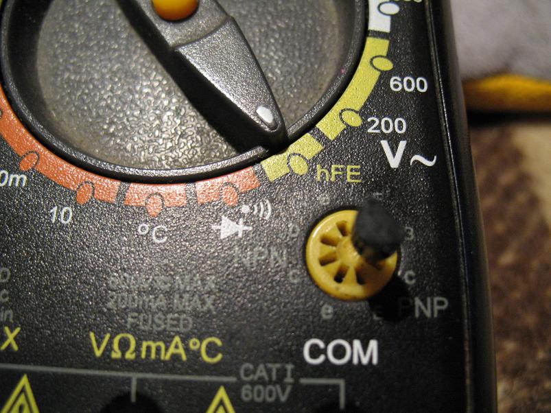

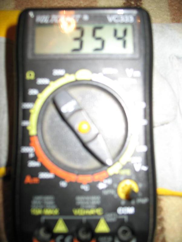

I'm not sure how to measure hfe with a dmm.

On your DMM here is some small holes and marked PNP & NPN that is for measure the transistors hFE .
Some transistor PNP & some NPN , U have to use those holes which category the transistor belong . You can find the transistor info on the net .
For exam. BC546B Data , and you can get the information if is PNP or NPN .
Please do not be afraid , you can not damage the transistor while U measure the hFE .
I dont know what type of DMM you have .
Most DMM has access to measure transistor hFE .
