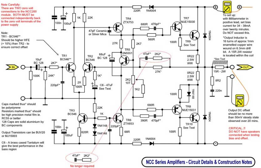

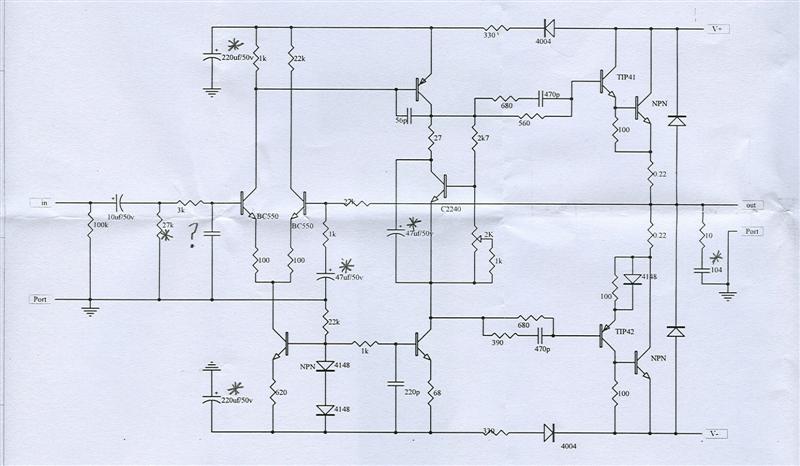

4. If you look at the NCC2000 diagram, there is 2.2K and 47pF in parallel with 27K. These will also alter the sound
Hello
What do you think if I leave out the 2.2K resistor with the 47pF capacitor that make the sound worst or better ?
I agree if we use separate power supp. for the pre-driver stage that would significantly would improve the sound .
Probably a good reg. power supp. it would be great .

The Avondale NCC200
http://www.stardi.com/high-end-audio-power-amplifier-ncc200-class-ab/

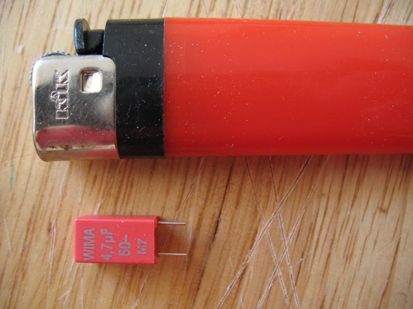

The new NCC200 use BC546for LTP .If you can buy Wima 4.7uF 5mm pitch use two of that better than bipolar .I know I used Black G 10uF non polar and the Wima is much better .😀

This US Ebay seller has those Wima MKS2-XL in 10uf.

Hello
Some ceramic caps has high distortion , even sometimes better polystyrenes than dipped silver mica !
Polystyrenes has softer sound , you have to use the same value for stability !
Sometimes even Poly Prop . not good enough ..
I like Poly Prop caps .
NCC200 serous kit , very well tested !

10uF Cap
I think the 10uF and 24K resister are high pass filter. The cut off frequency is 1/(2 * pi *10e-6 * 24K) = 0.66Hz. While the 220pF and 2.7K is for low pass filter. The cut off frequency is 1 / (2 * pi * 220E-12 * 2700) = 267Khz.
So if you can not find 10uF high quality capacitor, using lower value should be fine, I think.
Lou

Good to know.
Alternatively a 4.7uf or even smaller film capacitor normally used for crossovers, if you can find room for it in the case...?
The problem when you use smaller capacitor than the required value you get less bass !
The amplifier sound will be total different .
I tested before ,after my experience you need the 10uF there .
Greets
Greets

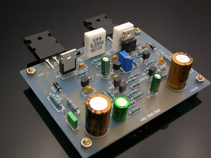

Parts list Needed...
I bought the 140 boards from Jim's Audio and received the schematic but no parts list. Does anybody have a parts list with resistor wattage and cap voltage? My power supply will be 40V or less. I'd like to order from Mouser in case you already have Mouser part numbers. Thx.
This kit comes with 100uf/16v caps at C3 and C5.
However the supplied printed circuit shows 47uf/50v caps at those positions.
Looks like they shipped it with 47uf at an earlier stage, but didn't update the printout.
I've also seen other circuits having 68uf there.
I guess you would be OK with 47uf, but I wonder what the consequences of using lower values would be for this amp...?
Thanks.

Hi, I built a pair of these NCC200 style clones (140-H) after building the other version (140-C). I only replaced the BC550 small transistors with BC546, the rest is as supplied with the kit (output is toshiba 2sc5200) . Dual mono psu with 30 volt secondaries (43v after rectification, too high?) They sound very nice but I measure 66-70 mv offset on both boards, exactly the same. Isn't this too high? Had 25-30 mv from the other kit (different components and output transistors). Any thoughts?
Hello
Please change the LTP (TR1 hFE) about 10% less than TR2 !
You can read about these on the NCC200 schematic .
These about to reduce the offset .
Greets
Greets
47uF vs 100uF for NAP140
The 47uF next to 1K will affect the gain of the amplifier.
In short, at higher frequency, the gain is (27+1)/1 = 28.
at lower frequency, the gain will be (27+1+x)/(1+x) < 28 where "x" is the impedance due to 47uF or 100uF.
In theory, higher capacitance value results in better frequency response. However, more bass does not necessary means better bass unless you have a perfect huge decoupling capacitor and perfect woofer. It is up to you to choose the right value. I believe Naim was using 47uF.
Why don't you just use whatever come with the kits then adjust the value later on as part of the tuning procedure ?
Lou
