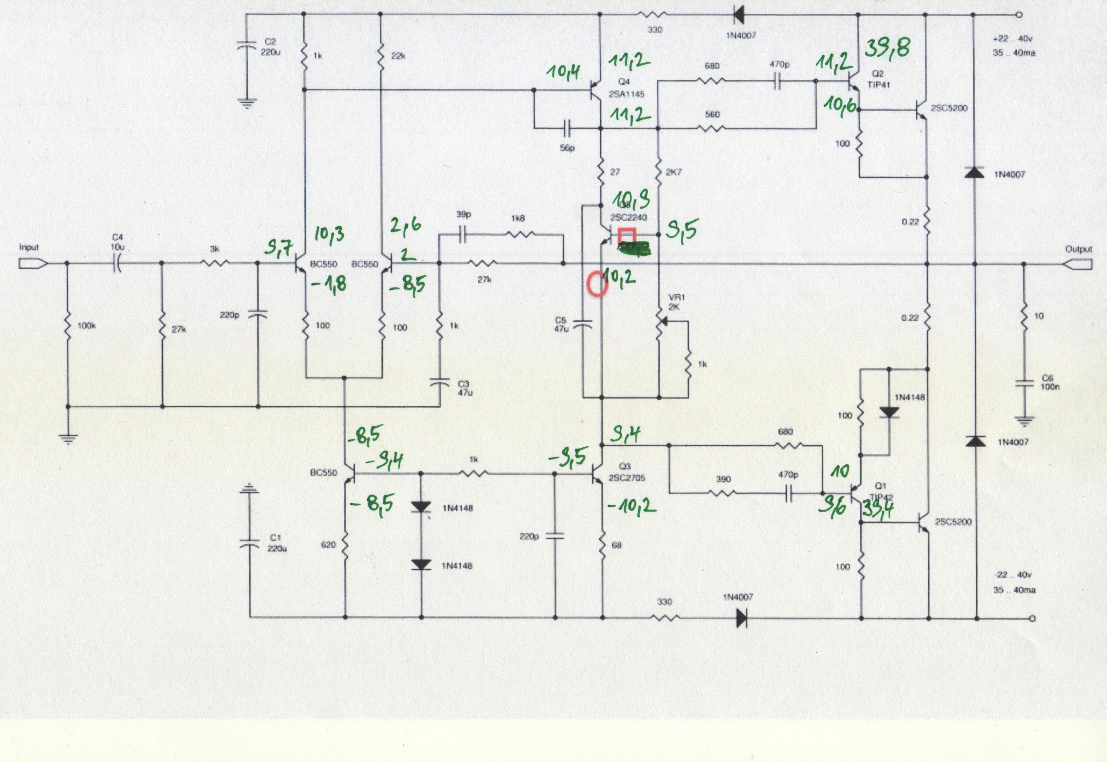

Is the same problem on both channels?
Yes
Are you sure the resistors in the base of the differential pair are correct values? You should have 27k in the feedback path and something that gives you a sum of 27k on the input. I've seen combinations of (24k+2.7k) or (22k+4.7k).
Yes they have the right values
Please have a look on the attached schematic, i measured almost all Transistor voltages.

Very bad. Now try first the obvious in the following order:
1. With no power applied, check that the ground at the input is connected to the ground at C6. You have to measure 0 ohms between these points. If not, connect them with a wire.
2. Q4 is dead if I believe your measurement, but I don't. You can't have 39.8V supply and 11.2V at the emitter of Q4, because it will fry immediately the 330 ohms resistor. You have to measure everything with reference to ground or it doesn't help at all.
3. Check your power supplies after the 1N4007 diodes. Do you have 39V/-39V ?
3. BC550 in the current source may be gone too. Are you sure you measure -8.5V on both collector and emitter? ... If yes, it's gone.
More likely though the collector is to -1.8V. Please, re-check.
And again, if the emitter is at -8.5V, the other 330 ohms in the negative rail must be fried. Also 2x1N4148 should give you about -38.5V at the base of this transistor. It doesn't make any sense!
The Q1 must be with all voltages around negative! At least the 39.4V must be -39.4V
4. The differential pair voltages don't make sense.
-1.8V and -8.5V in practically the same point (the emitters)? If yes, both don't look like transistors anymore.
5. Not very important right now, but: change 27k on the input with 24k for better balance.

I found out, that they delivered C560B instead BC550 😕
I have a bunch of BC549 in my box, I think i should exchange them all and measure again. Will not do that before tomorrow...

I measure zero Ohm
The 330 Ohms are both ok, all measuring are refering to ground, of course 🙂
Yes
Looks like its gone then
It is negative, I made mistake by drawing...sorry, but the other voltages are positive...
This is what i measured.
I will keep this in mind, thanks alot for your help 🙂
Not sure at the moment if I need to xchange other parts after xchanging all C560B
The drivers Q1, Q2 are the only that look OK. May be Q5 either. The rest is suspicious.
After you exchange practically all small transistors, measure again the voltages at the same points and attach the schematic again.
BC560 is completely different from BC550!!!
BC560 is PNP, and BC550 is NPN. So, yes, all is wrong if you use 560 instead of 550.
BC549 is NPN and will work, but there is a big chance to burn them again, because they are only 30V transistors. You better find BC550, BC547 or BC546, letter "B" or "C". "A"s gain is too low.
Good luck!

Sangeet,
I had some time today to look again into your measurements.
The good news is that Q4 and Q3 are most likely OK.
I put them in the "suspicious" list, but I have the impression that they survived. Q4 is just turned on very hard.
If you replace the 3 small transistor at the input, you may have a working amp.

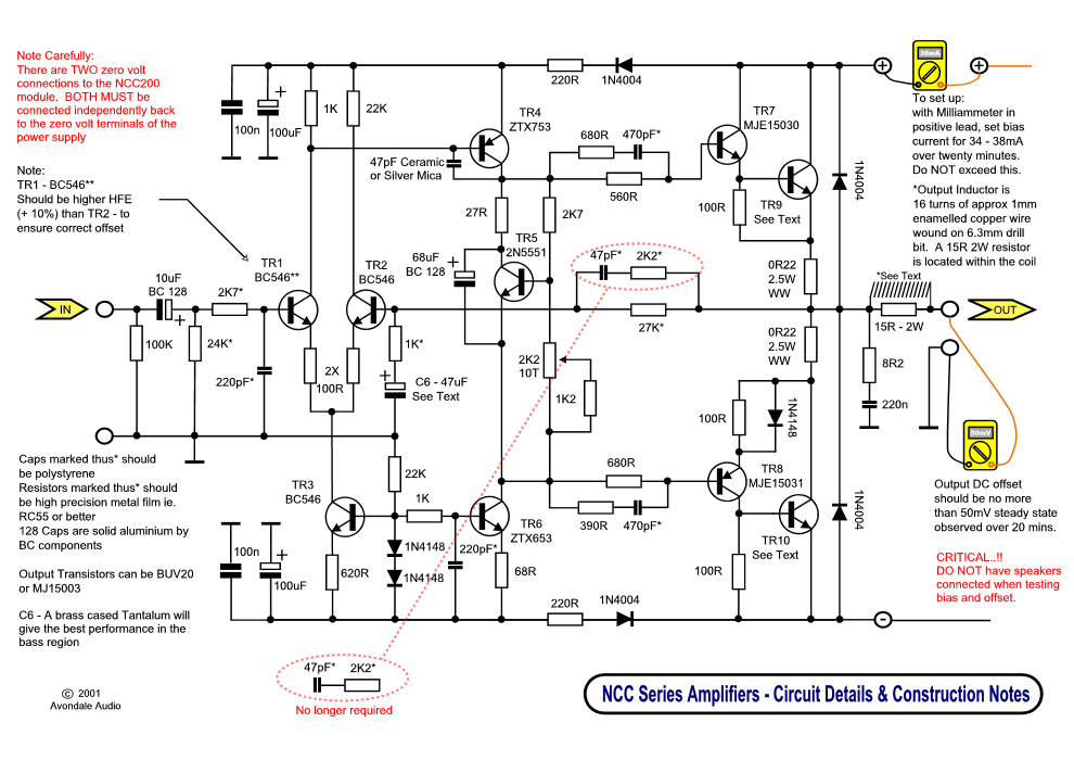

Please have a look at the attached schematic.
Is it necessary to match the transsitors?
What they mean by offset?
And what do you think leaving the 47pf and 2k2 off?

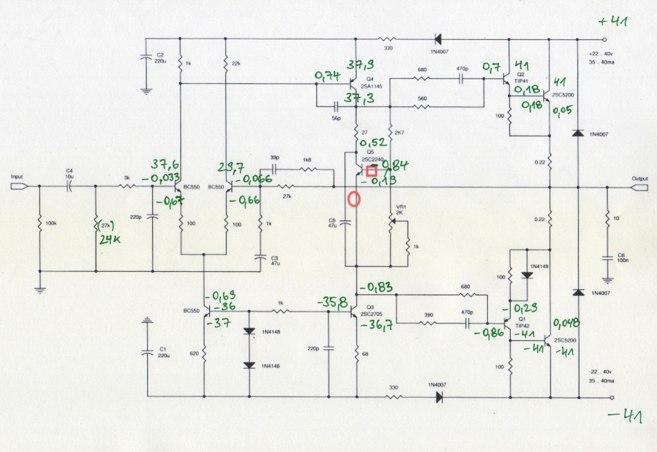

After everything is in the case:
DC Offset at the output is around 47mV
Trimmer is adjusted to 6mV at the output resistor.
No drift...
Amp is passing sound, but i have quiet a bit of hum which is very annoying 😕
Strange, cos when the amps where not in the case it was quiet...
hope it can be useful
Congrats! It looks almost normal. The only disturbing thing is your current source. Something's not right there. The 2x1N4148 should give about -39.7V at the base of the transistor, if the supply is -41V. Now I see -36V which is too high and causes too much current to flow in the differential pair. These diodes may have gone bad. You have to check a little bit more in this area.
Your Q4 still looks on too hard, lets hope this will change when you repair the current source.
47mV is OK and it will improve when you correct the current source.
24kohms on the input is fine. Consider replacing the 56pF capacitor with something between 39pF and 47pF (best styroflex, or mica type).
I wouldn't worry about the RC circuit in the feedback. You can leave it as is, or experiment later.
About the transistor matching:
yours are very good if the whole batch is within 5%. For less DC output transistors have to be matched. In the same time, if the input one has about 10% higher hfe it will compensate for the base current going into the base of Q4... but because you have 100 ohms resistors in the emitters it won't matter very much anyway. I don't know how good is the idea to have these resistors though. The original circuit doesn't have them, and it doesn't have the 1N4007/330ohms in the power supply rail. They may affect the sound very much, but I have no idea for good or bad. If you find the amp to sound somewhat "dull" you can experiment by shorting all those on the board.
About the "enclosure effect": One possible reason can be that you RCA input cinches are not isolated from the enclosure. Do they have plastic washers? If yes, I don't know what may be the problem. Check what is changing in the ground connections when you move the whole thing into a box. I have few big posts on the previous pages and I think my grounding scheme is described there. I have nothing to add.

Hello
Soon I will test the schematic posted by Sangeet2 at 452 post .
I had the blue board from Ebay the sound not bad bat somehow it has high distortion in the mid range area .
Only you can realise the distortion if you com pare with a good amplifier .
Also I tried another verizon but not much improvement .
These schematic from NCC200 . I have the stuffed PC board I just need to hock up and test it .
