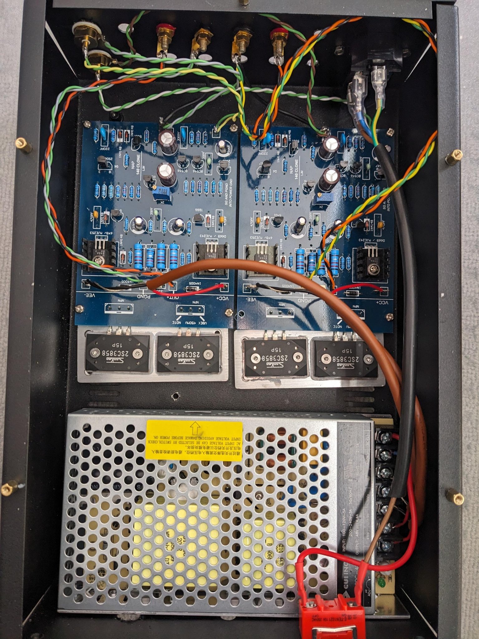

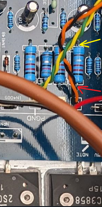

Here is the snapshot of the build. I used SMPS instead of linear power supply and output voltage is 41v DC which is close to recommended 40v DC.
I think that I measured the bias voltage incorrectly. Sorry I am total novice on electronics.
I put positive probe on one end of R29 resistor (red arrow on the attached photo) and negative probe on the other end of R29 resistor (Yellow Arrow) and the DC voltage is 0.5MV on both sides and it does not change when I turn the trim pot at all.

Those pots are multi-turn (often 20-25 turns full travel). Did you keep winding them?

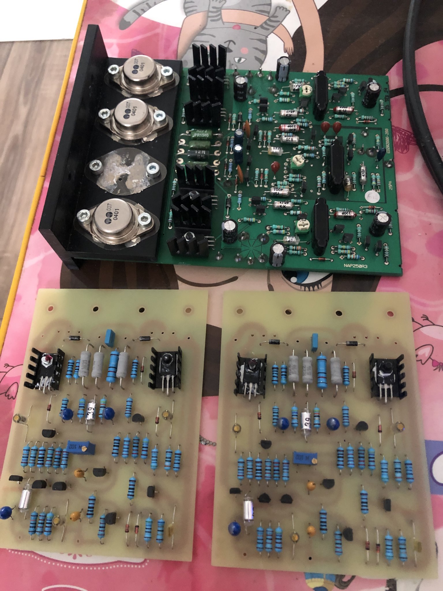

It could be helpful to know that some of the components in Naim's 250R3 2-channel board shown here are different values or types to those in the early, single channel NAP 250 Board, which most clone boards and cheaper kits seem to follow. That's often published with the kit details of the better clone boards. So, it seems unlikely that a clone kit of the original version using those boards, is going to sound exactly the same as genuine NAP250 products. In any case, there will have been revisions and improvements over some 50 years in production and you won't see those on an early schematics or products.
FWIW, I've assembled and assisted on dozens of different NAP250 based clones and still haven't heard one that comes close to Naim's particular sound quality when assembled according to the schematic or parts overlay. It's a good to see you have fitted what looks like genuine XTX653/753 semis in the VAS though, since these are universal and significant contributors to the original Naim sound.
I've posted this link to Naim schematics, info and DIY clone designs many times. It's old but contains interesting and some useful info buried in the index somewhere: http://www.acoustica.org.uk/t/naim/power_amps.html
