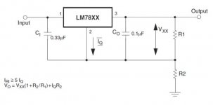

I wonder if instead of front end regulation using resisto/ cap / regulator , we add a 7824 / 7924 regulator into the mix (+ 16v zener to get to 40v ) might this give a better result?
I tried this approach on an old hafler dh-200 with very favourable results...
I reckon you want either a zener or a regulator, not both. Sort of the worst of both worlds if they are in series. Keep it simple.
If you use a regulator it will need >50V Vi-Vo rating, like an LM317HV. You'll also need an extra pair of smoothing caps. This could get expensive. So I'd stick to the zener regulator on the front-end in the first instance.
The thing is, to make something of audiophile quality you'll have to go to a lot of trouble and expense. A lot more than a new transformer or variac. I'm just saying.
