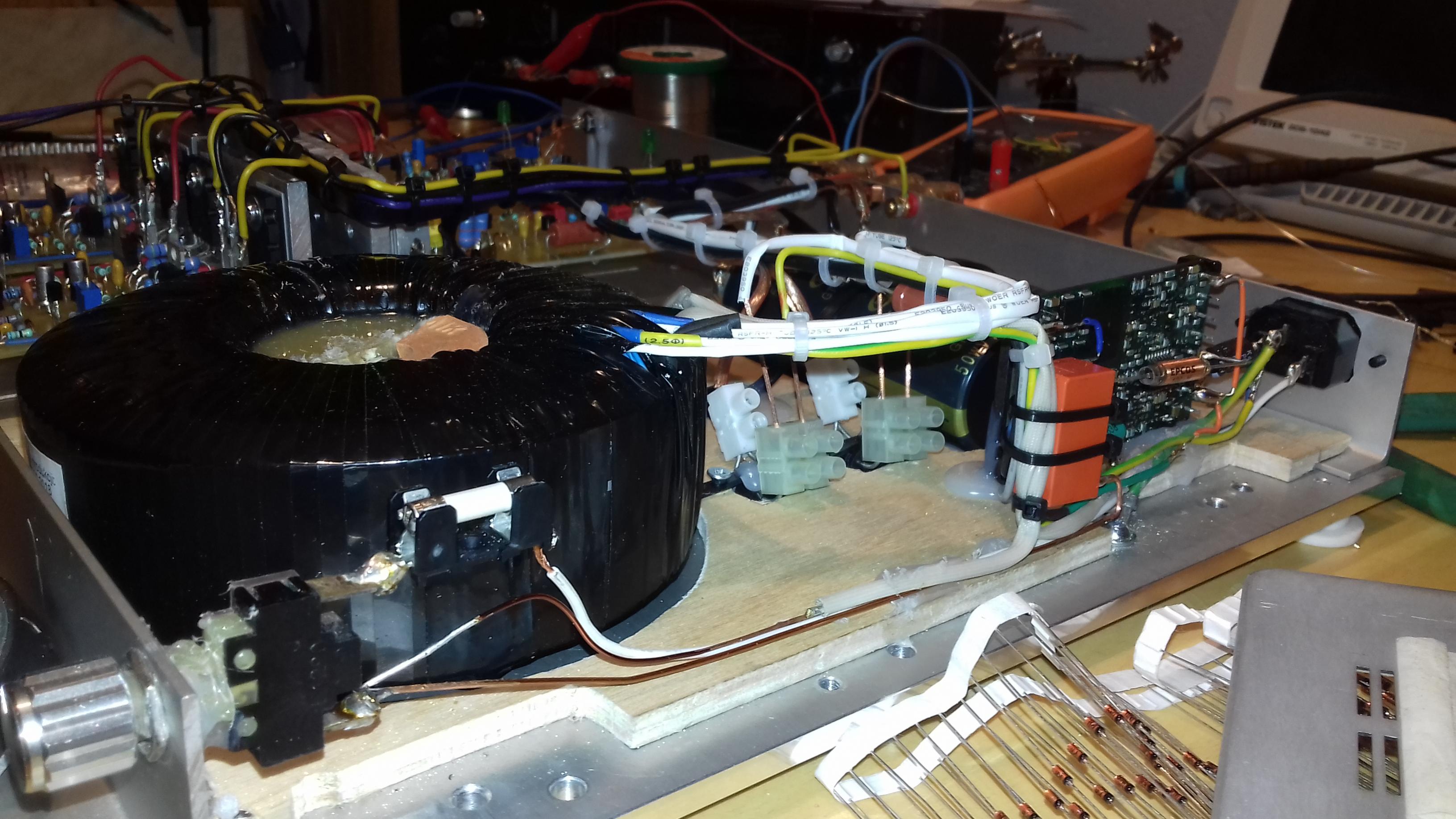

Hello george,

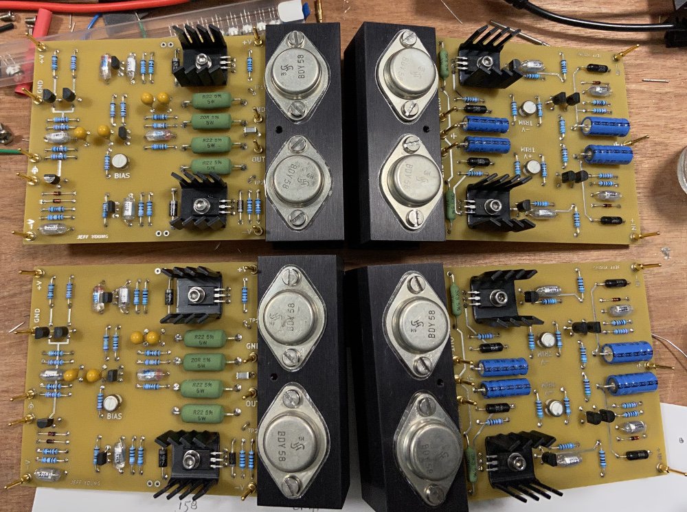

in the previous pages you can see some picture of the boards, a work in progress footage.
Yes they are indeed a nap 140 clone boards, marked "zerozone". They have the current protection circuit (but i've not soldered it) but i strictly followed Ultima Legione scheme.
Still you can see all details in this thread, just go some pages behind this.
I'm using a toroidal with 30V secondary, so i get, without load, a plenty 44V DC, which should fall off near 40 under load.
Ultima Legione chose to rip off the rails and go with regulated supply for the VAS stage, thus ripping off the diode and the resistor he had at scheme. (not needed with separate supply)
I still got them since i run the rails with the same source, so yes i have the diode and the resistor.
For the case; you are absolutely right, having not a case is dangerous.
Unaware fingers on it, and u get things, and, worse, people, fried.
But i'm taking all the precautions i need to avoid troubles.
The 3A fuse is quite big but i kept frying them at bootstrap.
For safety reasons maybe some more fuses on DC rails are needed.

Hi, in around red circle you should put a smal round bridge 1,5A rectifire, in the other red marked, sorry but I dont know 🙂, maibe you have to see the electronic diagram.
Regards
these parts are obviously for the 24V preamp supply - do not use them if you do not need this supply

Ok fuse switched i have one channel working at 38 mA which seem fine, however dc offset is 0.09 vwhich seem too high, will this be an issue and if so how can i reduce it?
It's not too bad. Work out the speaker current, about 1mW heat if my maths correct. The Naim input stage is likely to be slight worse than most. This seems to be an attempt at single transistor distortion and twin transistor DC point advantages of a long tail pair. That is the distortion of the Quad 303 which I beleive was known to the designer.
A matched pair of input transistors might help.
0.09v is 9mV - probably a tiny bit high but absolutely fine.
You need to stary worrying when you have 50mV+ offset.

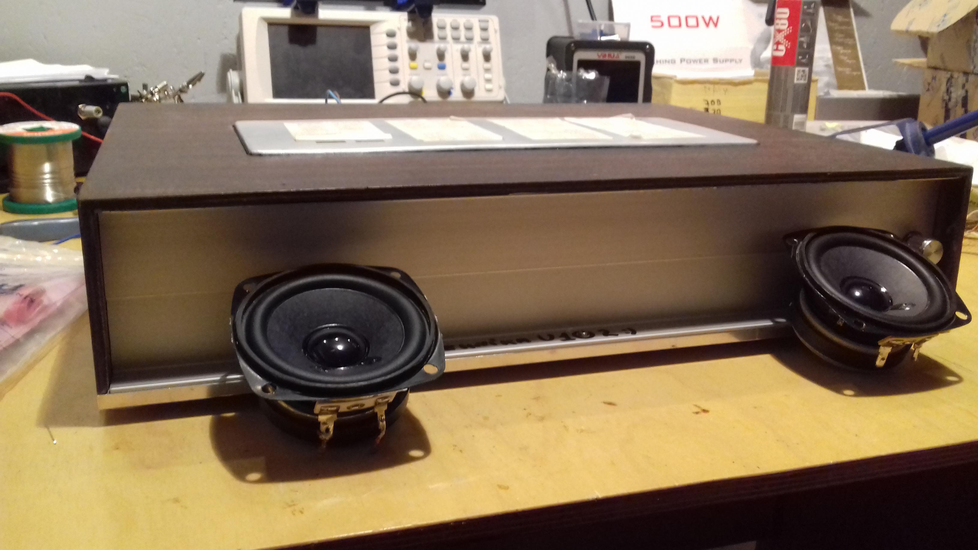

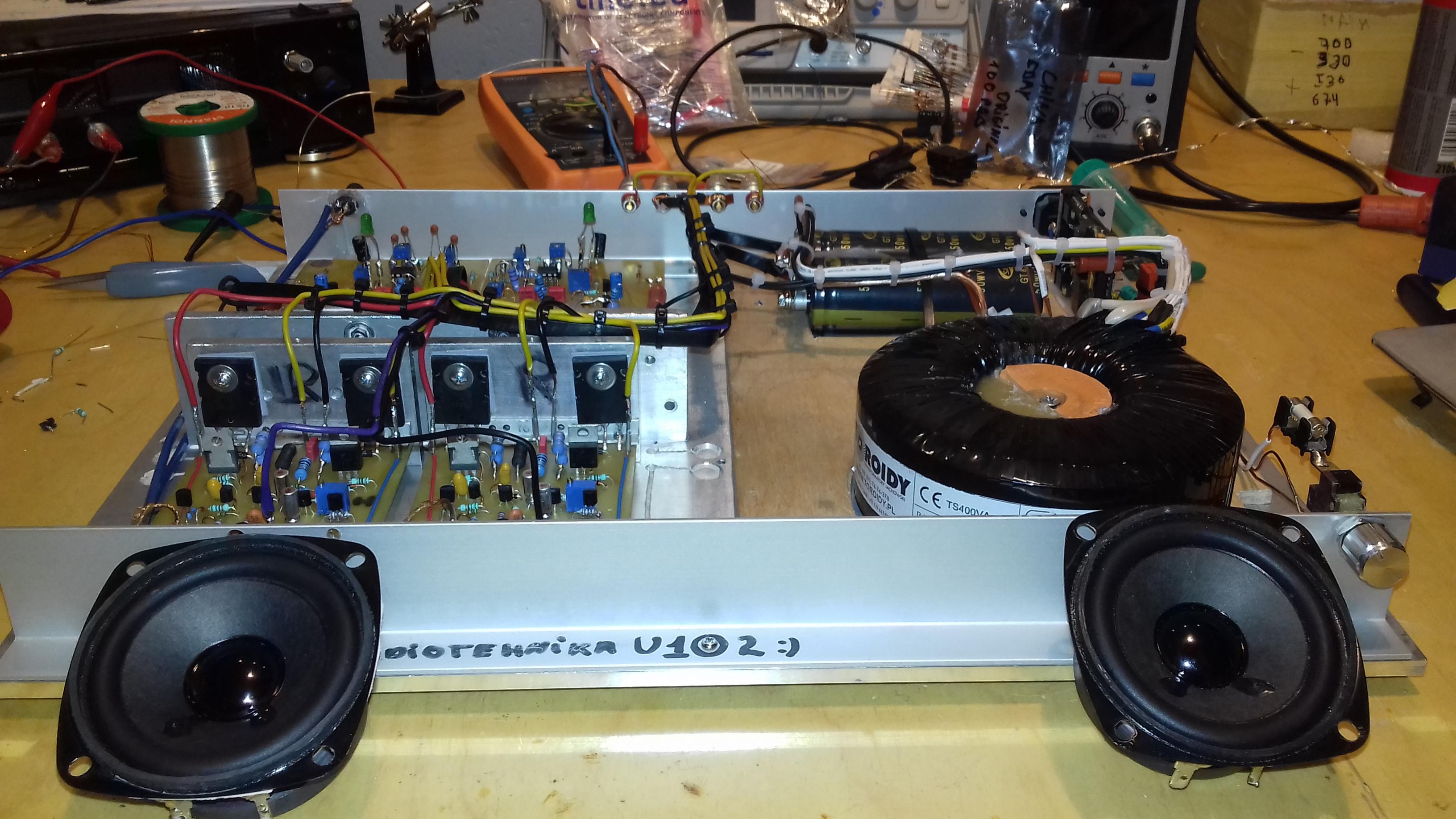

Hi everyone,
made a 4th complete build lol.....
Basically, it has the H-140(ebay clone) front-ending sound signature with the naim favored 22k1k harmonics 😉
If H-140 did sound periodically "cool😱", then this amplifier sounds ALWAYS "cool😱😱😱" after about 5-10mins from the cold start. It all depends on how cold is the room.
Rhythm and time are the strongest points in that amplifier.
Space is "front-ending" and gives you that "big speaker" feeling. (listening from FRS8 needles). Like an instrument in quitar, piano programs.
There are lots of factors that must be met to make it less "fatigue" sounding.
3 of these i consider the most important:

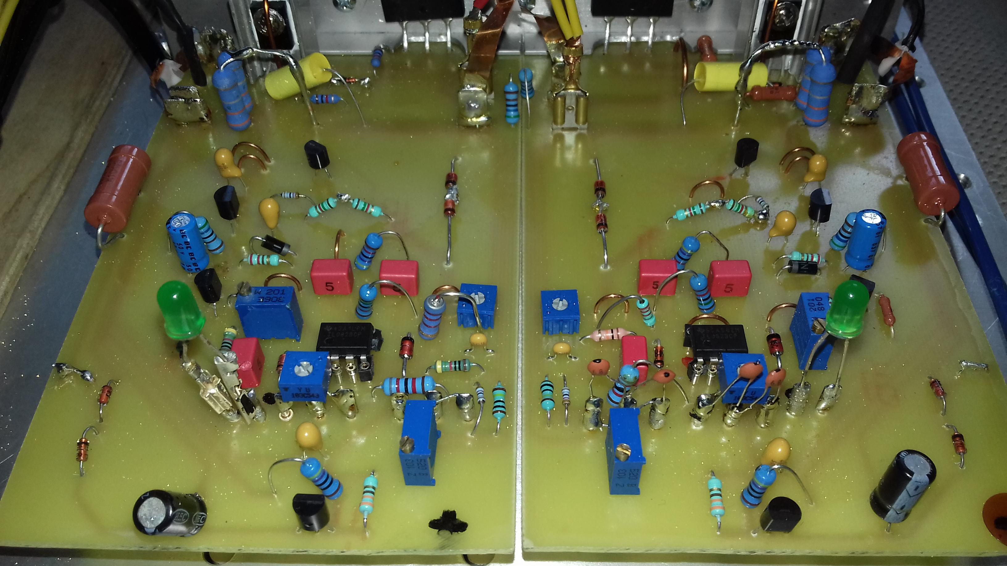

The very first and very worst enemy is the temperatureIt comes and goes @ various rates and affects every active component used. I came to a conclusion that naim amplifier depends on that factor massively. Especially if you design your amplifiers in free-air temperature "without the case" - it would be a fail design 100% not considering lucky situations. Every case needs its own amplifier adjustments... that is why some think that case has a "sound" 😀
The second factor is that you have to determine, which one of the boards will be your left and your right channel... and then go designing from that point. If you make 100% same boards that have resistors, transistors, capacitors, currents and theyr offsets all the same, it again will be 100% fail design as from my previous experiences.
Third one is based on exp. gained while doing this stuff as a hobby. One must be able to manipulate with the sound signature and its space with in the head to get an idea what is the acoustic result if some sort of change is applied in electrical circuit lol....then the phase shift networks, different dc offsets and currents will give you an idea that what it does to acoustics and its space. For example, starting with the speakers... aligning them perfectly in a room. I used cyborgs needle FRS8 speakers...(there are some bad FRS8 elements on sale, be aware).
To my surprise, the component choice is not at all that critical after all. For example... it can be made without the ZTX, BC239, MJE and Sanken series transistors, as in my last case. I didnt use any of those cuz they are pretty much outdated. My current boards have approximately 20mA of bias @ outputs.
The very basic idea is that you have to make boards a little bit different and in the same time be within the design margin. How much difference depends on the length and cable arrangement used, boards placement in the case and everything else.
I think, all amplifiers do need some sort of difference to some extent for a great loving sound.
Also, in my case, there are some critical design criteria involved with in the boards... perhaps cuz of the transistors i used in that circuit....and i really really love how TIP handles 2SC5200... its just blows my mind out into space 😀

REALLY nice job rensli. A lot of work and effort in there.. but i'm sure satisfaction is in your hands 🙂
Let me ask you some now......
1) i see a volume control. a passive one? can you give us some infos?
2) FRS8. why this model? is it special? good quality/price?
Regarding the Naim circuit: yes, i can confirm that temperature control is critical. Since this amp doesn't need SO MUCH heat dissipation, a "semi-closed" enclosure with any fans is probably the best solution. There you can have that useful "heat intertia" that naim circuit needs to stabilize itself.
The active components: well i have two builds now, one with Ultima Legione specs, and one with sankens and ztx.
Both of them has sonic footprint.
Still can't tell the differences, because the second build has a "poor's man" power supply stage, so there can be NO tests between them.
Last point (for now) isn't better to use non-inductive 0.22 resistors for the final stage?

It depends lol, i think alot on the wiring arrangement and material you mount your transistors for cooling (siliconpad, ceramic pad, thickness and so on).
I my case, simple non-inductive 0.22 OHM just wont work.
Be aware of emitter resistance.... there is something going on with the feedback.... less is cool, but not at the same time in this topology 😀 Careful here. drivers and output dependent
I just Love, how this amp turns small speakers into LIVE action...
Its a switching powersupply lol(small board, vertically mounted on glue), i need it for PSU.... amp has regulator boards.

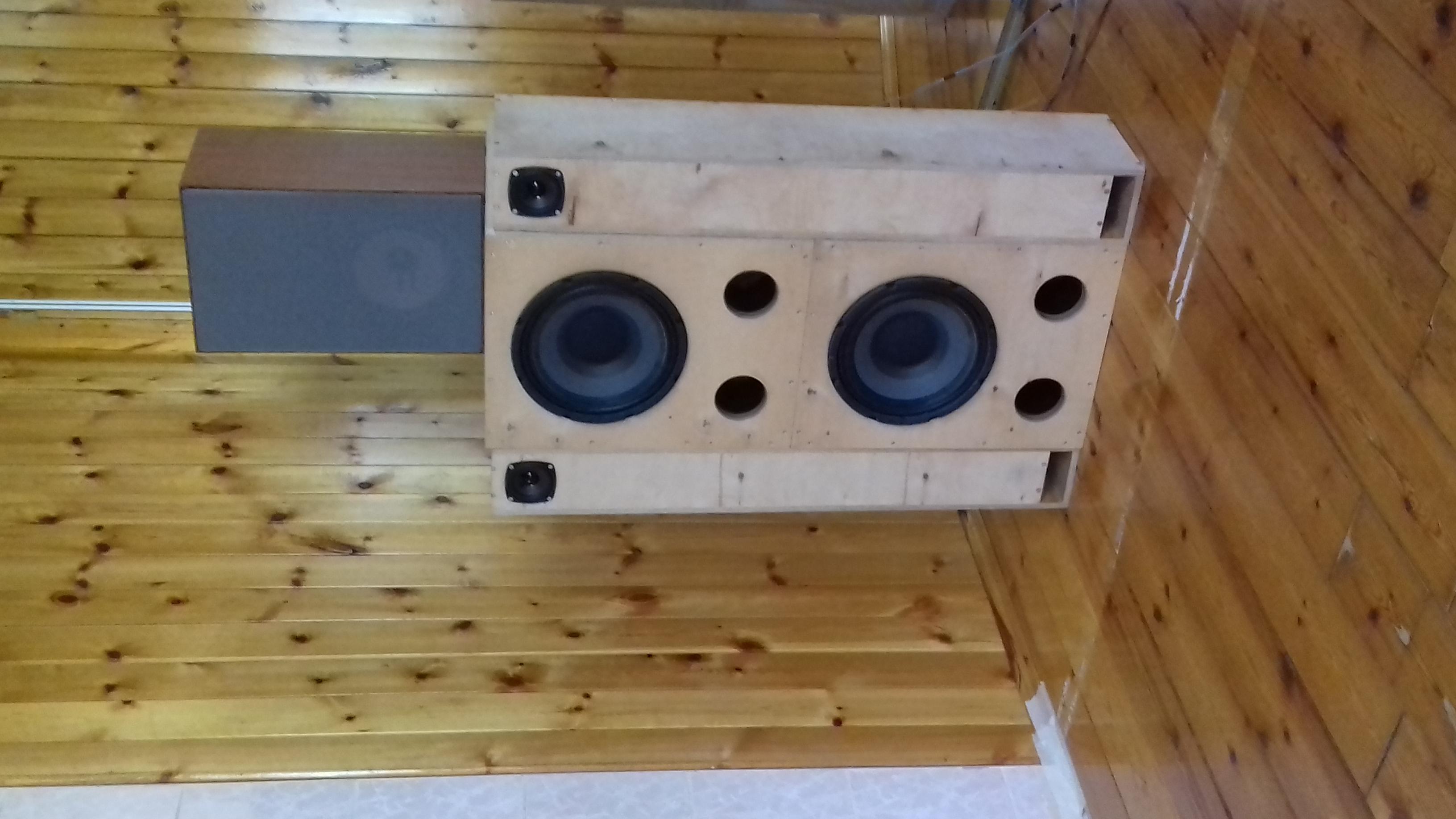

FRS8
They cost 16€ and give 100€ speaker expression with naim amp 😀 And its a TQWT design, you can hear everything from there in a ~ 15m2 room.

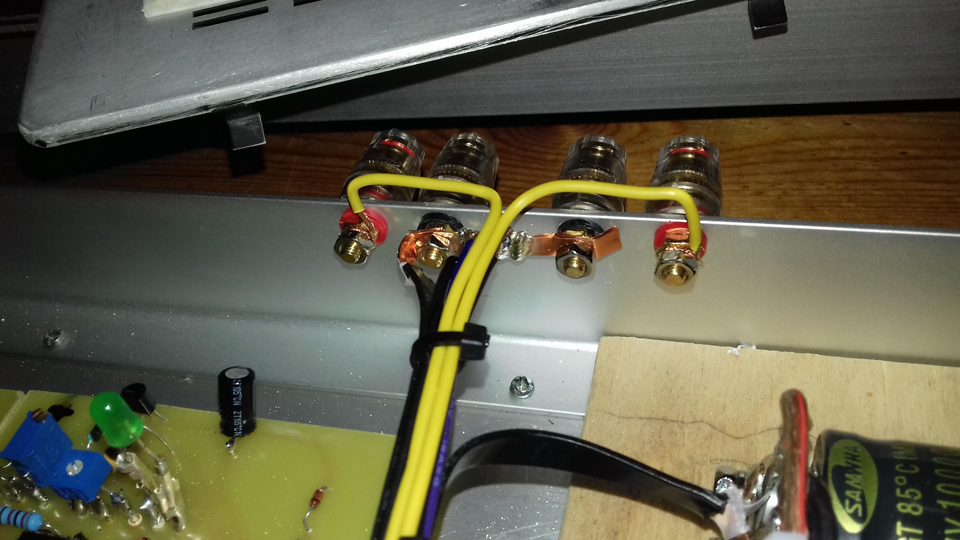

The Naim design is border-line unstable. I think you definitely want a little bit of inductance in the output stage.
I would agree with that.
This is why Naim specified that people use their own cable, as their cable made the amps more stable.
And IIRC Naim themselves also used a wirewound resistor in series with the output.
Yep, they are kinda unstable, but its not only the outputstage that is responsible for this kind of behaviour .
Its almost impossible or very hard to build it that way, limited resources are the problem. I would definitely love to bruto force the design.
