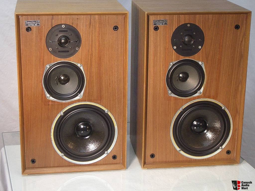

This issue is the only real criticism I have of the sound I obtained from my clone - it can sound harsh on modern speakers. I suspect that the speakers available at the time this amplifier was developed would not have sounded as harsh as my PMC floor standers. My father uses a pair of speakers which we'd now call vintage and they sound very smooth (Celestion Ditton 22) on his Sansui stack. After hearing some harshness myself on my PMC speakers I did some searching around on the 'net and found others have made similar comments. My ears are particularly sensitive (hyperacusis) so I have an interest in this kind of thing. Having the option to add rail decoupling caps on the pcb would be a good thing for me but I have no plans to modify my pcb now. I need to get my clone up and running again to remind myself of the sound - I had assumed that the issue was my power supply - running at too high a voltage compared with the original. I have at least one other amplifier, of a different design, that clearly sounds nicer at lower rail voltages and in that case I tried 3 different voltages (AKSA amplifier).
Ah those old Celestions! I always wanted a pair of Dittons when i was a kid; I thought they looked really cool. Times change.
Naim started out just making amps and preamps, of course, and Linn provided the turntable and speakers. That partnership was key to both their success.
Naim eventually designed its own speakers, which I have never heard so I cannot judge, but they never did that well. Now they have become a partner with Focal (common owner). I have heard this combo and it is lively but a tad edgy.
