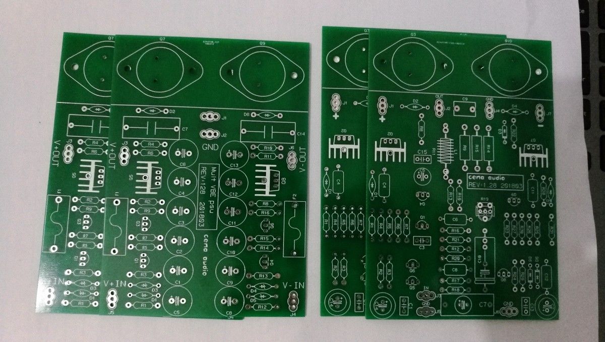

I enclose the relevant information you requested. Please note although the boards say "cerna Audio" and that is what I ordered , I have received Zerozone boards and schematics.Would you post the Zerozone schematic?

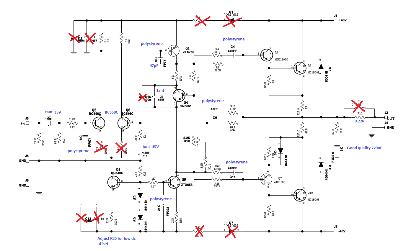

I've marked up the amplifier schematic with what I would do.I enclose the relevant information you requested. Please note although the boards say "cerna Audio" and that is what I ordered , I have received Zerozone boards and schematics.

You may get conflicting advice here (very rare in DiyAudio) and I am not always going to explain things because I am secretive. But you may want to assemble one board this way as a comparison.
Also, your transistors are not the Naim choices and not matched so this will cause an unpredictably worse result. Unless you use Naim's build process it will not sound as good as a Naim. It is up to you whether you decide to spend extra money on these parts.
Schematic changes
- Remove crossed out parts. Replace with wire as appropriate.
- Use 35V tantalums for C7 & C10. DOn't use lower voltage ones as they may not like being reverse biased during half the music signal. IF YOU ARE NOT EXPERIENCED building these then use electrolytics for power-on and once you are sure the dc offsets are ok then change to tantalums.
- the base networks on the darlingtons will not be correct for these transistors. I am not going to explain how to correct them but you stand a better chance if you use MJE243/253 drivers like Naim does.
- Inputs better with BC550C low noise.
- Adjust R26 (Q8 emitter resistor) to get the dc offset small. The BC546 is ok but it is different from the ZTX part Naim uses and the Vbe will be different.
- Remove output coil, replace 15ohm with 0.22.

The supply should be transformer with separate winding for each rail, two bridges & two smoothing caps per channel. Use good caps as I mentioned earlier. Don't wire lots of caps together. You need to be careful with your grounding paths. This is very important and there is lots of advice around here about that already.
I can't comment on the regulated supply yet. I need to find time to study it. But use the board unregulated to start with anyway. See how it sounds.

Thank you so much for your kindness. Can I ask what ZTX part you are referring to ? This board is using ZTX 753 and 653 already?I've marked up the amplifier schematic with what I would do.

I have ordered BUV20 NOS from USA, hopefully they would not be fake. I will order rest of the parts as per your advice and report back.
