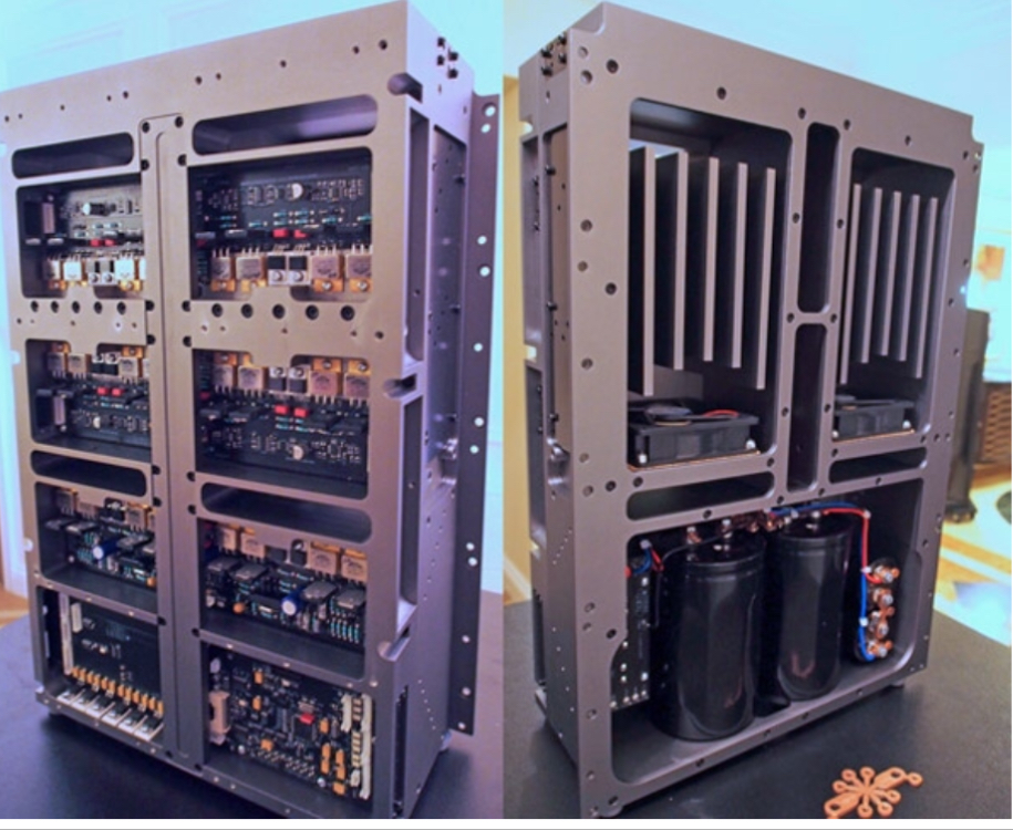

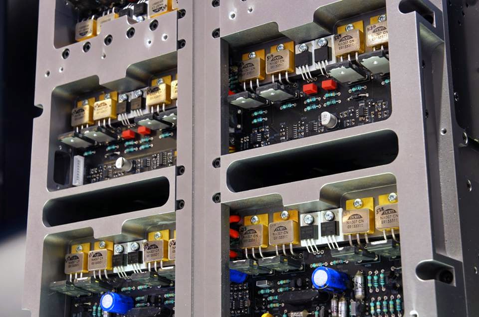

Wow, those heatsinks must have cost a small fortune to cast and polish. Lookit all the rough-and-ready polystyrene foil caps! Do we know just how many individual amplifiers are used to make up the 1450W/4R rating?
I can imagine someone trying to profit by selling just one amp from the array as a $25 kit of jellybean parts.

I count 4 boards that could be amplifiers and 2 that could be psu regulators. There is a voltage gain board mounted horizontally on the top (not visible in the photo).
What do you think: the amps are a bridge of two parallel pairs?

I'm not sure what those NA507 transistors are capable of, in their oversize TO218 format with apparently only 1 offset mounting bolt. It looks doubtful as an assembly method for high power but I know very little about present day engineering extremes or those custom semis. Are they another contribution from Semelab?
If you bridge and parallel four amplifiers capable of 400W each, I don't see why it shouldn't make the target reliably, knowing there will also be some carefully designed and effective load sharing circuitry and component matching that we don't hear about.
It may need an auditorium stacked with Focal's Grand Utopia boxes to make use of that massive thing though.

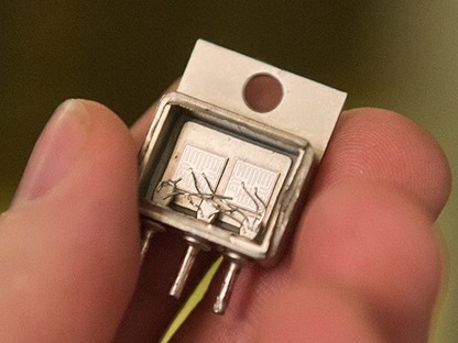

Not so many years ago, Semelab/Magnatech offered these 400W single die audio transistors that didn't seem to be taken up by manufacturers at the time. I'm guessing that there is something in the timing of events to suggest they may have been the inspiration for Naim's Statement. The power rating is in the ballpark at least: http://www.farnell.com/datasheets/8...23.1012455807.1536655579-530884628.1474536571
Interesting. 400W is huge! However, the junction to case thermal resistance is 0.32C/W so you would have to keep the case below 22C to keep the die from reaching 150C. Imagine trying to keep the metal tab at 22C while 400W flows through it. I know no one would run the thing at 400W continuously but fun thought.

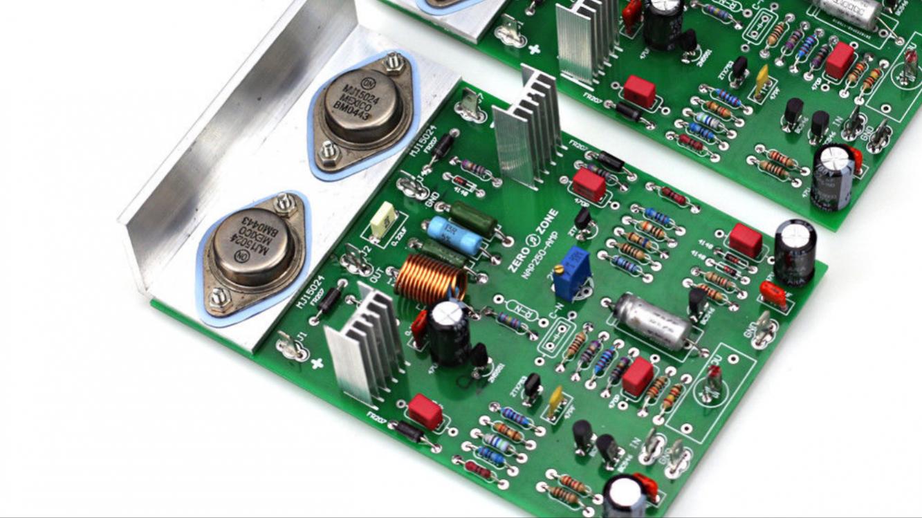

Is this what you built (see photo)?Please excuse my ignorance, which capacitor is zobel ? as I see Tant or Polystyrene only? I have made 250 clone using NCC 200 clone boards by zerozone. It sounds no way near to my Original Nap 200. Reading this whole thread gave me an impression 140 sounds better, hence I opted for that. Would you recommend otherwise?
Rather than finding a NAP140 kit why not improve your Zerozone?
I guess the Zerozone NCC200 is a clone of the Avondale NCC200 which is a hacked version of the Naim NAP250.
You can give it a fighting chance by replacing the cheap capacitors and undoing the Avondale mods.
Build yourself a good power supply. This does not need to be complicated, just good. Copy Naim. Use proper quality psu smoothing caps like BHC or Mundorf, 10000uF per rail is plenty. Use separate supplies for each board (a dual secondary transformer is fine).
