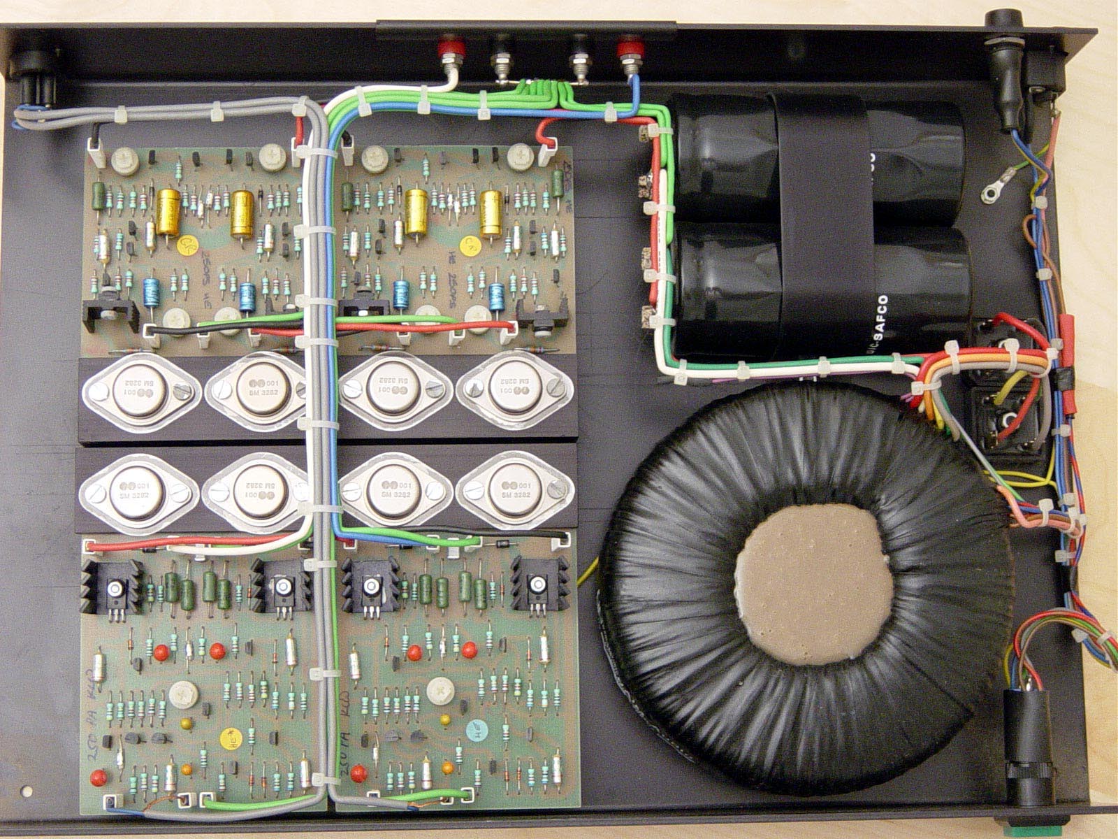

The difference between many of these amps is the power supply, it’s voltage, size and number of transformers etc., but the amplifier schematic is more or less unchanged so I wouldn’t worry too much. In my case I reverse engineered a NAP from detailed photos but I didn’t follow it slavishly because I wanted proper thermal control rather than rely on the original scheme.
The original 250 has a regulated psu for each channel as well as the best components. The less powerful models have smaller supplies and worse components in certain places.
You might as well go for a NAP250 and seek best performance, either with or without the regulated psu.
The amp boards are at the bottom in the attached image of an old style 250. You don't have to have regulators. You don't have to use TO-3 can style power transistors. But notice all the amplifier capacitors are either tantalum or polystyrene. Oh, except for the zobel capacitor.

I've read mixed reviews about the regulators, some folk saying they thought it improved things, others saying they like the amps without regulators. The trouble with regulators is that that they have to be better than the amplifier they are controlling, they are a technical challenge that you don't see being addressed for power amplifiers on this forum too often. Naim now have a more modern design for their power rail regulator, I've taken a pretty close look at it and believe they've done a really nice job of it. The detailed schematics are not available although you can work out what most of it looks like.
A good regulator allows you to be a bit lazy with the PSRR of your amplifier - the basic NAP doesn't have brilliant PSRR due to poor rail decoupling of the front-end which makes the sound of the amplifier more sensitive to power supply design and hence reports of differences between the 140, 160, etc. Rail decoupling is important for sound, the AKSA amplifier has some secret sauce that most folk never understood but is related to the use of bootstrapped VAS load. Anyhow, I believe the earlier NAP models do respond to power rail regulation but it will change the sound and in my opinion the jury is still out on whether to use it or not. And if I were to add a regulator, I would forgo the historical accuracy and design something with better performance.
Note: I didn't incorporate the outputs stage protection circuit either - I consider them necessary for my DIY use as well as reducing the risk of adverse affect on the sonics (perhaps a dual slope limiter would be better but the only design I liked so far I reverse engineered from a Bryston amplifier).
Please excuse my ignorance, which capacitor is zobel ? as I see Tant or Polystyrene only? I have made 250 clone using NCC 200 clone boards by zerozone. It sounds no way near to my Original Nap 200. Reading this whole thread gave me an impression 140 sounds better, hence I opted for that. Would you recommend otherwise?
I've read mixed reviews about the regulators, some folk saying they thought it improved things, others saying they like the amps without regulators. The trouble with regulators is that that they have to be better than the amplifier they are controlling, they are a technical challenge that you don't see being addressed for power amplifiers on this forum too often. Naim now have a more modern design for their power rail regulator, I've taken a pretty close look at it and believe they've done a really nice job of it. The detailed schematics are not available although you can work out what most of it looks like. A good regulator allows you to be a bit lazy with the PSRR of your amplifier - the basic NAP doesn't have brilliant PSRR due to poor rail decoupling of the front-end which makes the sound of the amplifier more sensitive to power supply design and hence reports of differences between the 140, 160, etc. Rail decoupling is important for sound, the AKSA amplifier has some secret sauce that most folk never understood but is related to the use of bootstrapped VAS load. Anyhow, I believe the earlier NAP models do respond to power rail regulation but it will change the sound and in my opinion the jury is still out on whether to use it or not.
I agree, amplifier sounds better without regulators. I have tried both multi VBE and HCR type. Without regulator sound is definitely better.
No excuses needed. The zobel cap is the pale rectangle between the blue and green wire connectors.
