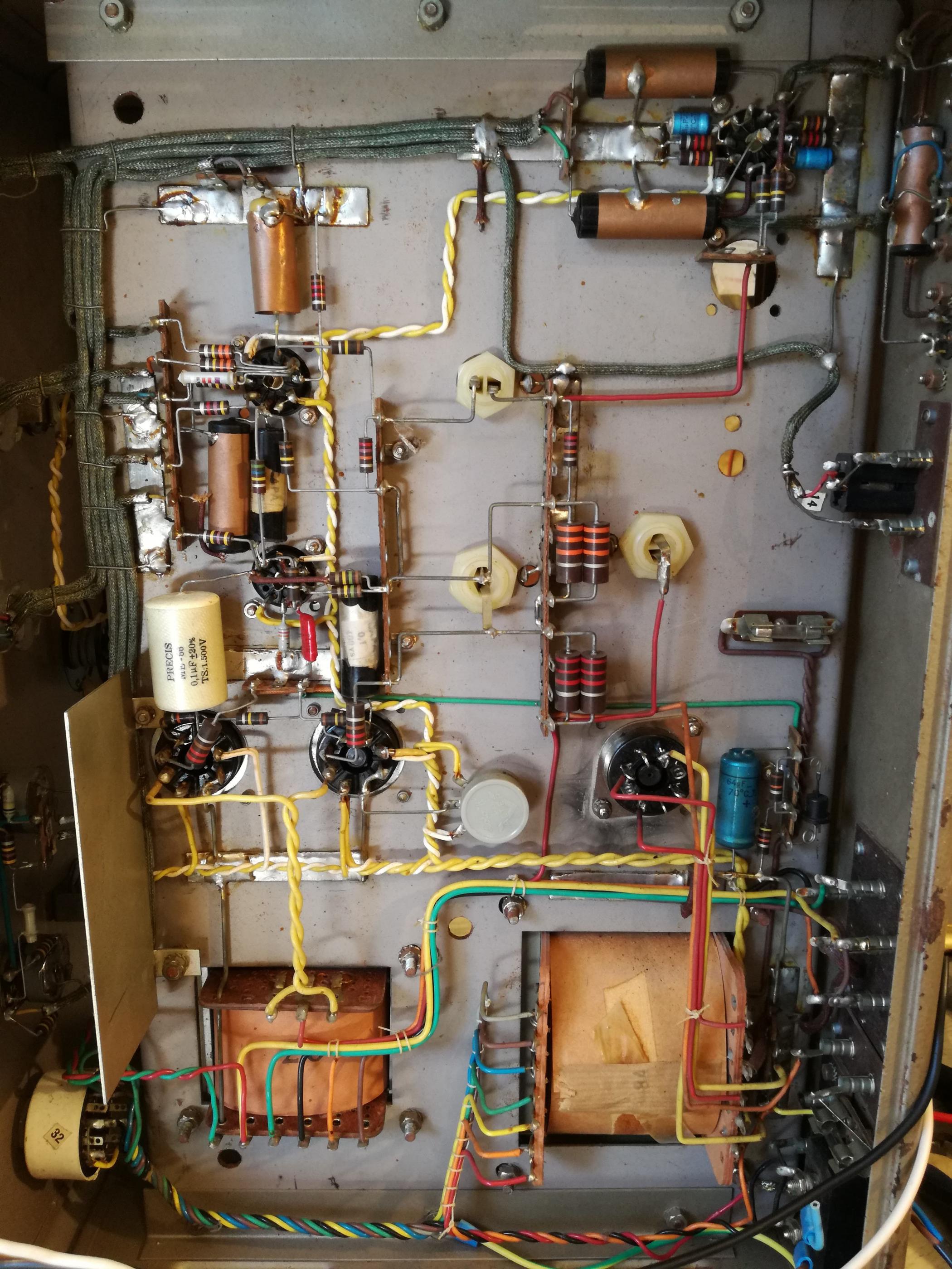

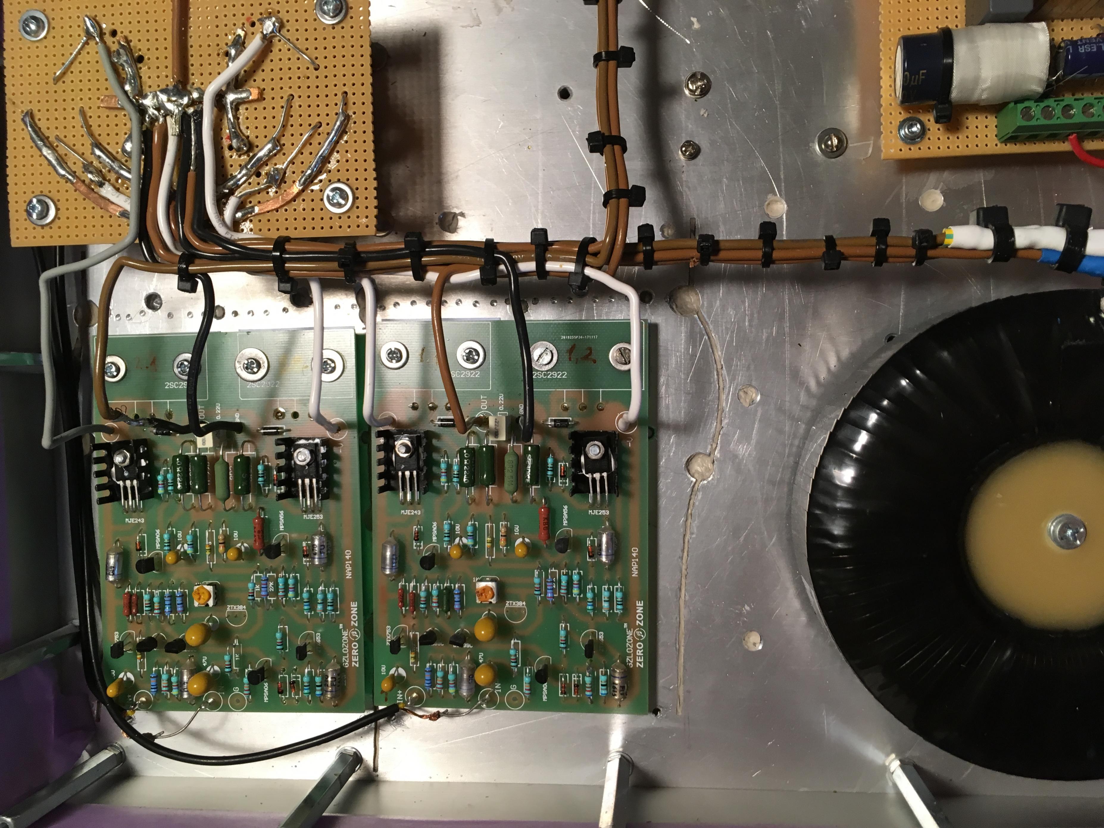

That's very neat wiring on the "toob" amplifier :up: Most of the old ones look like a rat's nest underneath.

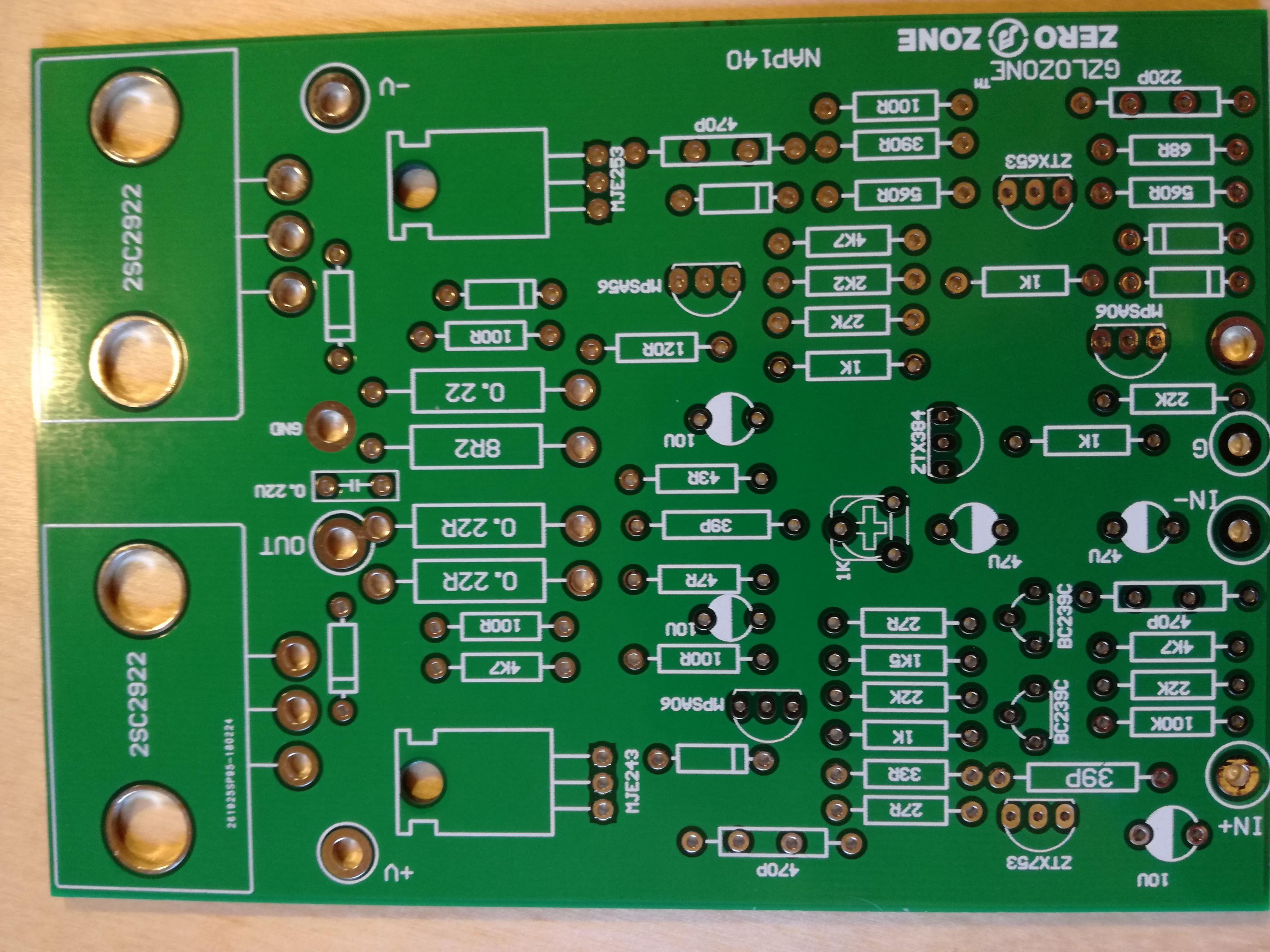

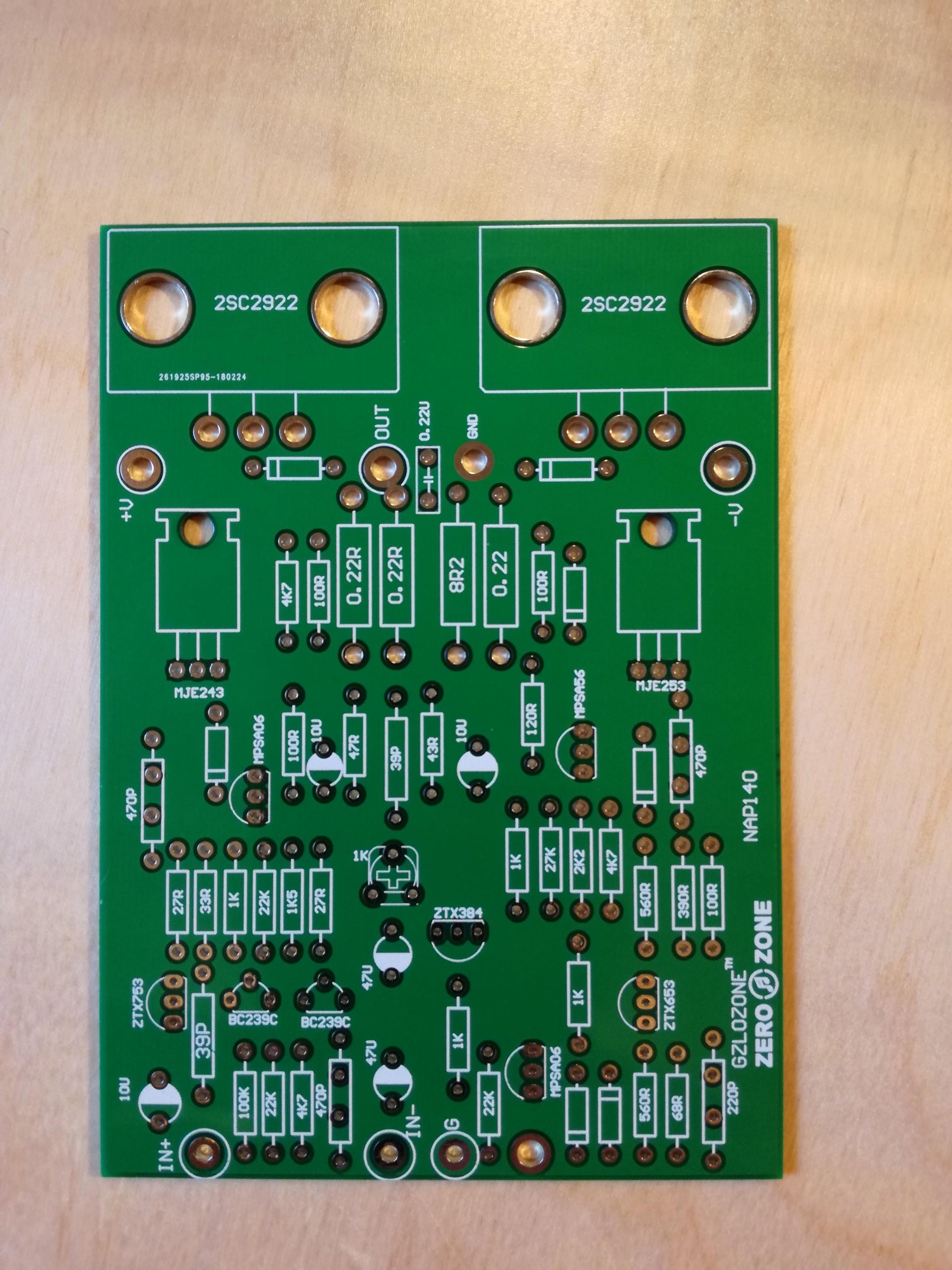

Those PCBs look similar tothe ZeroZone boards supplied in the finished amp I complained about in #3025. The resistor values are not all correct for NAP250, which is what they should be if +/-40V supplies are used.
The difference I noticed was the enlarged transistor mounting holes which allow the nuts and washers to mount on the transistors, rather than the PCB. I'm not sure but possibly that is to enable the PCB to be installed or removed without the power transistors.
Perhaps ZeroZone has confused the component values between the real NAP140 and the generic NAP schematic, which has similar values to, if not the same as the few 'Chrome Bumper' NAP250's I've worked on. Otherwise, how could they expect users to hear decent sound using the strange parts values in their kits? Surely, assemblers test their products before despatch or is this a case of "It may not work but I did try"...🙄
I'm sure you could still use them but look closely at the marked values of resistors, including the trimpot, in the bias chain, between the ZTX653 and 753. You might have to make a few amendments among the 13 x 1/4W resistors in a row there.
BTW - if anyone has determined or located the original NAP140 parts values (any issue), I for one would love to see them posted here by whatever convenient method such as editing the NAP250 schematic and just adding your username to avoid confusion with other posts. Since Naim have pensioned the model 140 and its siblings off, I can't see this hurting them nor their reputation or IP.
That's some really nice P2P wiring there Huggy!
Those boards are the same as the ones I've been playing with (yours are the 2018 enlarged hole version, mine 2017).
Exactly as Ian says, you will probably need to alter the values of the bias chain resistors - The 1k, 1k5, 1k pot if I remember right - to get the bias up enough.

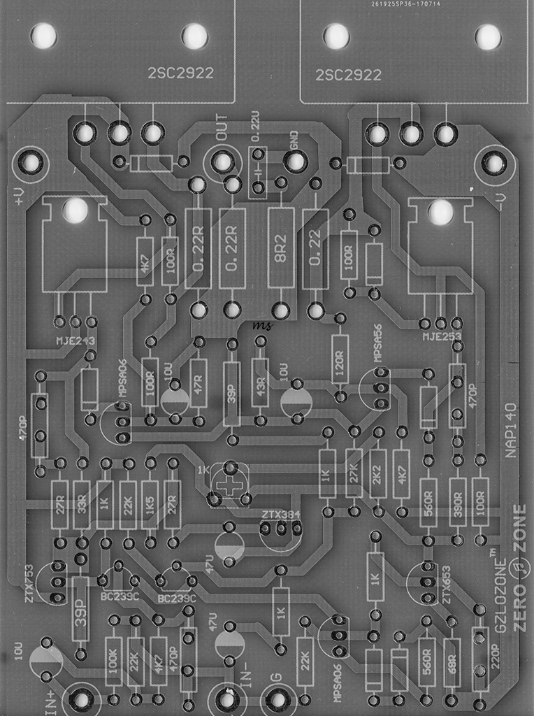

I've attached a double side image of the boards that I had, yours should be similar. A paper copy helped me out immensely whilst troubleshooting and navigating the board and schematic, hope it is of some use to you too.
Oh and if you haven't worked with these boards yet - they don't like being reworked much. I found the mere suggestion of a solder sucker would lift the traces off the boards!

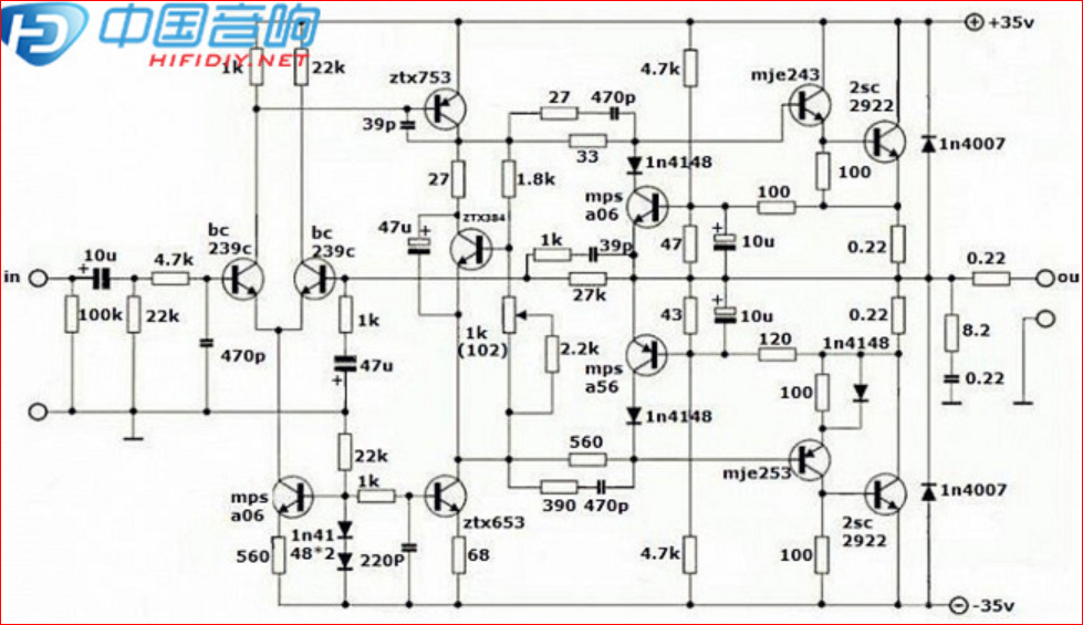

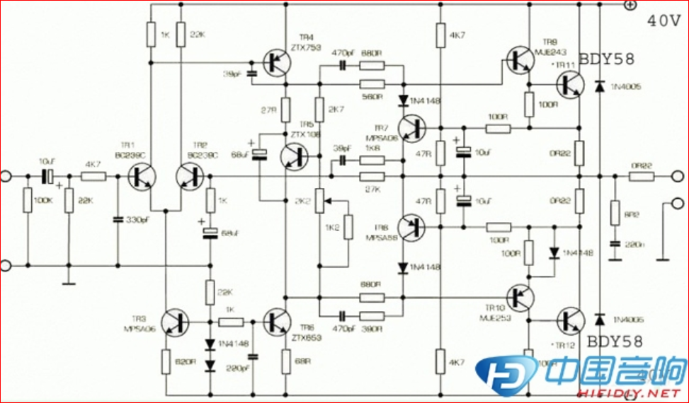

Here is a Simplified Chinese DIY article which shows schematics of the generic NAP250 and ZeroZone's version of NAP140. Perhaps you can see the edited (darker) values where they substituted or amended some of the resistor and cap. values. Anyway, it should make a guide for those trying to understand the layout and correct some odd values seen on their silkscreen in order to set bias. Note the 35V rails instead of NAP250's 40V. At least that is near correct.
NAIM NAP140功放套件DIY制作
As far as I can tell, there are are no logo copyright issues here so I have also attached the schematics. Google translate seems to work well enough with the texts, so have a look around.

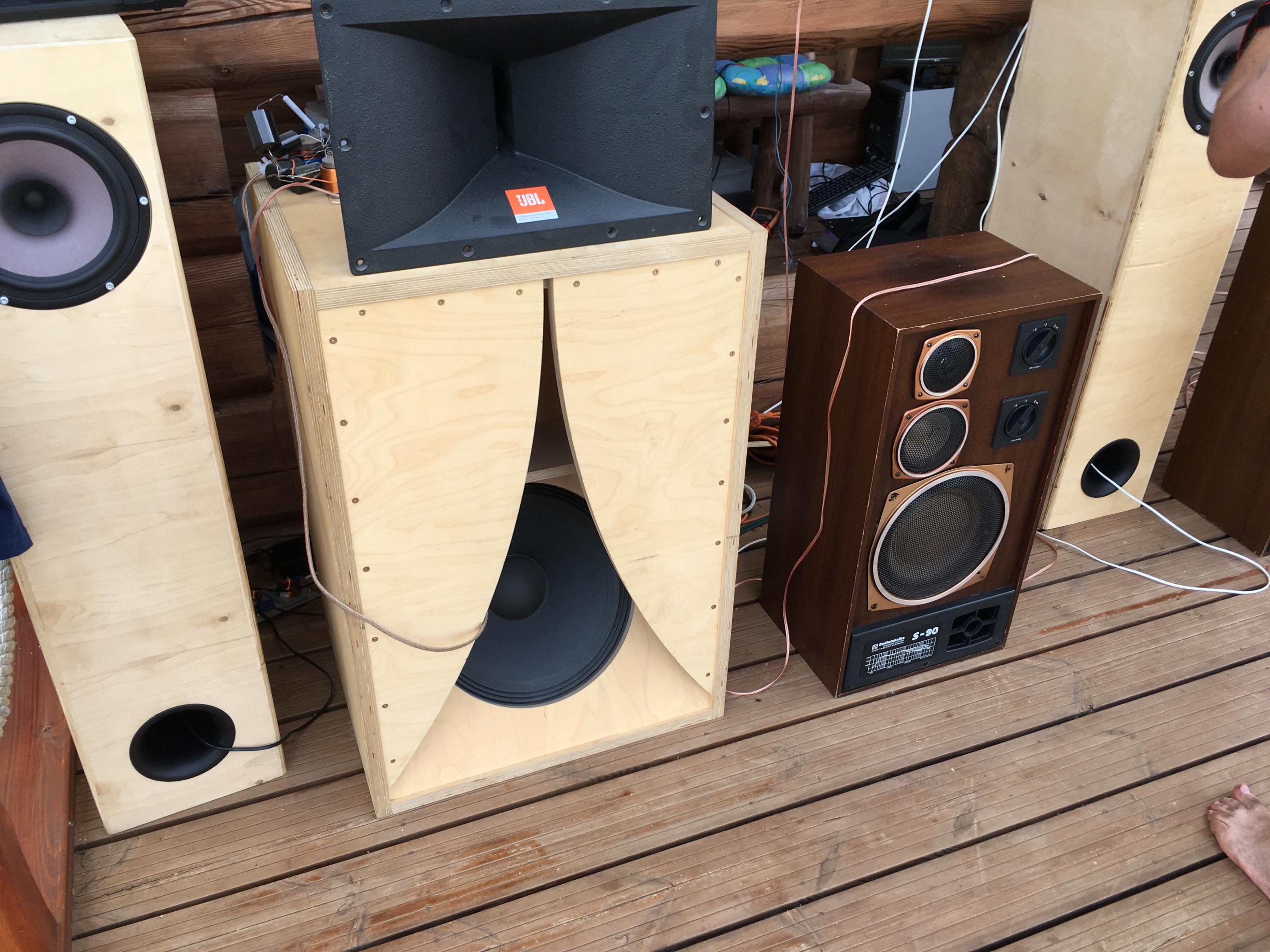

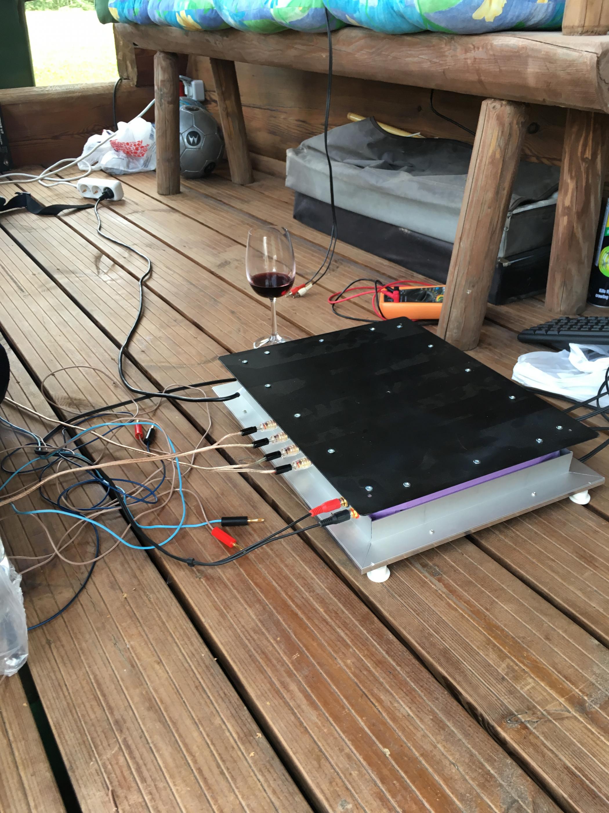

Hey,
I had my chance to power 15" carlsons for a very long listening period @ full power near hearable clipping
We had again:
Philips class D
enhanced with high current output inductors, +/- 40V psu filter and a cleaner PCB/design).
Naim NAP140 Clone
+/- 35V 300VA, 4.7mF psu per channel, very very close build to original.
Crest audio 250W
PA amplifier original
Class B, but CLASS H if more load is demanded, +/-100V class H.
In power output, both NAP and Class D was on same line.
Class D, nothing bad, flat sound
NAP, more alive, alot better drum's separation, maybe more orginized hit- hats.
And all this to the moment when we connected crest 250W amp.
This one just ate everything we offered.
Soundcards were first : Thinkpad W530 that had very strange tonality.
We could not use ASUS U7 lol, it had no gain , everything was so quiet with it.
So comparison started with Creative X_FI HD.
Crest amplifier was connected to Audigy RX.
This build gives less fatigue sound, alot better dynamics, sound more on emotional darker/lower side.
Alot better then plain symmetrical construction !
Changes will come, but after some resistor test comparision i promised 😀

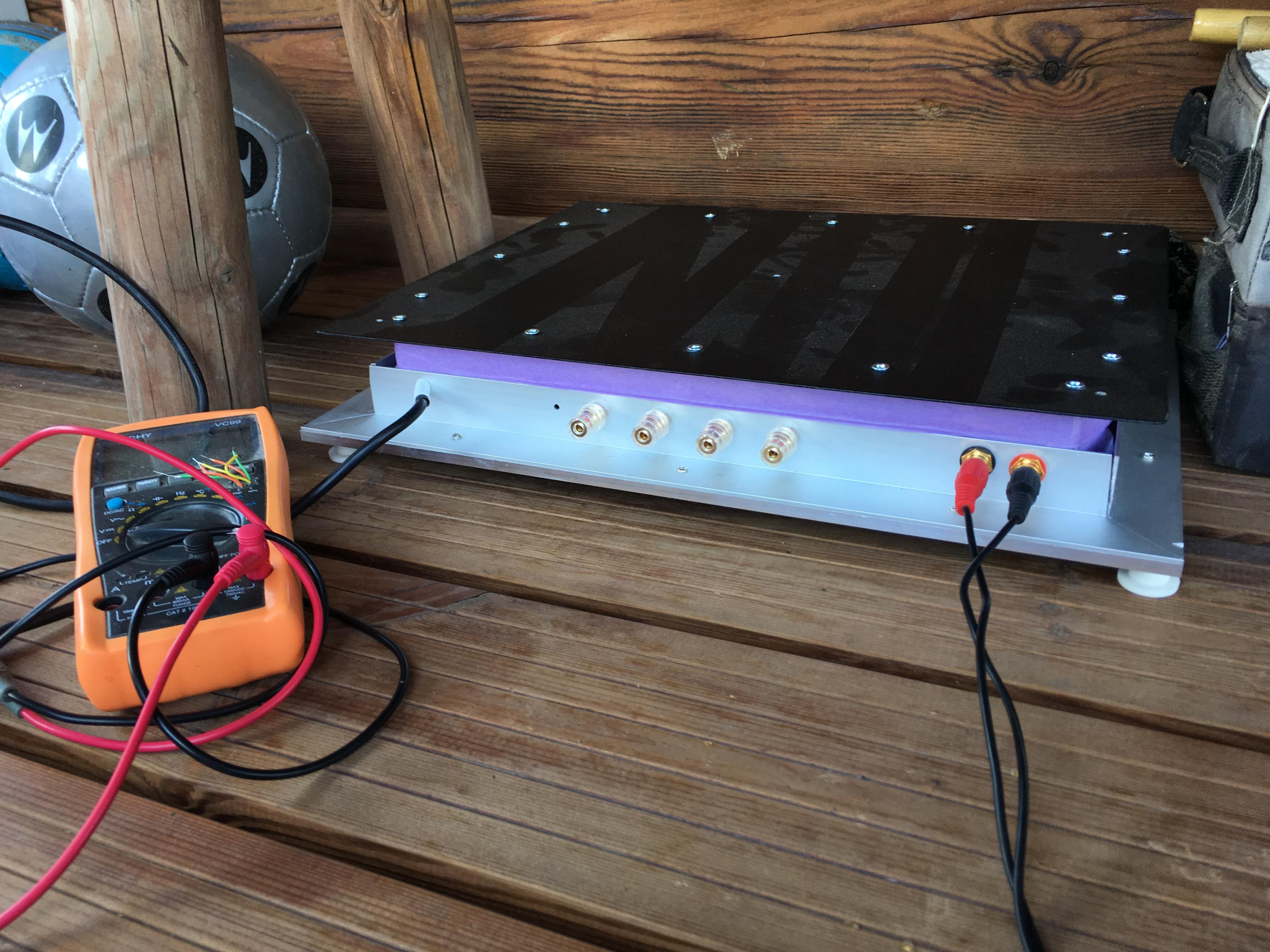

one channel after hours of running +10mV, other +35mV
Lol, i was worried for the speakers when naim clone drived all you can see there, especially 15" inch ... i allready prepared my wallet...
Amplifier plate was very warm, some 50C, but not hot.
Worried that outputs could fail.. i never had a chance to test huge inductive loads, but we played for good long hours 🙂)
