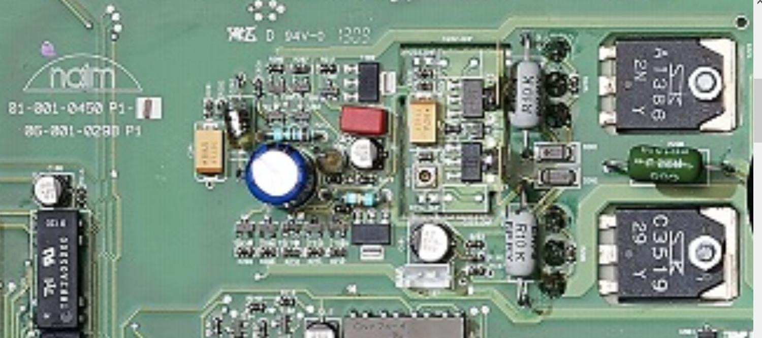

Regarding affordable Naim amplification, there are crossover products like XS2 that retain film caps but virtually all films are eliminated in the Nait i5. We are back to chips and electrolytic caps and the single polystyrene cap that remains in each power amplifier is apparently used for RF bypass at the input. 'Interesting that the infamous output resistor seems to have bitten the dust too 🙄
This alleged Nait 5si image is blurry but shows a couple of polystyrenes, a couple of tantalums and an electrolytic in the feedback.

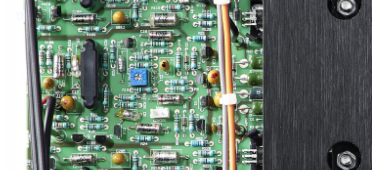

Here's the NAP250-DR up close. Plenty of PS and tantalum as expected. This has the 0.22 ohm speaker output resistor as does the Nait 5si (previous post).

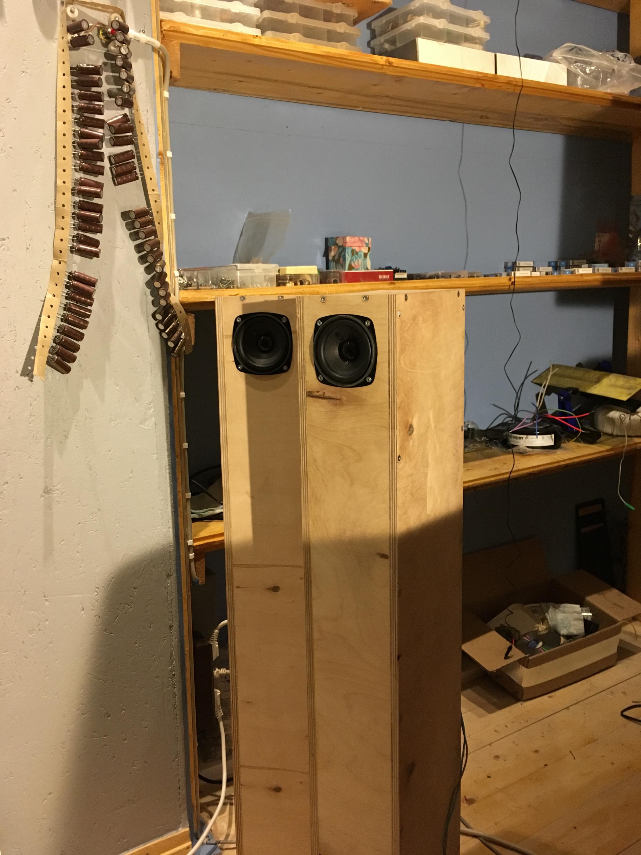

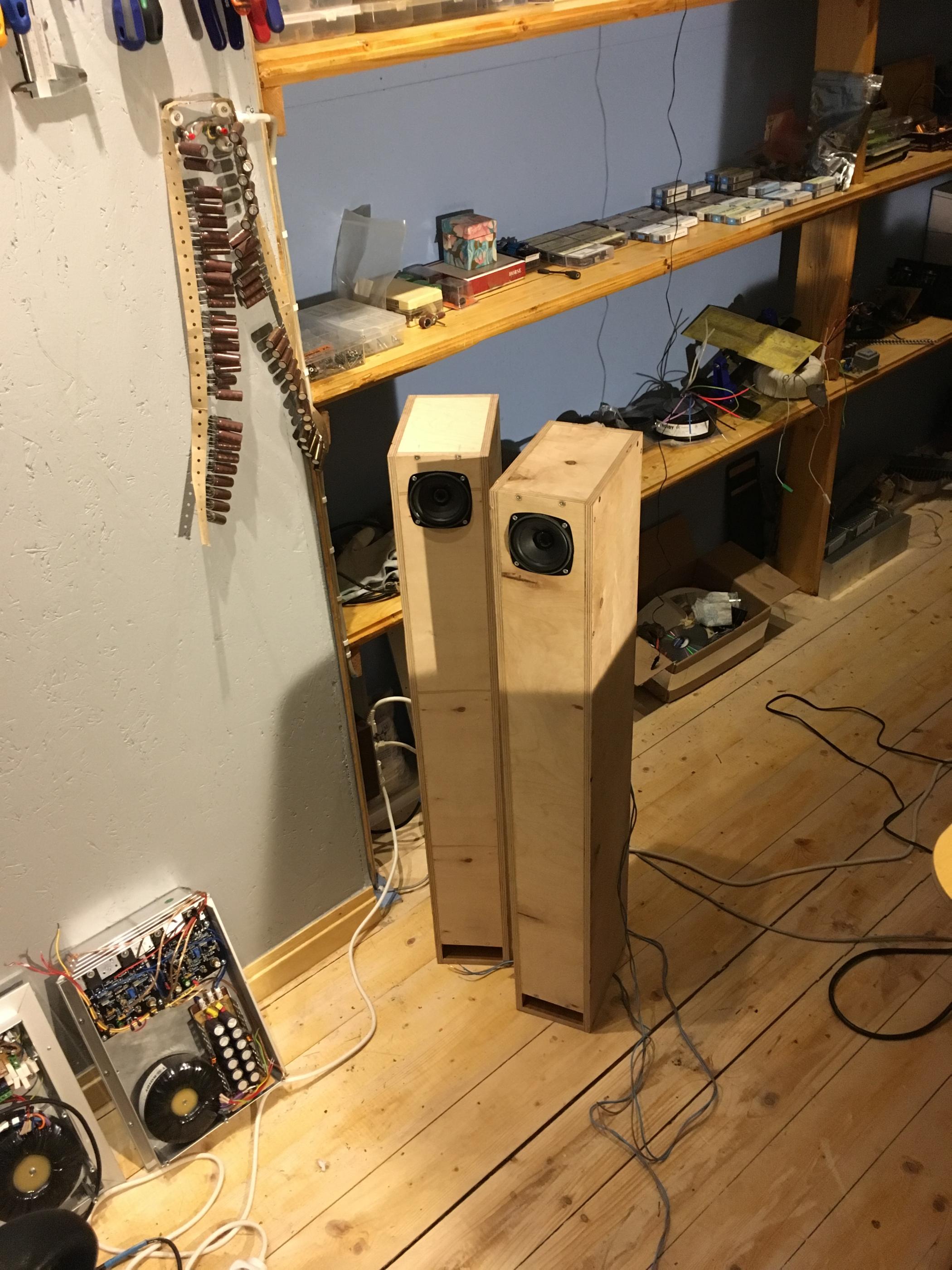

Sorry for offtopic:
I made this speakers for reference yesterday:
needle cyburgs
Small rooms will love needle's. Only drawback is the High's... they are kinda distorded, but not in a discusting way, its FRS-8 3.3" 8OHM
It seems that low end bass is out of phase with higher signals, still not discusting.
End results is great, nothing is disturbing or discusting... just different 🙂)
ATM, LM1875T drives everything i got here😛
FRS8 cyburgs are very Good for Television sets.
About highs... Close Original naim clone, not just some clone, have very soft touch high freq. reproduction... i will pair them later with naim amp circuit...to see if something gets different😛
