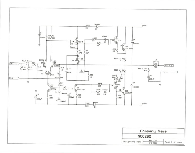

NCC200 and its clones do use ceramics, also a NAP200 clones.

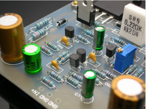

Is there someone who could point me to "low noise/good contact" resistors i can use on H-140 circuit ?
Does anyone know what kind of resistors came with the kit when they were avaible ?
The resistor coating is blue(not very light blue like some "vishay" resistors), lenght is ~6.5mm, they all look nice but i am unable to identify them.
https://www.tme.eu/ee/Document/438bd25d6e61fdb2be01c567fad4b7c7/VISHAY_mbxsma.pdf
Since the H140 pics. are about 10 years old and there are several manufacturers and different brands now, I can't be sure but these MF resistors are a glazed type, similar in appearance to some current Vishay product, as you say.

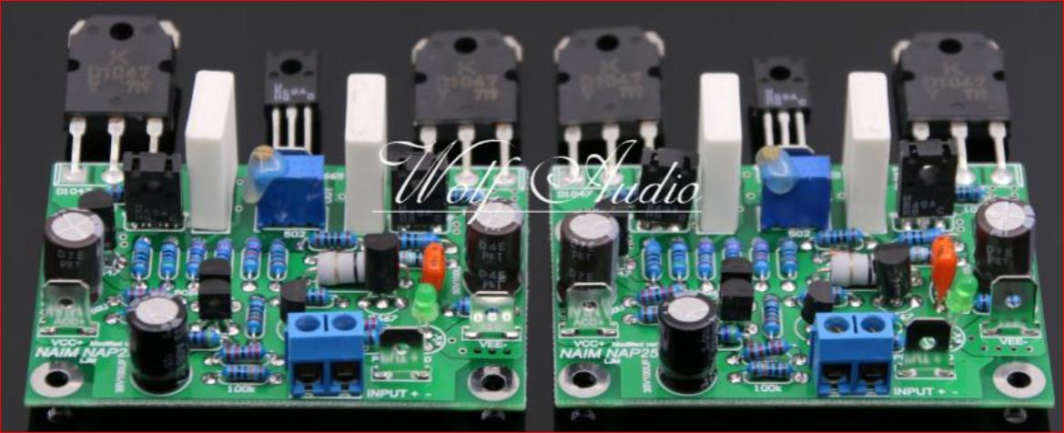

Hi all. I thought it would be good to get back to the thread's OP title occasionally so I had a look at some recent Naim clone releases. One that took my eye is really not a clone as it only has the basics of the original design remaining. Most of the early Ebay clones and assembled boards shouldn't be considered as clones either, since the sound quality will be quite different to Naim's, without the appropriate original components, key semis and the phase correction networks too.
But wait, we can do something about the key parts and this particular assembled kit otherwise has something interesting and very useful to add, if it does in fact work as stated. The feature is that the Vbe multiplier circuit is modified to allow its transistor to be mounted on the heatsink. It looks all too simple and may or may not work as well as suggested by the seller but it would reduce that painfully slow settling time dramatically, simplify setup adjustments if ever needed and allow builders to treat it much as a typical EF design. It's a good idea if it indeed works stably and a great idea for newbies with little experience of quasi-complementary set-up and care.
So, before trying something like this, has anyone else considered this particular clone design, used it or have a little more information on it?
[Link removed]
I wouldn't pay much attention to the NAP 250 title since that is a regulated supply design and there's no other way way this kit is going to deliver that sort of power into 4 ohm loads. Realistically, +/35V supplies giving NAP140 performance and power will be plenty for audiophiles on a budget 🙂

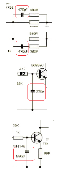

I really can not tell the difference between ceramic or polystyrene if used in these positions: Red marked capacitors.
