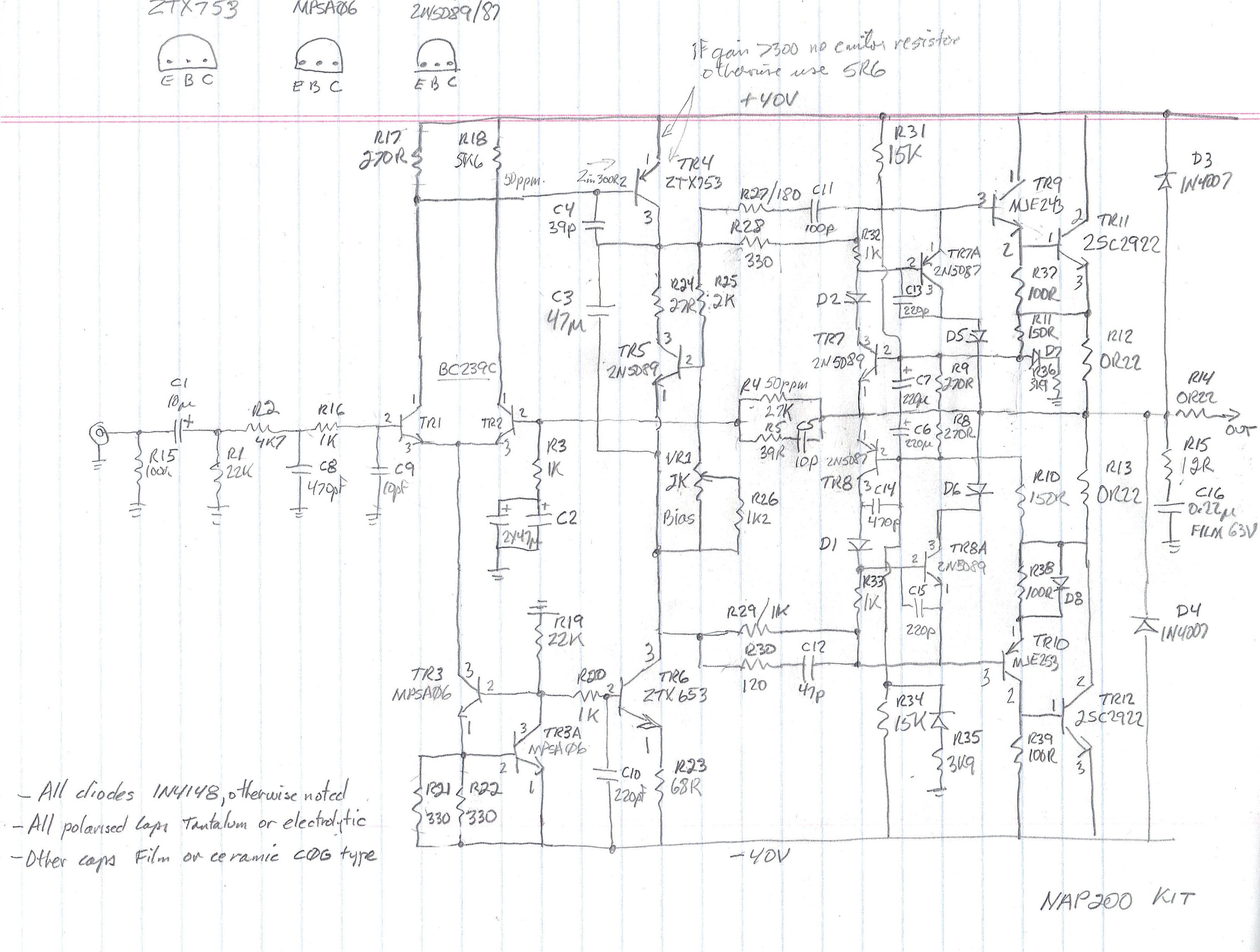

The only kit out there that falls into the present generation of models is the NAP200 so using the low cost kits and the only schematic available, you'll be following the early models - simple, cheap and small but also tricky to get them quiet and performing anything like the originals.

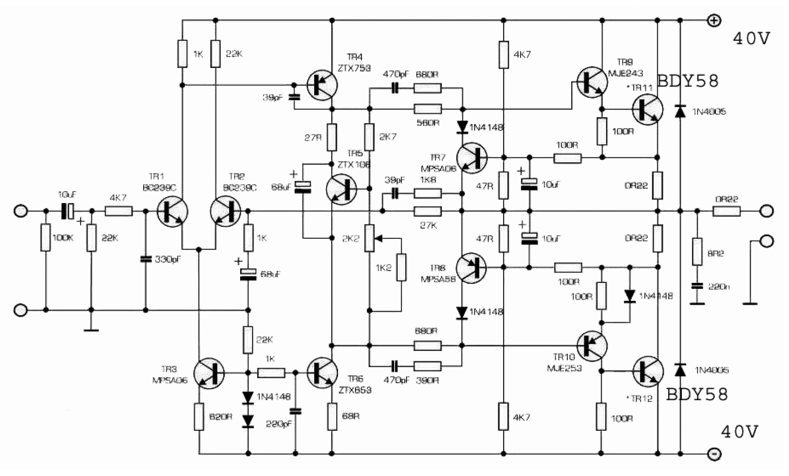

Started my sims with two clone versions: Neil McBride's and Avondale's.
If anyone is interested I can upload the asc files here. Then perhaps someone can chime in what mods or changes worked, and which didn't.
None of them is particularly good in THD, particularly at 20KHz: 0.42% on McBride's, 1,13% on Avondale's.

You would need to follow the thread (at least the on-topic posts over the last couple of years) to find most everything that has been discussed about the the NAP design and some obvious variations in each model over decades. There is no approved design here because this is a kit clone thread and there are issues with kit parts quality, original parts availability and their being genuine, that are more important to sound quality. That's the focus with cheap kits which are notorious for inappropriate parts selection, types and grades.
If you google "Naim schematic" or read Ebay kit details, this official looking schematic is what you find and I'm sure you've already seen it:
Free diagrams, schematics, service manuals beginning with N :: Schematics Unlimited
It is designated NAP250 and, as you read here several times, certain component values vary between models and series where the original parts specified are either obsolete or later versions are different, wrong Hfe type, not matched to some manufacturing tolerance etc. Naim were known to reject whole batches of components for various reasons, I guess it was specs that couldn't be met by selecting parts on test.
As very unconventional manufacturers, Naim did quite a bit of parts testing and selection which is expensive, so they passed that on in high ticket prices. I looked at pics on the internet to determine the correct component values for NAP 140 and I already had experience with repairing other models where I realised there were ongoing variations and in all models. That means, for critical functions, it's an undisclosed specification you need to match, not just a part number.
Bigun discussed parts selections for his take on the NAP140 and as his choices were quite different in some respects. It will be worth your while reading his TGM 10 thread to identify the design choices that mattered in his view.
For a more recent model with schematic taken direct from the PCB, read the posts about NAP200 and locate algar_emi's reverse-engineed schematic. That will give you known, good quality sound that has been verified by a few builders here. I did so and I'm very happy with the Caowei kit build which came with the correct parts types and only needed a few more to get a match for minimal DC offset. That's the way to go, if you want original
I doubt that anyone just following that NAP250 schematic or any other would be rewarded with Naim sound quality. Most likely, a straight design copy or kit build will sound unspectacular - mixed quality and like many generic models from the 1970s. However, you can start to correct it by calculating bias currents for TR3, TR6. From that you can adjust the emitter resistor values for your particular rail voltages accordingly. NAP 140 had 34V, not 40V regulated rails as shown so there are some minor changes to make already. The next step is to secure the most appropriate transistor types, Hfe ranges, matches and substitutes. That is a long topic and I don't plan on cranking through every possible option again myself, when its been covered in this thread a few times.

Later on I will sim that hand written NCC200.
For now I am uploading the NAP250 simulation I did, using the Schematics Unlimited circuit.
The only component I did not have a model for were the output transistors, so I used the MJ15003.
You may note that I did not connect the cap + resistor compensation over R46. That is because the circuit oscillates on the LTP, increasing distortion.
20KHz THD is still a bit high at 78W: 0.33% Certainly it's lower at 1W.
If anyone made other sims and got different results, please chime in.
I can't seem to run AC bode plots, which I'd like to see. Don't know why.

A problem with simulations is that models aren't available for all the semis and their variations that were originally used. It is pointless simulating something using an arbitrary set of substitutes only because that's the nearest models you can find. The BC239C was selected because it had the highest guaranteed Hfe of 400-600 and I suspect parts even from that high range, were still selected on test. I understand that 2N5089 (selected on test) is a reasonable substitute for the LTP. The output transistor type has been several different types but never the slow Motorola audio types. Try an LAPT like 2SC2922 or On Semi NJW3281, MJL3281 etc.
To give an expected area for THD, even the Nait 2 (entry level integrated model) measures below 0.02% in the real world.
