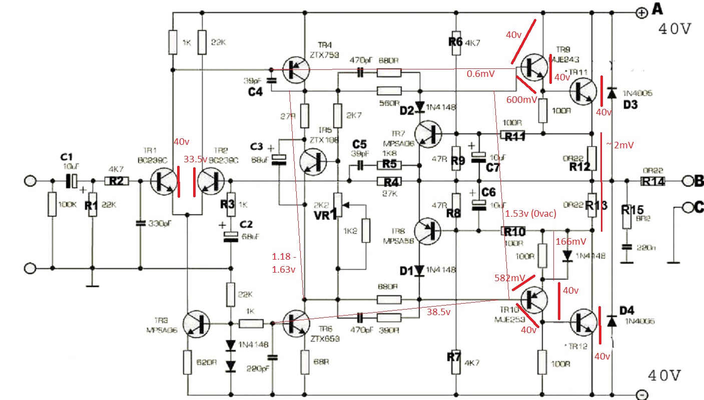

I took some measurements and I'm not sure everything is ok even though I am getting getting music out. Both LH and RH board measurements are comparable.
Measurements with 40v rails, no input or output connected, amp run for a period of time enclosed but didn't really warm up. Bulb limiter bright then dims as normal, removed for measurements.
Output transistors (2SC2922) I get:
C:E = 40V
C:B = 40V
B:E = 600mV
C:E = 40v
C:B = 40v
B:E = 582mV
Drivers:
C:E = 40v
No significant voltage between TR4(C) : TR7(B)
Significant voltage (38.5v) between TR6(B) : TR8(B)
Bias generator voltage TR4(C) : TR6 (C) = 1.18-1.63v (Range with trimpot)
DC offset is around 7mV.
I've attached an annotated schematic.
A little unusual selection of test points 🙂 ... but they give some idea.
The circuit looks OK. 1.53V is just what it should be.
Now, you've rounded too much the 40V measurements and it's hard to tell what are the currents. I have suspicion that the input pair may have slightly low current. Can you measure across the 620 and 68 ohm resistors on the bottom of the schematic. That will give info for the currents in the LTP and the VAS stages.

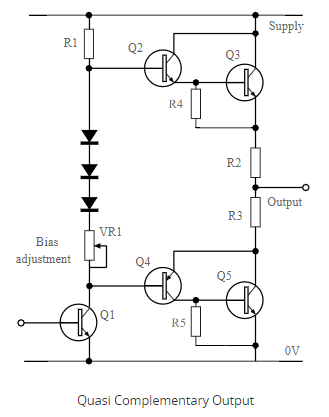

This is specific to quasi-comp. designs: Quasi Complementary Transistor Output | Radio-Electronics.Com

I went through the test points that Bigun wrote a couple of pages ago.
I've since measured all of the transistor B:E to make sure they are at their turn on voltage. All were dropping around 600mV, so all good there. (Except the outputs were dropping about 150mV).
I had a good look at the board versus the schematic and decided to change the VAS resistors to reflect the schematic. I felt that this was the limiting factor for the biasing voltage.
The PCB had:
1k pot instead of 2k2
1k5 instead of 2k7 between collector ZTX753 and TR5
2k2 instead of 1k2 at the trimpot
Once running, I got free movement of the bias as far as runaway so I am happy that the board is behaving more as it should.
I set the current to a nice stable 25mA while warm (and the output transistors are now actually warmimg up). I could also see the thermal coupling effect by touching the ZTX 753 and 653 - the bias would drop a mA or two then recover as it heated back up again.
But as always, the proof of the pudding was in the listening.. It sounded clearly better than before - I didn't need to turn the dial too far and the sound was much clearer than before.
Next step, get some genuine output transistors and see if it can sound any better!

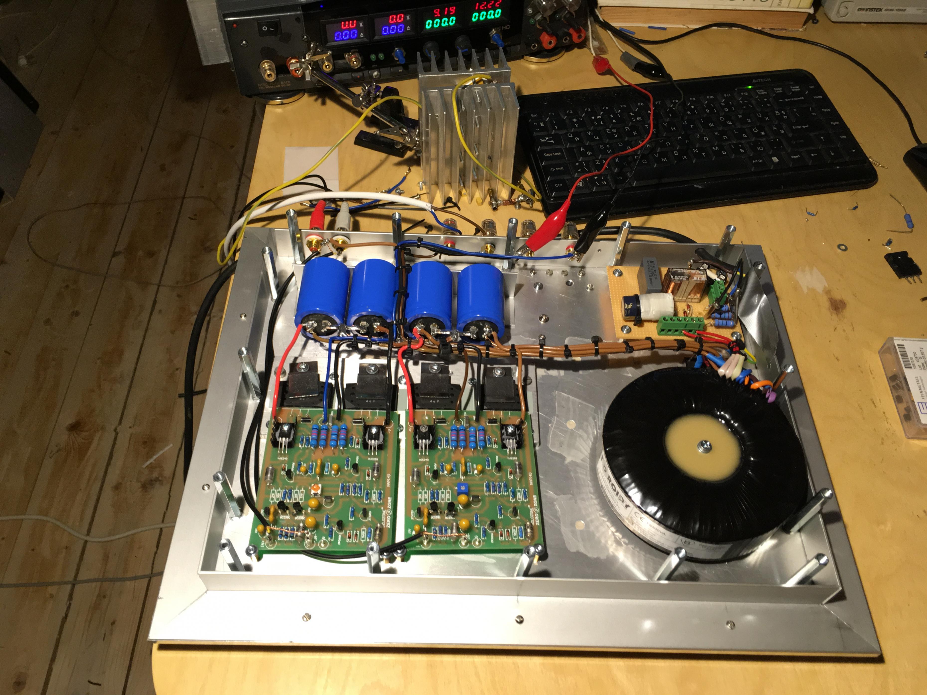

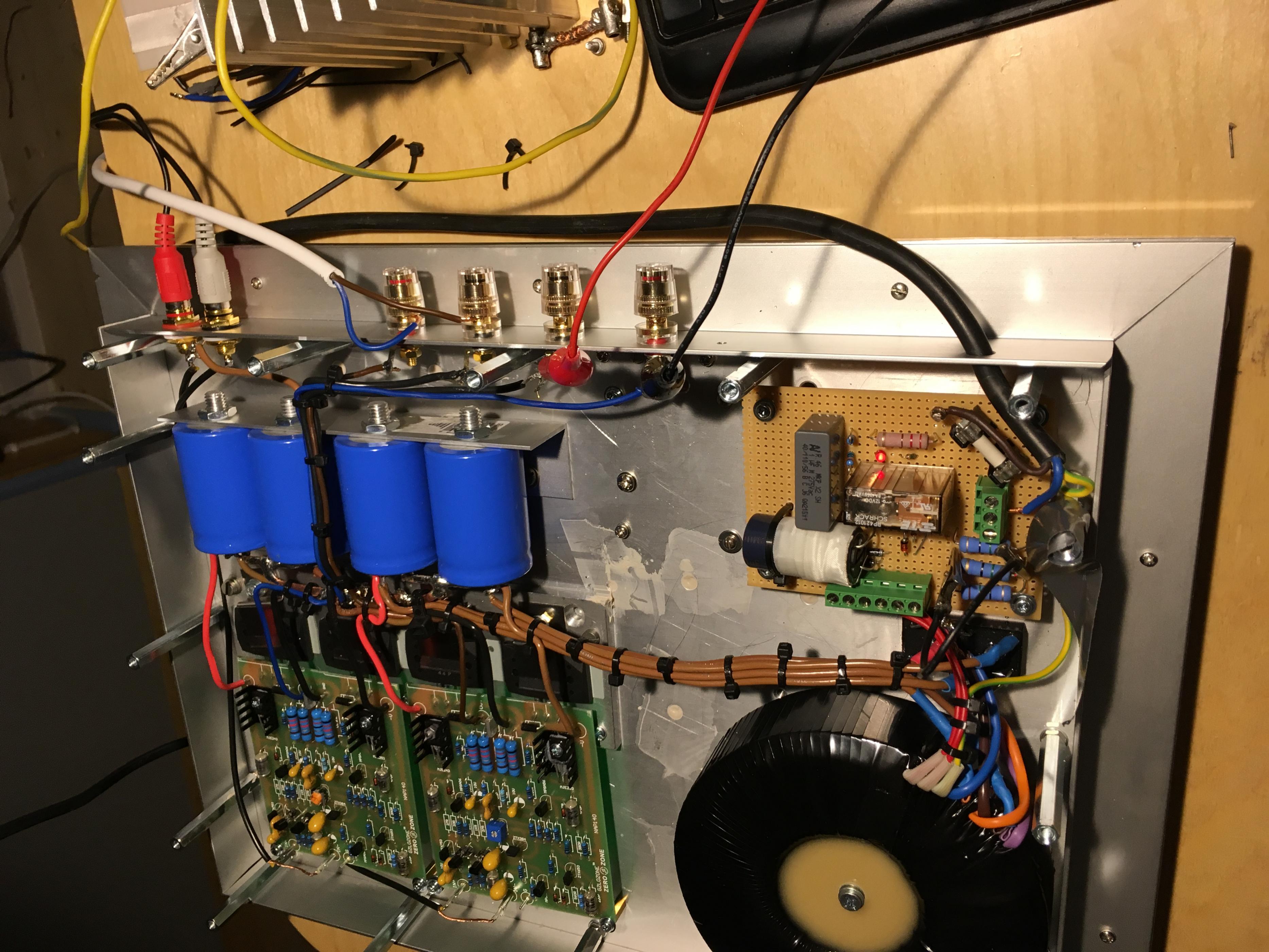

Hi again guys,
As you can see, i have finished full naim as close i could to the original.
In short:
My transformer voltage is rectified: 2x35V DC @ 238V AC mains, Power rating: 300VA
Cuz of that overkill Xformer VA rating i wanted to ADD DC protect for speakers, just in case... VI LIMITER is not enaugh if 2SC2922 shorts ;D out
I couldn't do it with relays, not either with MOSFET(tried LOW RDSON type and IRF540 type.
Both methods RUINED the sound quality... The Sound is softer and liquid without the PROTECTIONS..
On LAST two photos protection are removed.
I am listening to it, its very very musicial lol...whats wrong with ppl who mod this stuff ???
MY PSU ARRAGEMENT is 1:1 with naim !! Bridge rectifiers are almost the same type(604 series).
The only drawback is the capacitor bank... i dont have high quality 4700uf barrels... so i used:
10000uf 40V barrels...🙁
Also, the NAIM amplifier and i belive all of them does not sound in free air...
The circuits idea is to get warm and stay warm for pleasing sound!

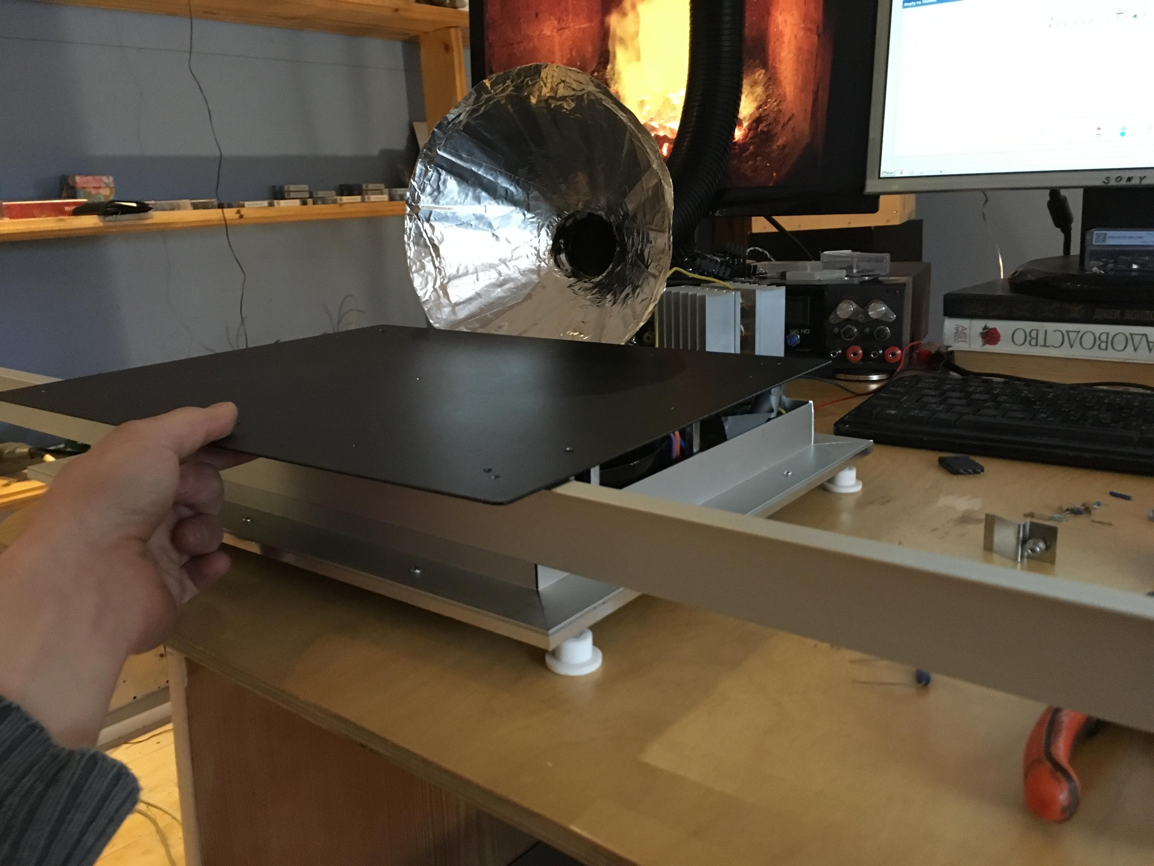

That new build of yours looks very good with those ZeroZone PCBs and your classy tying of the power supply leads
That's also an interesting way to build the enclosure. Is there a wide gap between cover and case? I would consider closing any gaps to ensure Bias tracks with output stage temperature as well as possible, if so.
Thanks guys
There will be no air gaps.
On the photo you see Black metal plate ordered from toroidy.pl and a L-aluminum profile anodized.
PLYWOOD will be used instead of black metal cover, to keep amplifier warm...
The buttom plate is very thick and enaugh for everything 😛

Filters used:
33R & 27R into MJE 243 base
560 % 390 into MJE 253 base
All original 2SC2922 (44P) are 111+ HFE when measured with chinese transistor tester @ 20C ambient.
The 2sc2922 (81 Y) that came with the kit are too low HFE (33+) and they'r weight less then the originals, i let them be and did not used them..
15g vs 18.33g
The amp drives beta 10 cx bass reflex type.
Next build will be NCC200 with 200VA 39V DC transformer.
15g vs 18.33g
