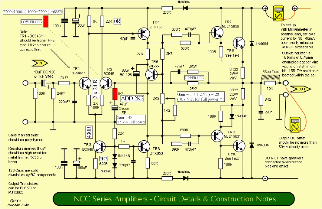

Is there a chance with these black PCB-s for NCC200 ? They got all the neccesary traces for the purpose.

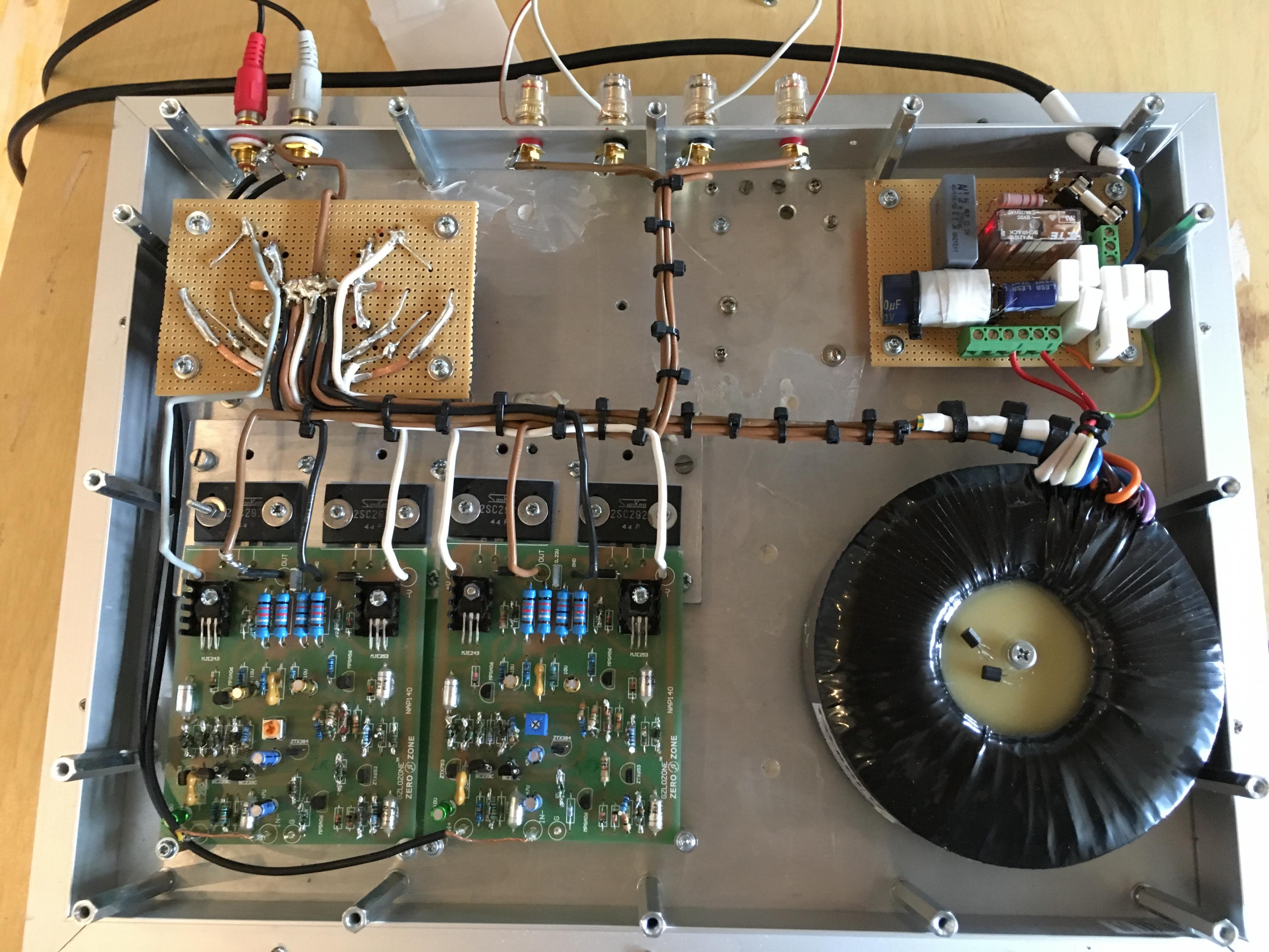

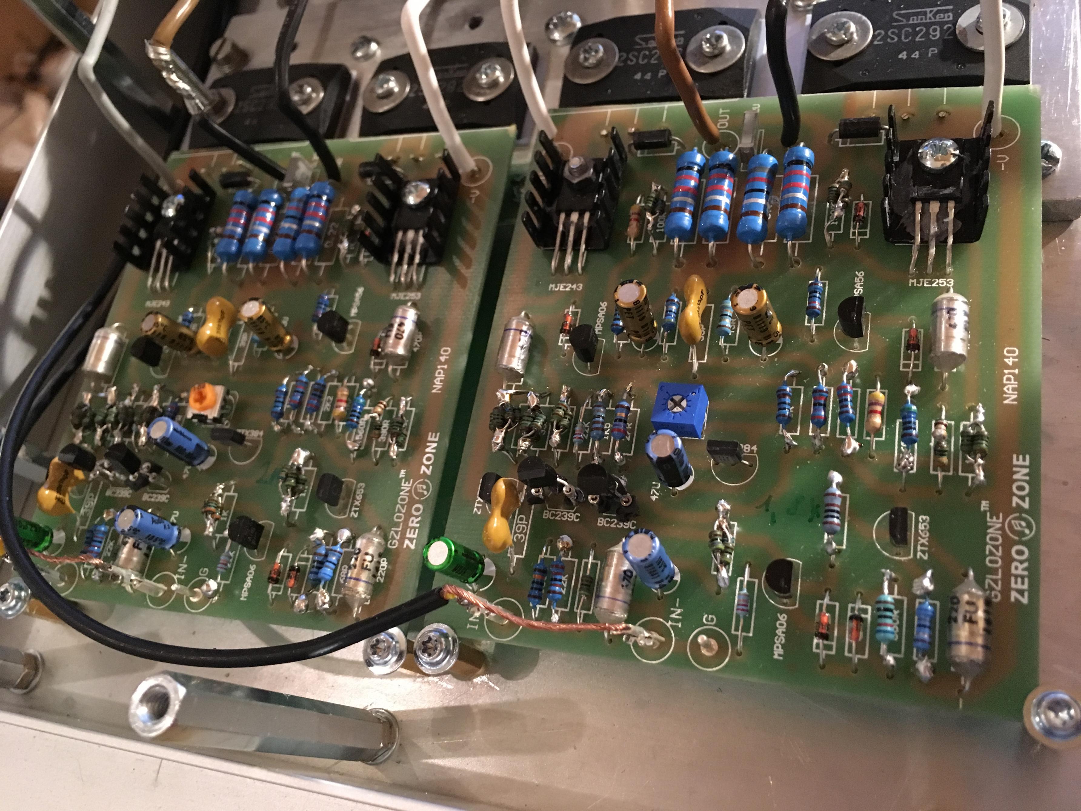

I did today few fixes to naim:
Can't find a tantalum capacitor which suits the circuit...its sooo impossible..
Replaced all with electrolytics that also sound similar to tantalums...they got that ESR😀
Gonna listen that way for few weeks.....
all of my old stock and the good times.
the output transistor are bd911
it works in 33vdc
the capacitors are in 50v 10000uF
the wire is in 1.5mm
the tantals are in very low resistance series

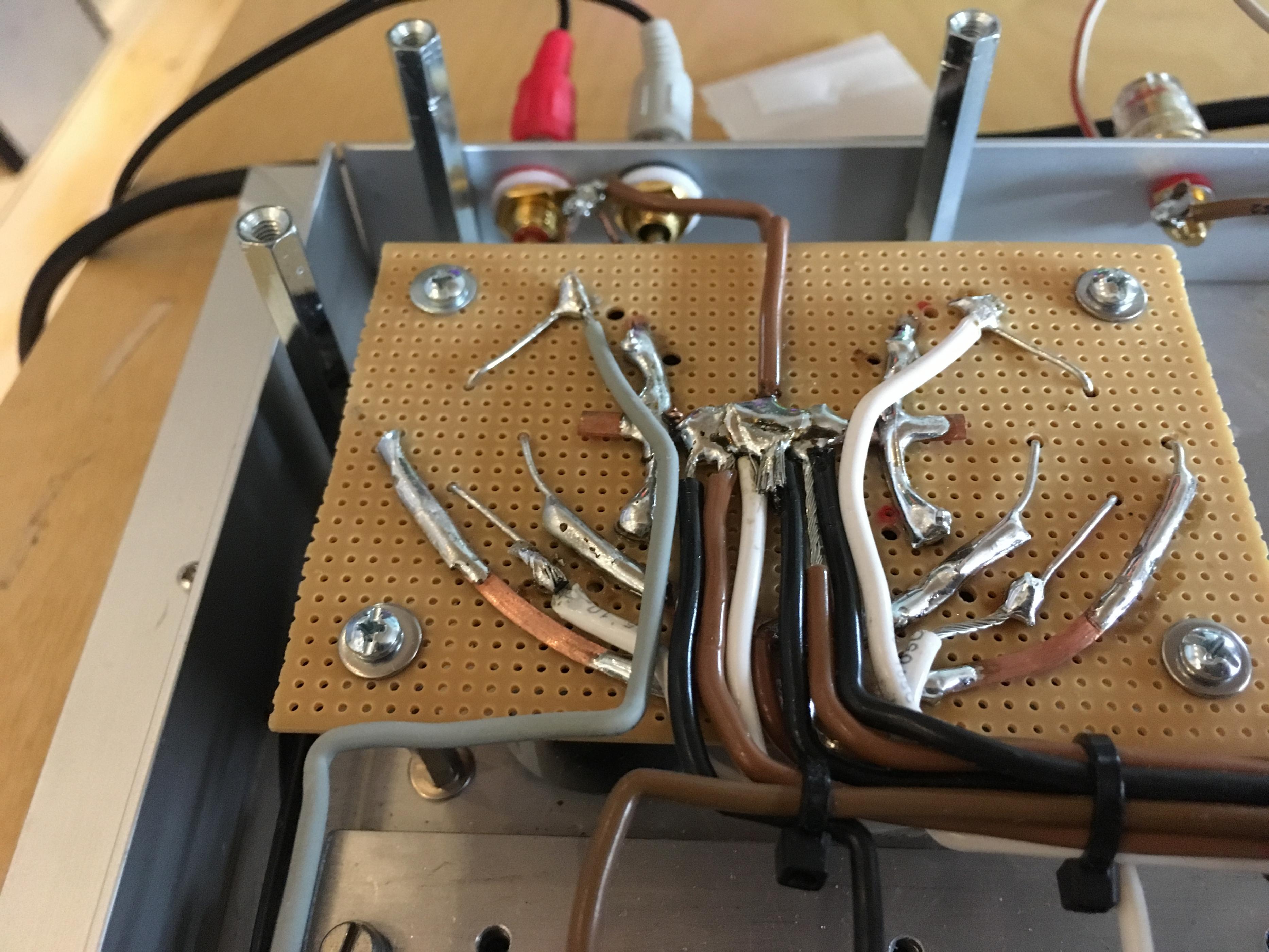

I have wired with 1.5mm, 2.5mm and 1mm wires... i use 1mm now... seems more right to me @ short distance.

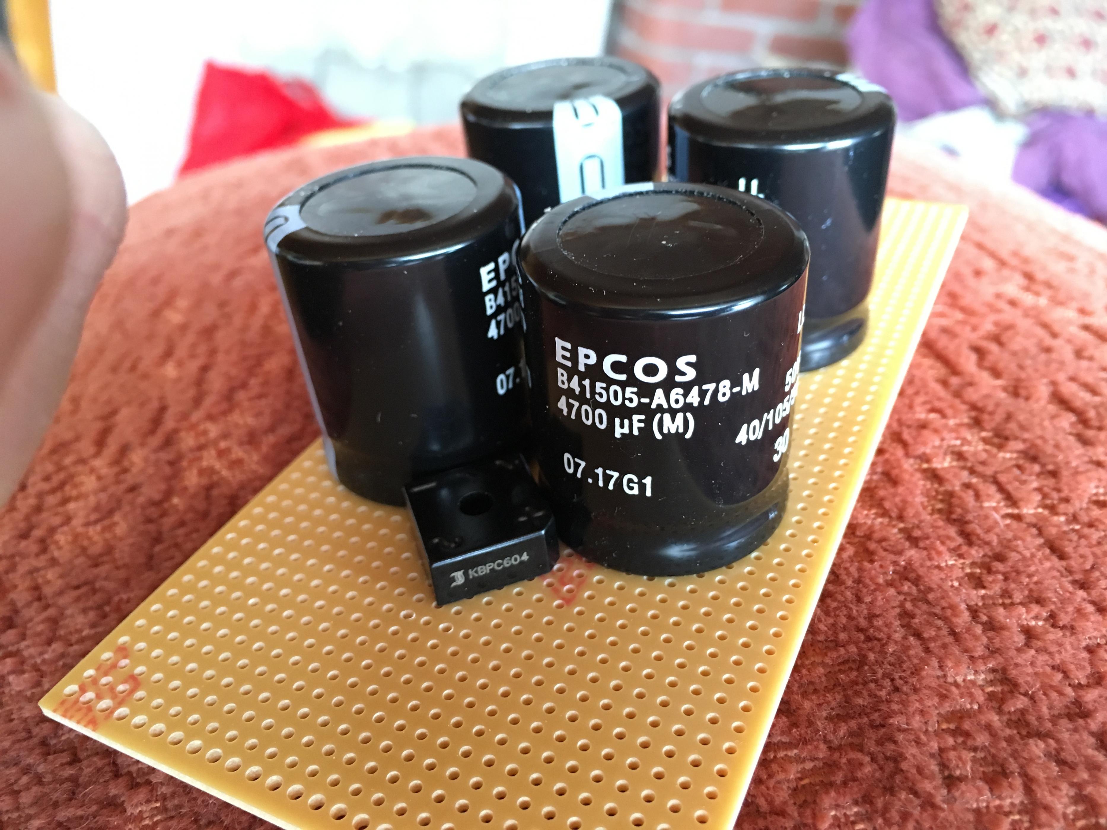

got the hands on some 4,7mF barrels, also ordered panasonic and lots of other tantalum capacitors, will report when i get results
2x4700uF and a KBPC604 sounds alot better, less bass but amplifier is alot less disgusting.

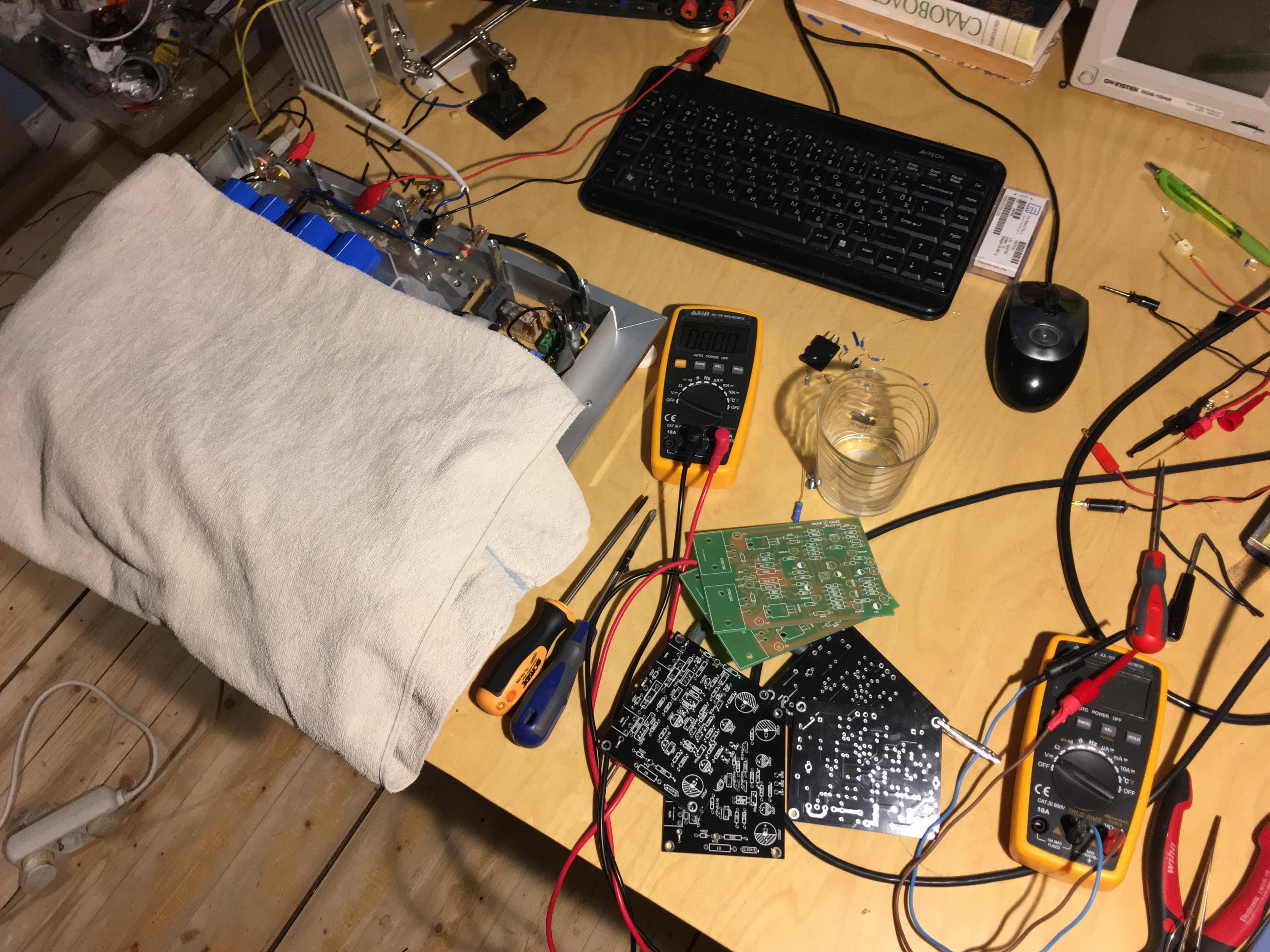

I have tried everything i could think of
It means living with mods, taking my amplifiers away from home to get other opinions and so on....

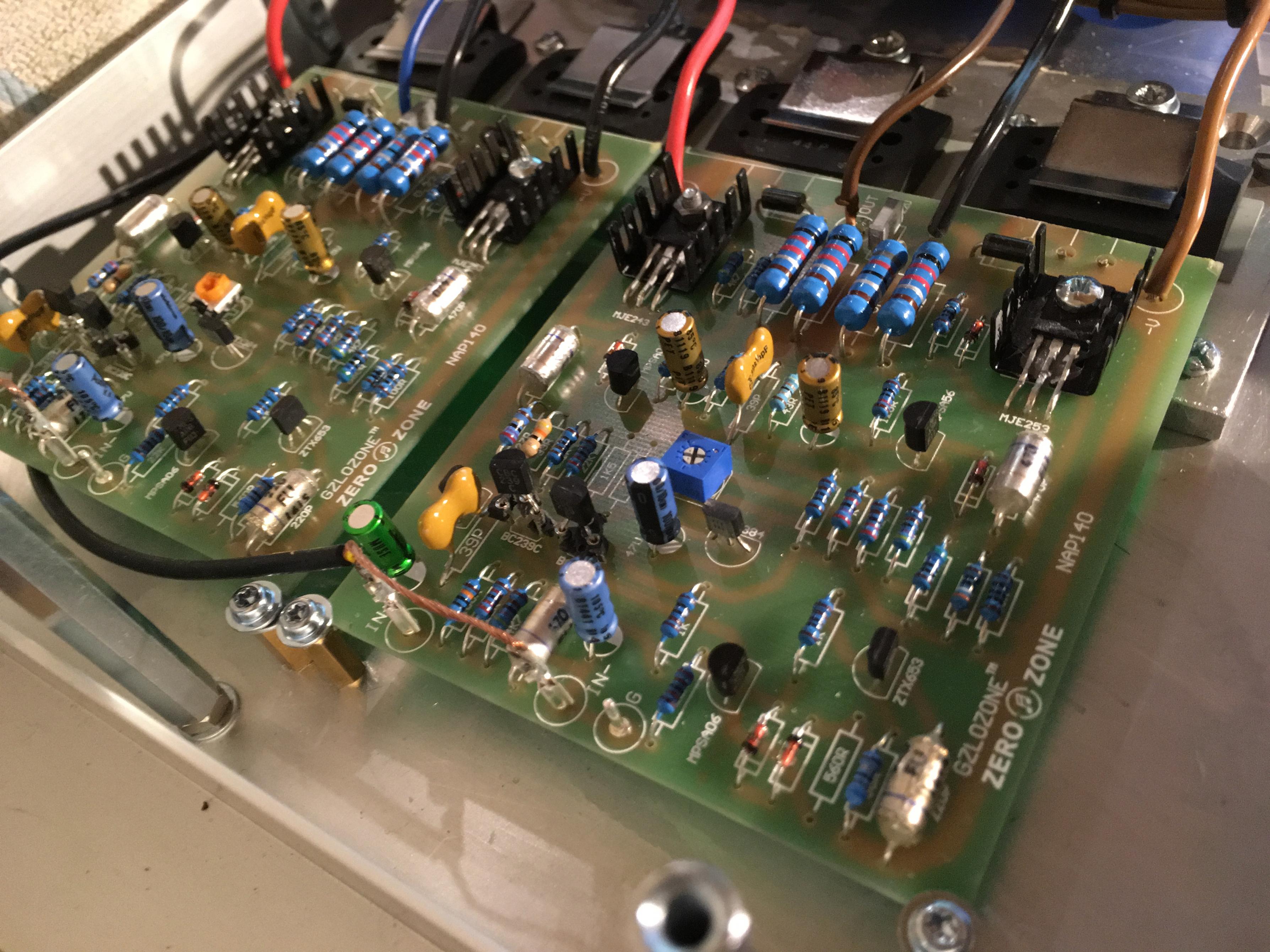

I am changing resistors back from paralleled combinations to 1% metal film resistors on the board.
Compared to my previous 2 clones, this one sings the best, it feels like they started to get a long with each other, the amplifier boards i mean.😉

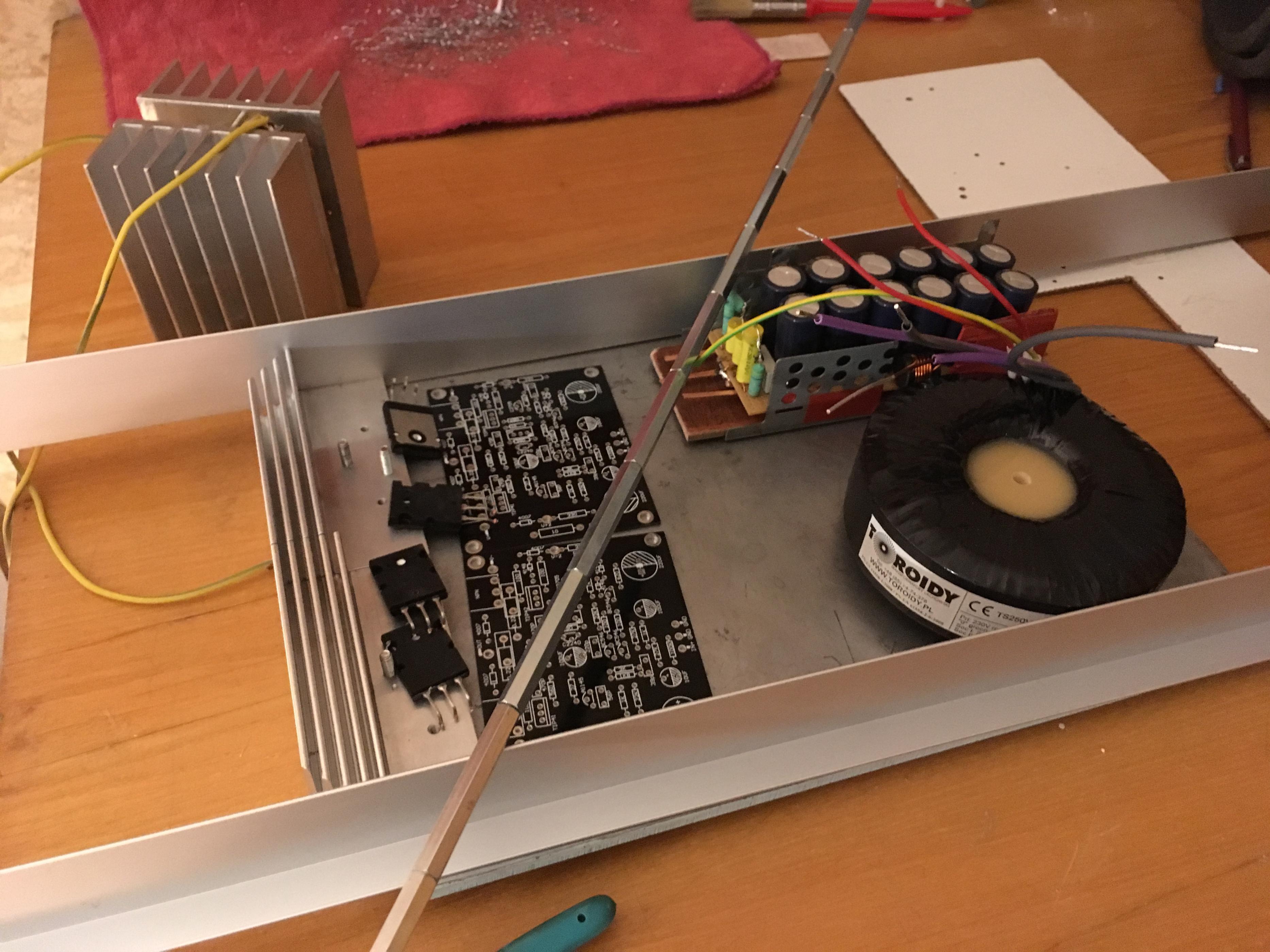

I dont want to DIY anything more then a NAIM, NCC200, speaker boxes and amplifier CASES.
DIY House would be nice also, nothing else 😀
Will keep my eyes on ebay for complete NAC42

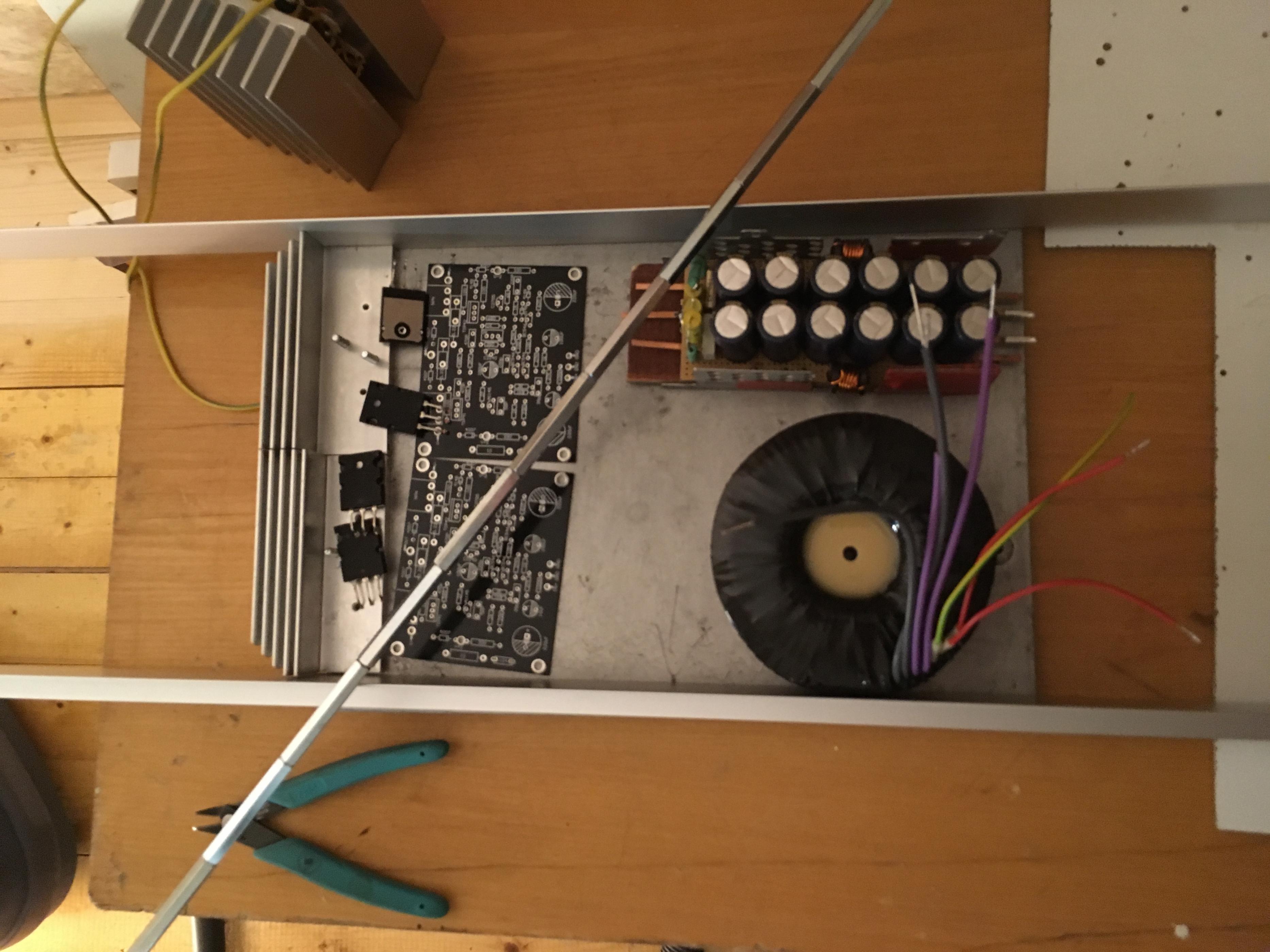

But now, i will start the NCC200 or NCC200 chinese version.

ncc200,
Yes, i will report if everything is ready, corrected and tuned.
My first amplifier was H-140 from china(KIT).
It had very good sound... until it took my speakers and itself into destruction...
5A FUSE was a big mistake... if I had not been home that day then there would not be any home left 😡
But imo it was the best sounding (CHinese ppl gave good transistors with a kit).
I will try to repeat it with 200VA 38.5-0-38.5 V rectified DC and a pair of 2SC5200 highest gain i could sort out from my savings 😀

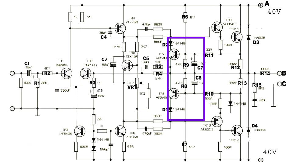

Try to remove the two 10uF caps and transistors based on this schematics. That would improve the sound a lot.
All in the purple box plus R6 R7 and R10 & R11
