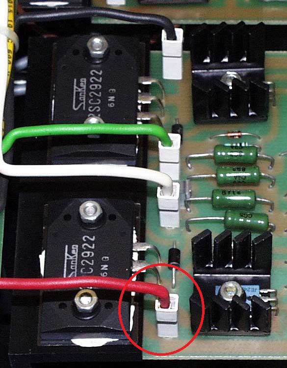

Hi
Wondering if anyone can point me in the right direction to get hold of some of the PCB connectors I've seen around the place (highlighted on attached photo).
I've had a good dig on ebay and google but the best I can find are either 2-pin or don't have a single through-hole attachment.
I figure this will reduce the time involved in desoldering/resoldering 6 wires per board every time I pull the PCB.
Cheers!

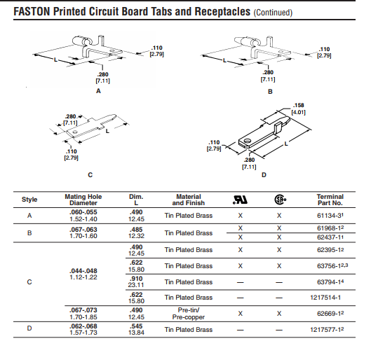

You don't say how many you need but it greatly reduces your options if you only want a few obsolete metal pressings. The original pin may be a discontinued Vero Technologies part, 1,3mm square. Round types in this size are still available at RS. An important feature of the originals is the barbed retention crimps on the shaft where it is pressed into the board - a once only insertion, I would think. Perhaps Naim service agents there are friendly and you may be able to pull some from a scrap PCB but there will probably be damage that way.
Male spade connectors are available in single pin types that would go close to fitting the same hole, but without the special crimp, you'll need to bend the the tang on the copper side to prevent it being pulled out of the board. You then fit the matching width female terminals to the existing wire leads. see examples C below.
They come under a few titles and it's worth searching Blade connectors and Fast-ons as well.

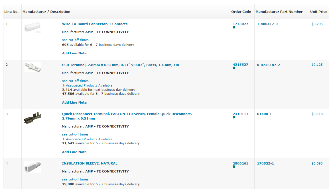

Thanks Ian. Again, you're spot on with your information - Fast-on was exactly what I was looking for.
For reference, I've attached the order list from E14. I got some solid housings as well as some of the PVC ones.

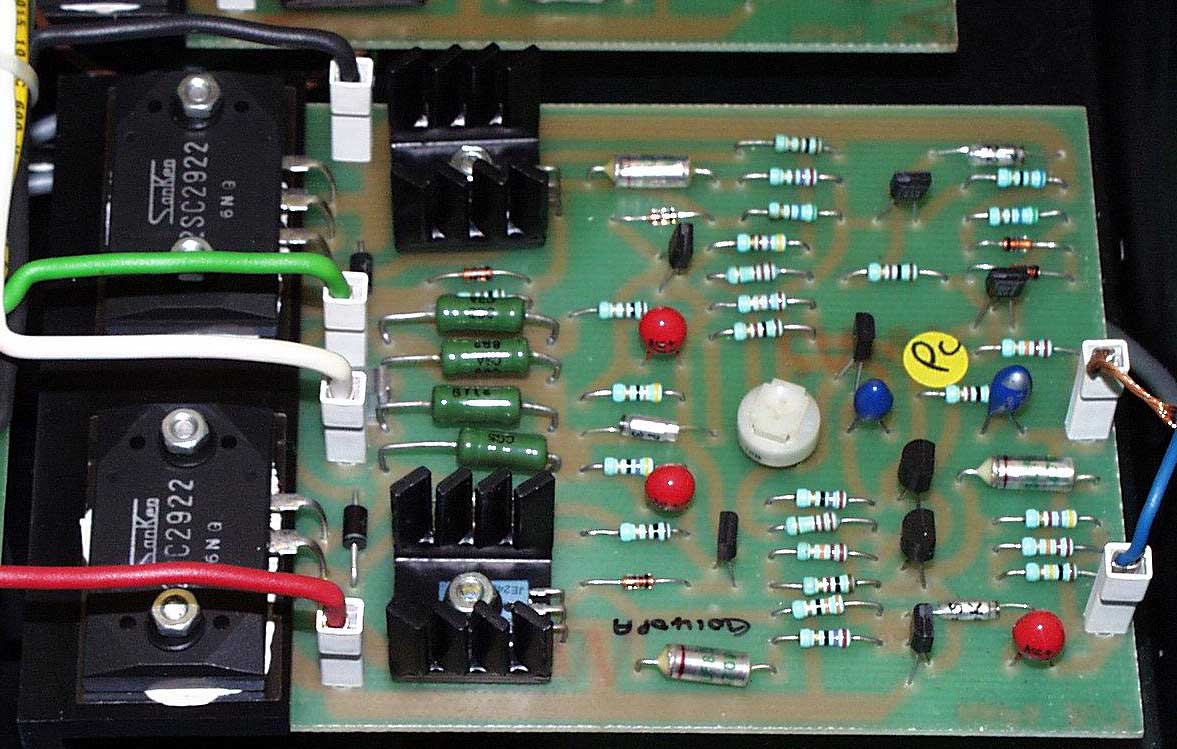

I've got zerozone nap140 clone boards. I tried everyting but cannot succeed about bias.
drivers are mje15030&31.. Vas stage uses ztx653&753. Outputs are 2sc2922.
Feeding the boards with +/-33v.
Bias pot is 2k. I'm measuring bias across the resistor. But pot does no effect at all. I removed outputs last night and checked drivers base to base voltage.. Its zero..
I checked every component.Couldnt find anything yet. Transistor next to bias pot is bc550- i couldnt find ztx384..
What am I missing. Any idea?
Thanks..
That's not right. The bias pot voltage should not get much above 3V. IOW the voltage between the bases of the output drivers should not be much above 2.4V when adjusted properly. Check the parts around the pot for value and good connection and that the transistors and diodes are the right way around.
I used 1n4148 diodes. All of them checks ok and direction is alright.
Is it ok to use bc550 in that position?
Not exactly. The pin-out of the BC550 is different to the ZTX. The terminals are the opposite when looking at the flat side of the transistor. So you would need to put the BC in the other way around.
Looking at flat side of ZTX the pins are E-B-C.
Looking at the flat side of BC550 the pins are C-B-E.
