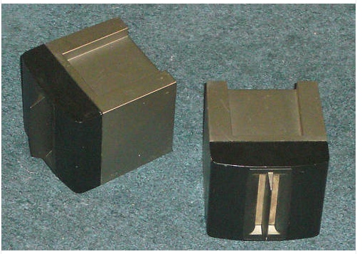

You can solve the beaming of your tweeter by simpy instaling a vertical piece of paper or somehing, say as long as the tweeter and protruding some cm´s out. That trick was used for example on the very expensive Technics T1000 ribbon of yesterjor. In that case it was a little bit shaped to avoid discontiniuties.
You can also do this by limiting the horizontal sd -i.e. blocking/taping off several vertical rows of the Neo 3 (to the extreme right and left). I think Burmester does this in one of their designs. This one:
Burmester Audiosysteme GmbH ::: Products
http://hifi-regensburg.de/upload/CY62ab4e0aX125bd26d061XY4324/1261604468506/B_80.jpg
That's what the Neo3 PDR is. There are strips of felt/foam in the outer slits which improves top end dispersion compared to the non-PDR version. There are photos somewhere on this forum that show this. I'm assuming the felt is chosen so the lower frequencies go through, thus the radiating area narrows as you go into the top of the tweeter range.You can also do this by limiting the horizontal sd -i.e. blocking/taping off several vertical rows of the Neo 3 (to the extreme right and left).
I played around with both the Neo 3 and Neo 3 PDR. I even looked at using two Neo 3 back to back (with back cups) so I could control the separation. The problems are at both low and high frequency. At high frequency there is some beaming (or lobing) of the response which is typical of a planar radiator. Blocking off some of the radiating area would help this but also reduces sensitivity. The other problem is that at lower frequencies the tweeter is not particularly directional. This places a dip in the response around 6k Hz, with the dipole peak around 3k, as shown here with a naked Neo3 PDR in blue. The wave guide controls the directivity and the dip is eliminated, as shown in red:
The problem with the naked Neo 3 is that as you move off axis the dipole moment gets shorter and pushes the peak higher. This make the response bloom relative to the on axis response as shown here in the "waterfall" of the polar response, normalized by the on axis response:
The trade off is that at higher frequency tweeter also becomes a little more directional. I imagine that with more work and testing a more optimum WG could be designed, but I am pretty happy with the behavior of the polar response out to 10K plus, combined with the smoothness of the on axis response that the wave guide provides.
