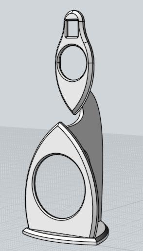

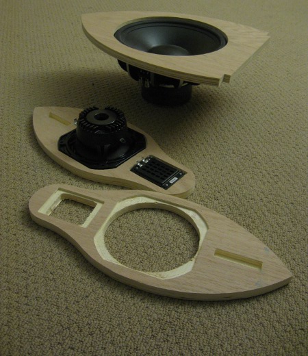

Somewhat following in John's footsteps:
That was an idea I'd sketched out many months ago, but it's way beyond my construction skills. A friend recently set up a CNC machine, so we've started cutting out some pieces:
I hope to have something to measure in a few days.

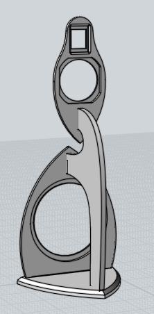

Saurav,
If my experience is any guide, I suspect you will have problems with the Neo 3 mounted like that.
Saurav,
Thanks for the heads-up. I haven't measured these yet, and it was mostly an attempt to improve the aesthetics of a nude Neo3. What exactly would you suggest changing? Narrow the baffle around the driver? Add more 'waveguide' depth on the back? Reduce the 'waveguide' depth in front?If my experience is any guide, I suspect you will have problems with the Neo 3 mounted like that.
I would suggest making the WG symmetric front and rear. I could not get a good on axis/polar response without doing that.
Thanks. I suspect I'll be going through a few iterations before I settle on a build. And in theory I should be able to swap out the top baffle without having to re-build everything.

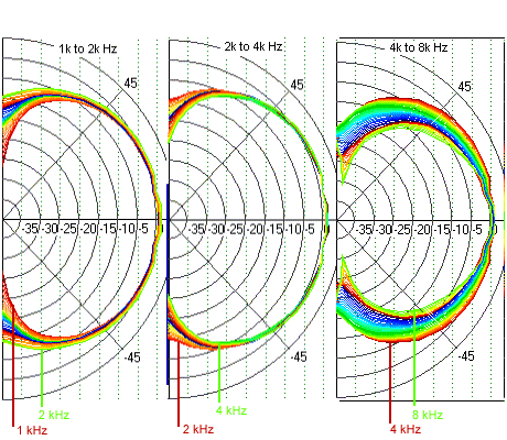

I have posted more data on the NaO Note at my web site .
John,
after thinking some time over your polars I can understand why Earl does not like that kind of presentation. Laying one curve on top of another and doing that for approx. two dozen curves can give an impression of harmonious continuity where not much harmony exists.
I am not sure where the frequencies start and end in your diagrams. Are my indications right?
If I am right, I see two areas where I would be interested to know more about your design considerations:
The Scan Speak Discovery develops a tendency to weaken the dipole null at 90° just from the start, peaking at 2 kHz with almost 15 dB "gain" at 90° off axis and recovering 10 dB "loss" from there to 4 kHz. From that I suspect that a 60° to 120° comparison for the SS would be much less impressive than the comparison of on-axis and rear response, that you are showing. How important (or not) would you consider a constantly deep 90° null?
Your 4-8 kHz diagram shows that lobing already starts at 7-8 kHz. It is preceded by continuous beaming from 4 kHz up and another weakening of the dipole null at 90°. Your 9-10 kHz diagram is not the last example of a non-lobing-frequency IMHO, but the last nice-looking curve between 7 and 16 kHz.
My own experiments gave me the impression that designing for a smooth 30° response (and forgetting about 0°) results in less lobing above 8 kHz than what you achieved. But that would need a naked Neo 3, forbidding anything like a baffle or WG around the driver. Did you consider to design for anything else than 0°?
Rudolf
Rudolf
