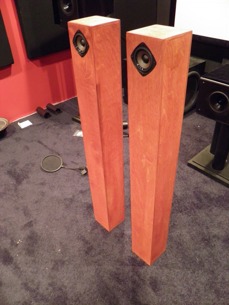

Without ever googling the TB W3-881SI, I bought 8 of them with a weird fantasy line array idea in my head. And a couple of buyout Nuance TW5-073LR tweeters in case there wasn't enough high end for my poor old decrepit ears. Then I found this thread...
Since I have lots of plywood in the garage and 8 speakers, I could make a pair (or two) to try tomorrow after work.
One question for Skeeter99: did you put two drives in the same size enclosure that cogitech did to start this thread? I like the two driver idea because it might extrapolate in to the 4 driver idea that I originally had.

I built some small closed box cabinets that would fit inside some 1925 cathedral speaker cabinets that I obtained, and after much research I used the $10 Peerless/Vifa TC9FD-18-08 paper cone 3 inch driver (Madisound or Parts Express has them). Not much bass, but amazing sound above 100HZ. Since I have tone controls, I've gotten back enough bass to be happy.
In a tower like you built, I would seriously consider using these (Xmax = 2.5mm) and instead of a port I might try a passive radiator near the bottom of the cabinet (near the floor). I have no idea of the proper way to design with Passive radiators, and I didn't want to like them since you'd think they would ring, thereby muddying up the bass, but when I used a regular woofer with a resistor across the coil, acting as a passive radiator (no feed from the amplifier), it sounded VERY good. The cabinet was able to stay small, and the bass was fantastic sounding. Since the mechanical damping in a ported design is very poor on either side of the tuned frequency, the ported approach may be more likely to have a ringing problem than even a regular passive radiator with out the electronic damping. The resistor (1-8 ohms) damps the "passive radiator" driver pretty well. Varying the resistor size may actually tune its function.
The thing about ultra cheap "buy-out" drivers is that they are often not very good. Most that I've seen have the foam suspension which deteriorates badly in about 10 years, or a meager Xmax, no shorting ring on the pole piece, or etc. For $10-$22 you can get very good drivers from Peerless and others. When you look at the total cost of the project and what your time may be worth, the extra $10 is a pretty small percentage. You'll be stuck with whatever you build for years maybe.
Roger Russel, former head of acoustic research at McIntosh ('68 - '92) is using the 3 inch Peerless TG9FD10-08 glass fiber cone version of the one I mentioned above. The cone material appears to be the only difference. At $22 each, they have a VERY good looking published frequency response graph, well ventilated spider, shorting ring on the pole piece (doesn't actually have to be copper to work - I think they use aluminum), and are arguably the best wideband driver out there for the 100HZ - 15kHZ range. The Dayton drivers with the extra large Xmax have such bulky surround suspension that they have "cavity effect" and it shows on their frequency response graph. The Peerless drivers do way better on that and off-axis response.
When it comes to measurements (pink noise and calibrated mic or equiv.), know that the room acoustics will usually cause +/- 10dB variations by the time you are in the listening position. So don't worry about 2 and 3 dB variations too much.

It has been quite some time since I visited this old thread.
I must say how happy I am to have inspired so many to try these drivers. The variations on my design are awesome! Great work, everyone! 🙂

I've been living with the $12 black paper cone versions of these for a while now, and they amaze me at how good they sound run wideband driven by my computer and a 60 watt 3886 poweramp I built. The glass fiber cone versions ($22ea.) are in my stereo holographic soundbar cabinet. I'm still building the processor electronics and poweramps for that so I haven't really heard them yet. Those will only be asked to do 150HZ - 7kHZ, and I expect them to be quite good at that.

For cheap bedroom system I built, they are perfect. In Curnu I think the bass might surprise the crap out of you, and the high end is hot enough to balance, I would guess...

You are preaching to the choir, the Vifa(Peerless) TC9FD is my favorite driver. It sounds amazing, and at $12, you can make lots of speakers 🙂 My favorite speaker cabinet for this Vifa is the Cornu spiral. Sounds like a much bigger driver and has great bass, mids, and fantastic highs.
I used 4x of these drivers in a small sealed enclosure for a travel-sized karaoke box for a friend once. They sounded really good for the price and size of enclosure... I ended up order 4x more, just as a future project.
Fast forward nearly a year later, I saw them sitting on the shelf. Xmas was around the corner. Needed to do something with them... decided to build my Father some speakers for his small home. Needed something with a micro footprint, in a tower, that could give good sound. A bit of searching led me to these "nanoTowers". So... I build them! Well, almost the same... I used 9mm birch ply and did 5.25" x 5.25" x 45.5". Used the same port size/length of 1.5" diameter by 2.5" long. Used a bit of polyfill in each.
After hooking them up to the cheap T-amp Dayton audio makes and playing a variety of music through them... I can't say they are the best speakers I have ever heard... but they sure take the crown for the 3" and the $8/speaker category! The very top end wasn't all that brilliant, the midrange was very hypnotic, and the low end was... well, it was there! Which was pretty mind blowing. I played some Rap for a friend (his favorite genre), and he just shook his head. The low end was well placed in music!
I played Jazz, Electronic, Rap, Metal, 60's, 70's, Rock, Pop, Soundtrack... I gave them a good variety. As a metal-head, I can't say I could listen to these all day with some of the heavier stuff I like. Simply, didn't have the punch to keep up with the midrange heavy guitars and the top end of the cymbals weren't cutting through, though I'd still take these over any TV speaker for the same purpose! I found Jazz, Rock, Pop, and Rap to really shine on these, for whatever reason. I think Rap, simply because the dedicated low-end it offered just really showed the potential of these, where the midrange capabilites shined well onto the other few genres. Course, this is just my opinion on it.

Amazing feedback! I never would have imagined that my nanoTower would turn out to be such a success not just for me but for others. I really appreciate you taking the time to share your build story and listening notes.
Did you play with adjusting the damping at all? I found that optimal bass response was only achieved after adding far more damping than I had anticipated....
