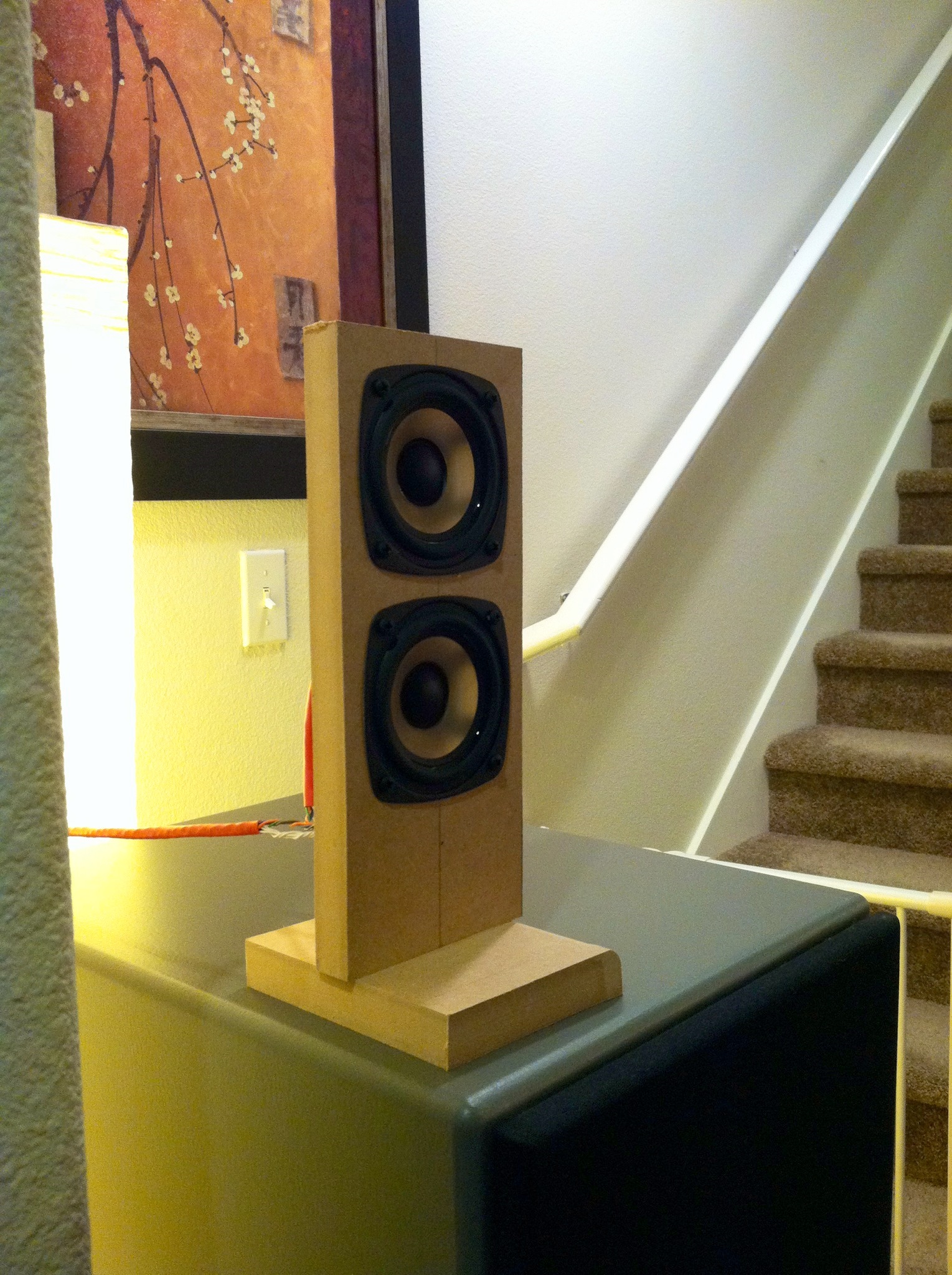

I'm not sure. I guess that all depends on what your SPL goals are. I can turn this amp to about 2 o'clock, with the bass knob at roughly 2 o'clock. Much beyond that and I'd be pushing the driver excursion farther than I am comfortable with. On top of that, these little amps will tend to start to clip well before they reach their rated output (which is 20 w/chan. into 4 ohms or 12 w/chan. into 8 ohms). Distortion increases dramatically at high/max output as well. It is really probably better to think of them as a 4 or 5 watt (into 8 ohms) amplifier. In the video, I am probably pushing less than a watt through the drivers, perhaps a bit more, and that is much louder that I plan to run the system on a regular basis. For TV/movies and easy listening music, I might have the volume knob between 9 and 10 o'clock.
With the efficiency advantage of running multiple drivers, and a scenario were you don't need ear-bleeding SPL, it might be enough amplification for a main system. There are just too many factors and I am too inexperienced to say much more on it...

Just ordered two pairs of these little guys. Haven't decided if I'm going to build a single tower, a tower with two with the top woofer "capped" or a tower and a bookshelf ... oh the possibilities!!

Yeah I'm really leaning towards two and doing this "cap trick" that Danny discusses over at AC: Best Sounding Single Drivers
Now time to model and find a suitable tower to do it all with 😀
Oh so its like a low order crossover to reduce hf comb filtering? Looks like a good idea. Most of the needed support is on the low end...

Exactly. I will have to look at the Needle, I don't know if it was ever modeled for this driver or if something would need to change or not 😕

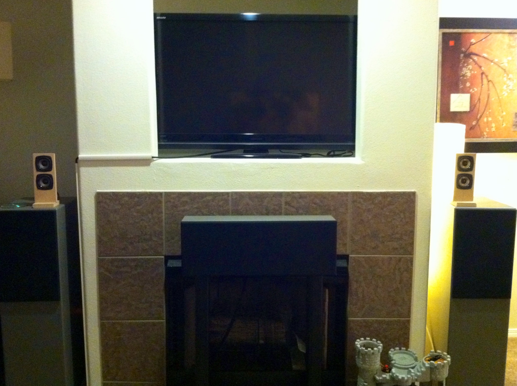

Just got my drivers and built some VERY crude OB "housings" for them to get them broken in. I've got them wired in parallel for a 4ohm load and my Onkyo isn't having any issues with it. There's obviously no bass and they've only been breaking in for about 20 minutes but they're already imaging pretty well. I'm planning on building simple BR towers like what the OP built except I'm going to have one driver facing upwards and one forward and use them as surrounds in my all FR HT. If they don't work well I can easily build another enclosure for them. Think it'll be a fun project. When I start construction of the cabinets themselves I'll start my own thread so as not to high jack this one.
