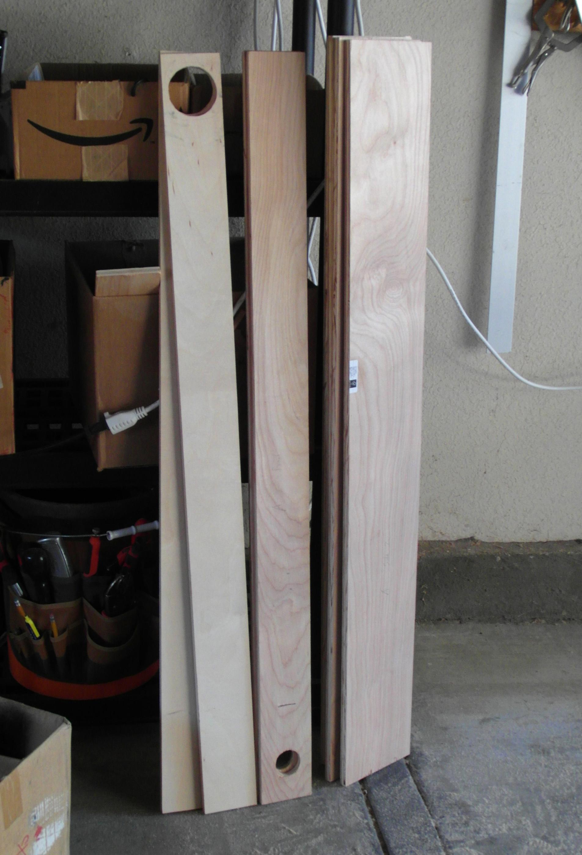

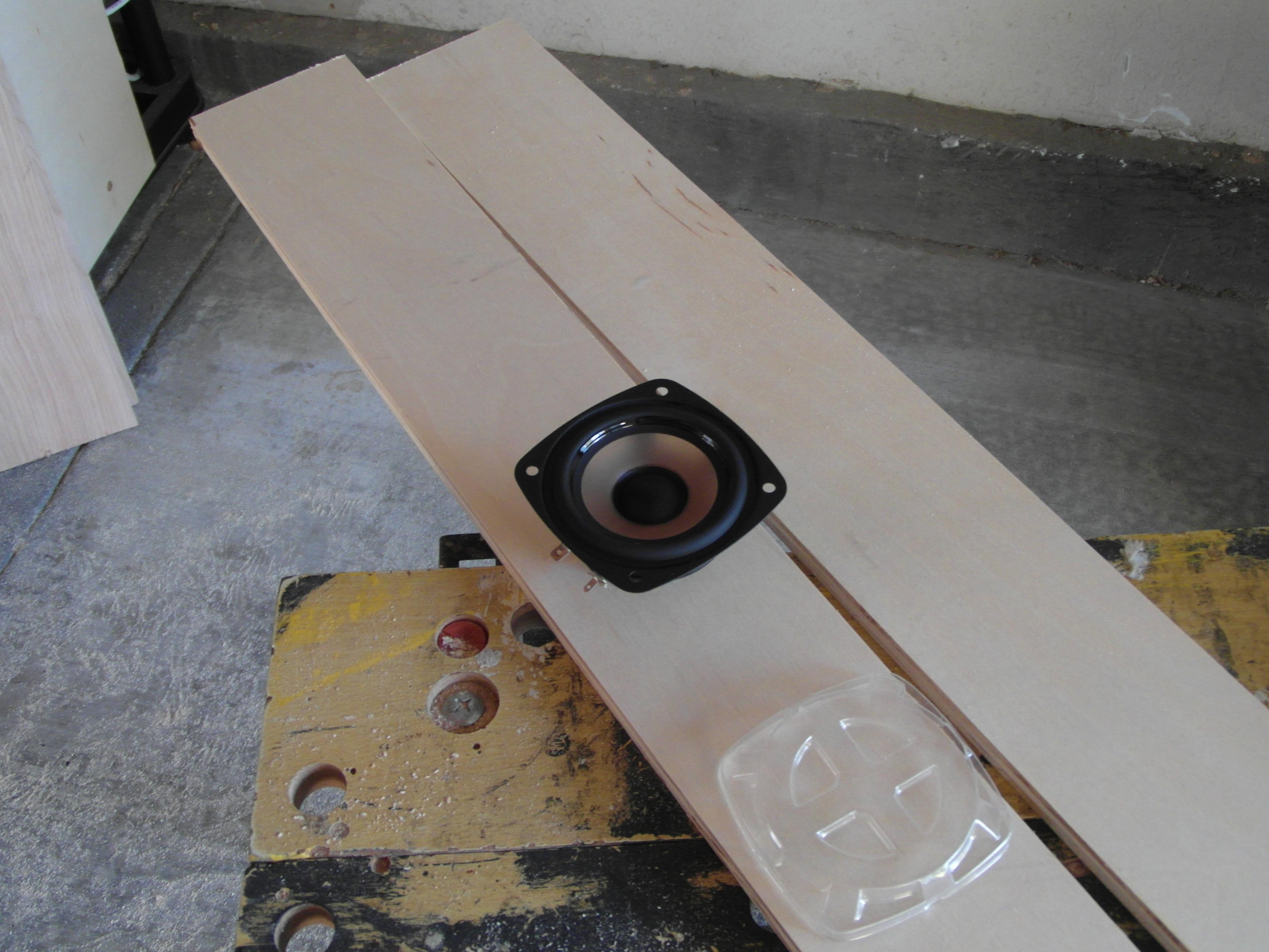

thanks, Brian, I started to make the nanotowers today, tomorrow edge banding the plywood and sanding and staining... I have some carpet foam padding, u lined them all 4 walls (front and back little less?). Most likely I will glue the cabinet, so I want to get this right first time...
gychang
gychang
Hi, gychang,
On the front, I ended the padding an inch or two under the driver. On the back, I ended about the same distance above the port.
Your cabinets look very good! Good luck in the assembly. I think you will be very pleasantly surprised by the sound these speakers produce.
