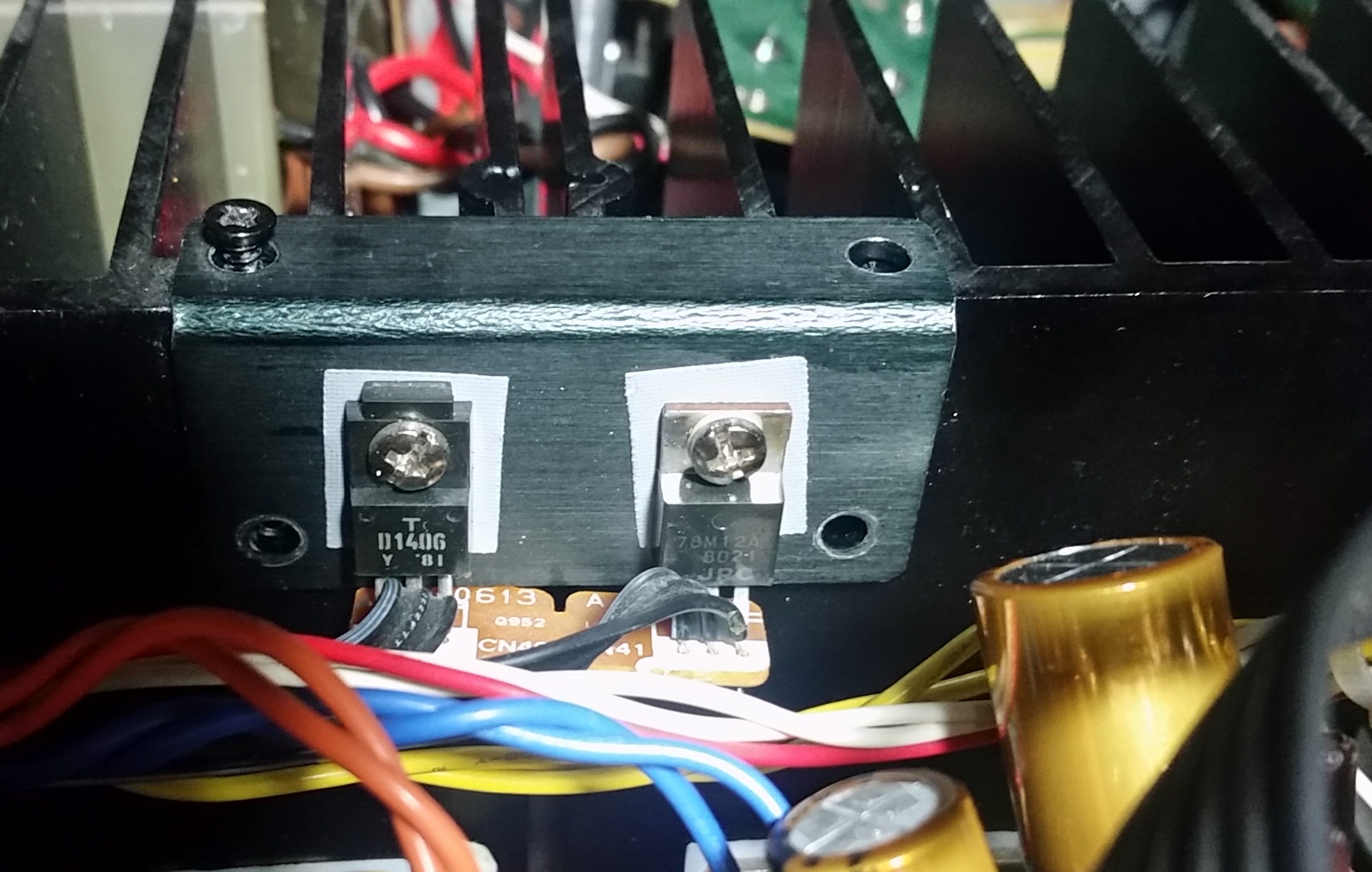

What about these transistors on radiators.. are they identical on your amp?
Oh dear 🙁 New ones needed, and there should be plenty of generics that will fit the bill.

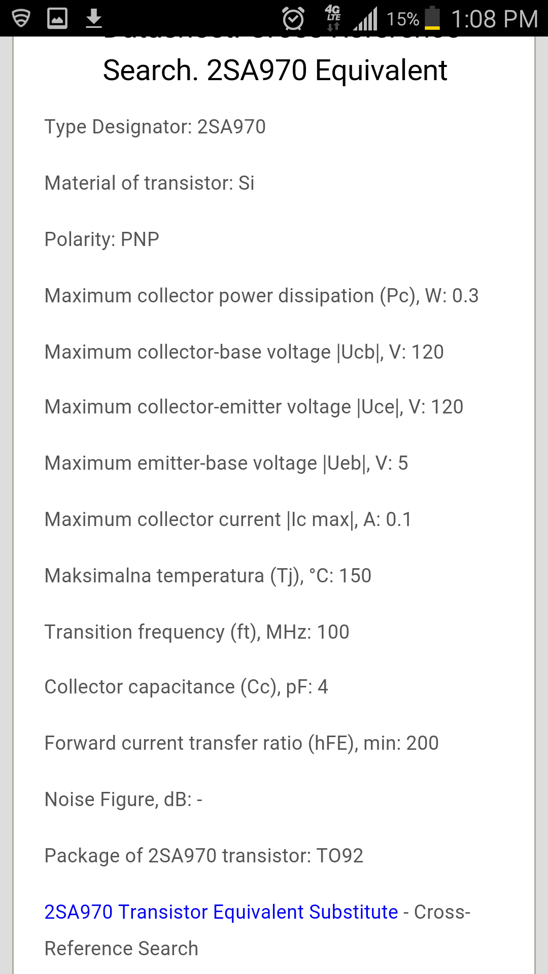

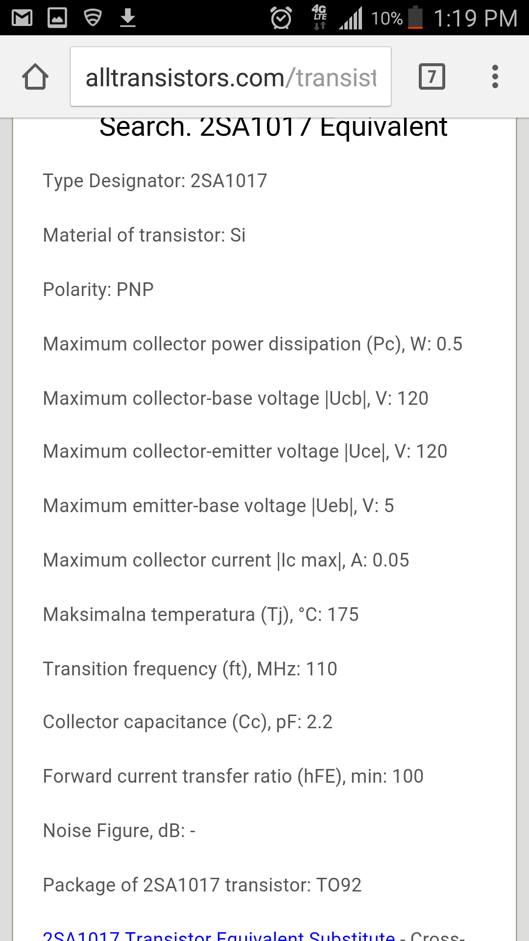

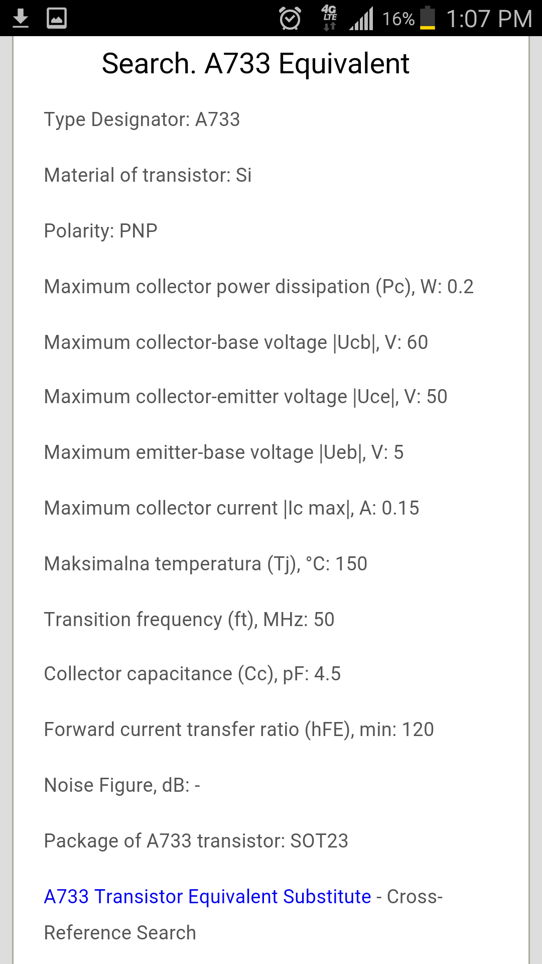

What about a1017.
Specs side by side. They seem to have same equivalent t092. But people said t092 is not the best substitute for a970
Only thing a1017 has very low ic max. Collector current .05 instead of .1

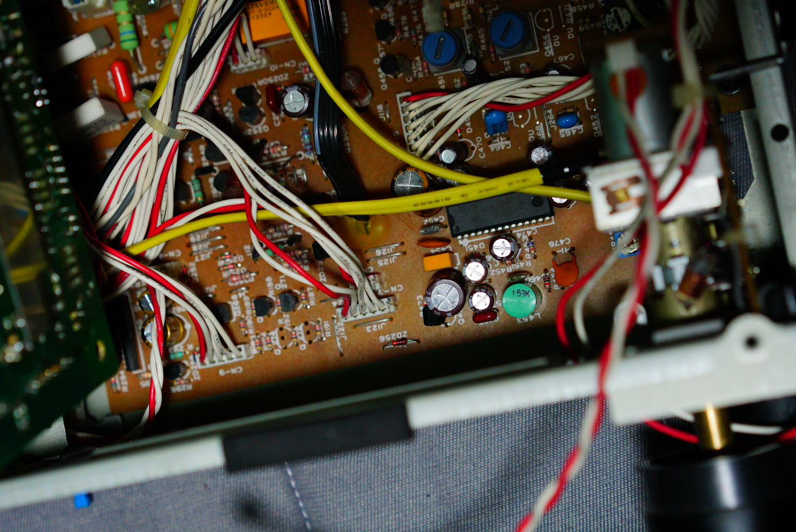

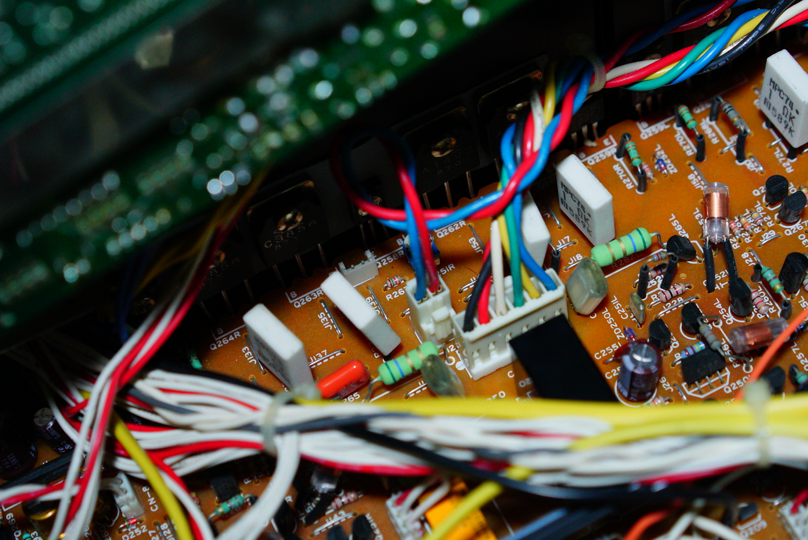

Unsoldered q272 q274. Same behavior. Left channel a little quieter..I'll take few pics of the board. But don't see anything obvious.. like some one worked on it before.
Maim board relay stil clicks when switching between options

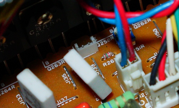

Only thing there is a pair of 2 pin jumpers That don't have anything attached to them. .what are these for?
Here is a pic of one. It's white housing and 2 pins. There are 2 of them. One on each channel. Right by output transistors of left and right channels. Can be seen without removing much
Those could be test points for setting bias current... highly likely given their location.
