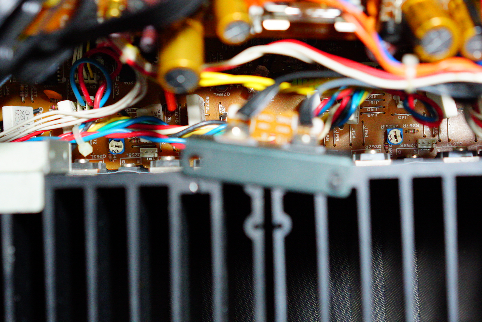

Could not find instructions on how to adjust bias on solid state. Nakamchi in particular. Internet is trashed with guitar amp bias adjustment.
I think those 2 blue white variable resistors is what needs to be adjusted. They seem way too off of each other.. usually these pots are in more or less similar position.

One thing I noticed.. right channel runs much hotter than left.
I followed bias adjustment procedure. Left amp at min volume, speakers off position for 10 min.
Adjusted bias to 27.5mV. Botherwise channels
After playing music for 15min I noticed right channel is much hotter. Heat sinks are very hot.
Set speakers to off. Disconnected everything, volume at minimum
Now right channel bias is 50-55mV
Left channel 22mV.
After 3-4 min of idle biases come back to 27.5mv.
I am thinking those variable resistors don't hold resistance well. I have read some people use regularge resistors of set value.
Also dc offset is 43mv on right channel
10mv on left channel.

This 'floating woofer' issue looks odd. For the woofer to move like that suggests that there is a shift in the DC conditions as the amp pumps current into the speakers.
I would attack that issue with a scope and look at the input signal to the power amp (to see if the shift is appearing there) and also to look at all the rails under load. There are no servos, no auxiliary rails to the power amp... so that is an add issue for sure.
Also, based on what has come to light in the last few hours it could well be another manmade fault.
